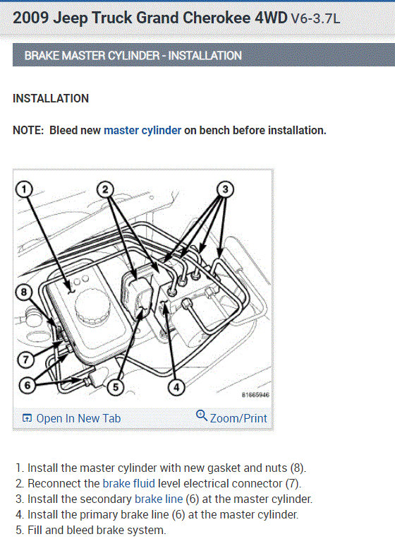

Hi, problem with brake pedal sinking with engine running solid with engine off. Have bled about a gallon of fluid with and without scanner clean fluid. no leaks, all hoses good. When driving vehicle stops perfect but if you put extra pressure on the pedal it sinks slowly. I have ordered a master cylinder just in case. I live in Ireland and this is the only Jeep Cherokee KK, and help from dealers does not exist only want to sell new. When i bled the vehicle it was done to factory spec manually as per instructions with scanner. Help. Thanks

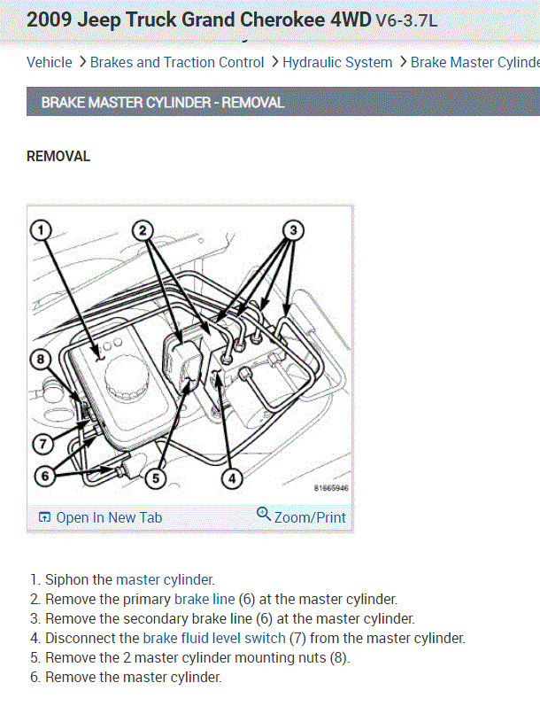

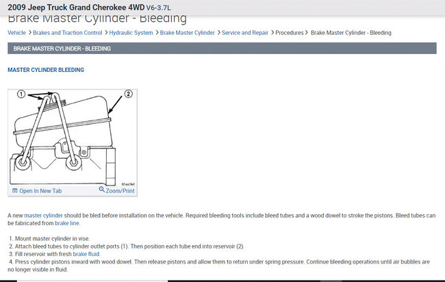

If the pedal slowly goes to the floor when holding pressure on it, chances are the internal plungers are bad and allowing fluid to bypass. Take a look through this link.
https://www.2carpros.com/articles/brake-pedal-goes-to-the-floor
If you determine it is the master cylinder, and it does sound like it, here is a link that shows in general how it's done:
https://www.2carpros.com/articles/how-to-replace-a-brake-master-cylinder
The attached pics are specific to this vehicle (not sure if you have a right or left-hand drive).
Let me know if there is something I can do to help. Also, there were no 4 cylinder engines offered in this vehicle, so let me know which engine you have.
See pic below.
