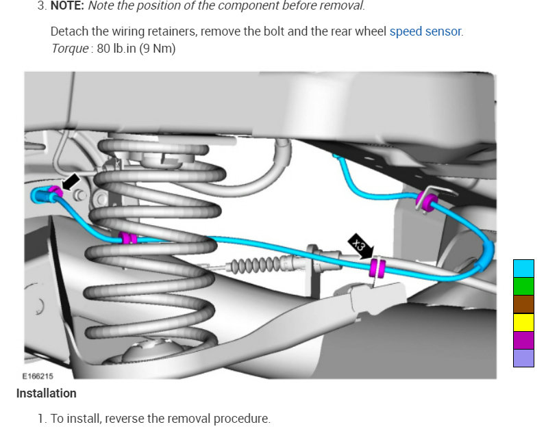

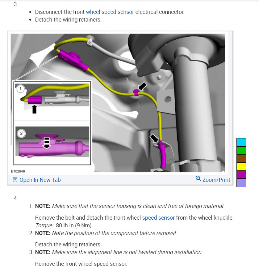

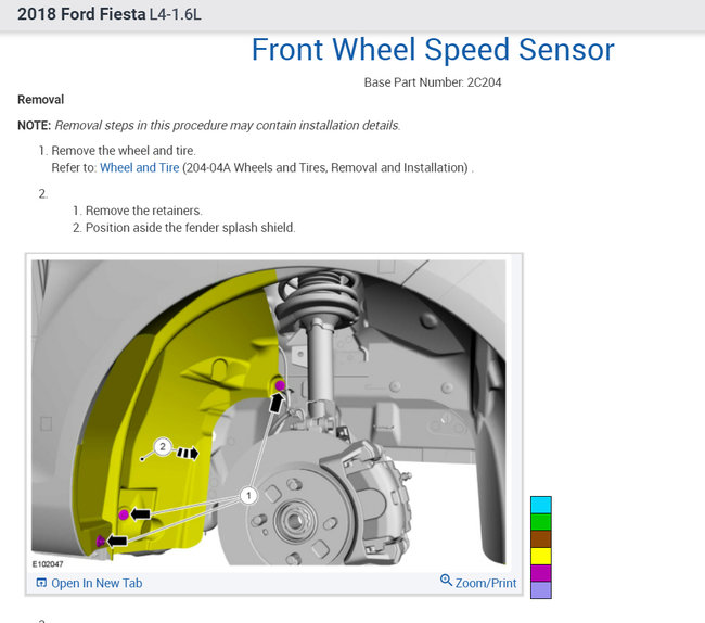

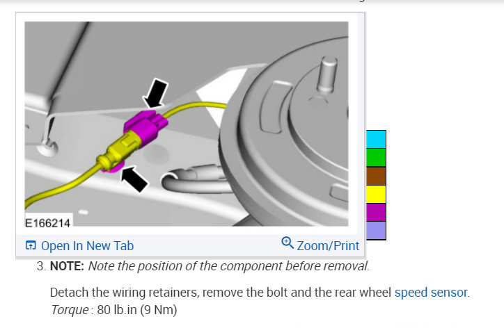

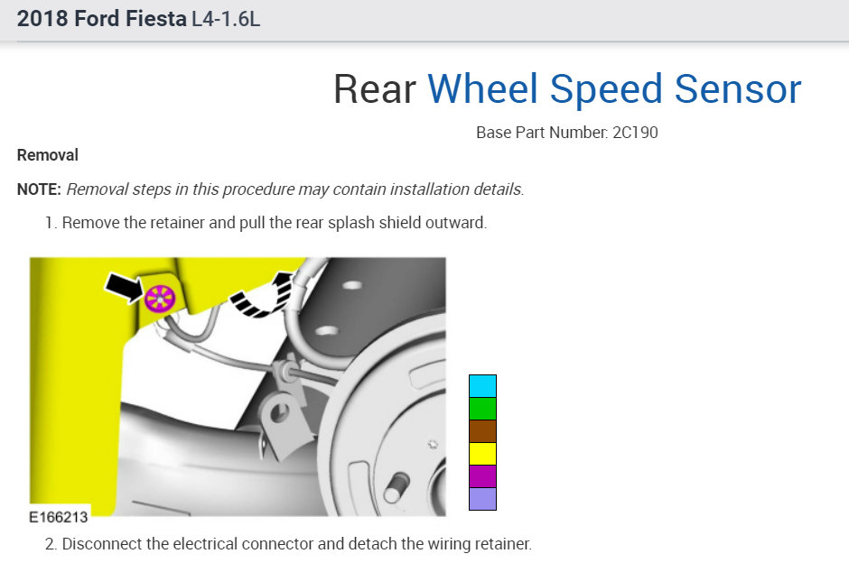

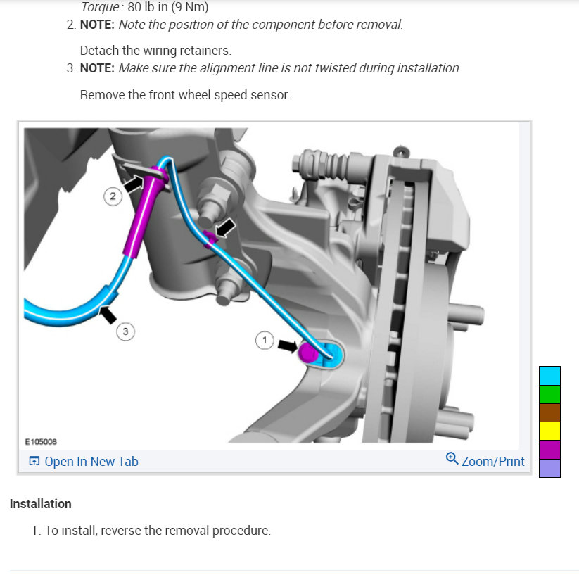

It sounds like you have an ABS wheel speed sensor that is out. To confirm, let's run a scan on the system to show us which sensor is not working. This video will show you how and I have included instructions in the diagrams below to show you how to replace the sensor. Check out this guide and video before you begin:
https://www.2carpros.com/articles/abs-warning-light-on-easy-repair-guide
