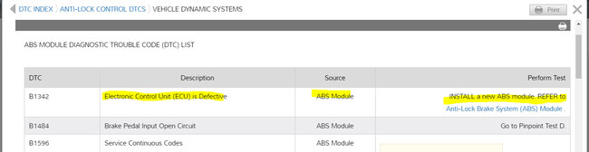

The codes are B1342 and B1569.
Sep 24, 2023 at 1:05 PM
  • 110,251 POSTS

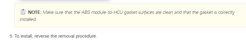

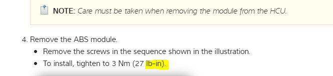

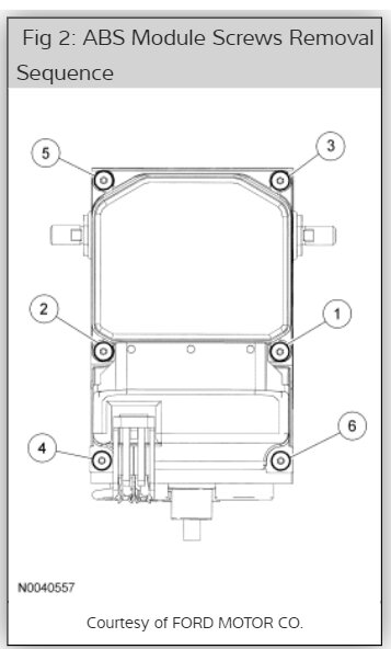

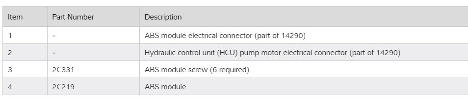

Based on what I'm seeing, the ABS module needs to be replaced. The B1569 isn't listed, but B15696 is. See pic one below. Note that it indicates the module needs to be replaced.
Is there a chance the numbers were transposed?

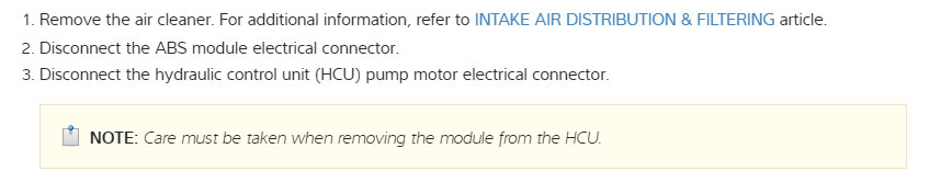

I attached the directions below for the replacement of the module. Let me know if this helps.

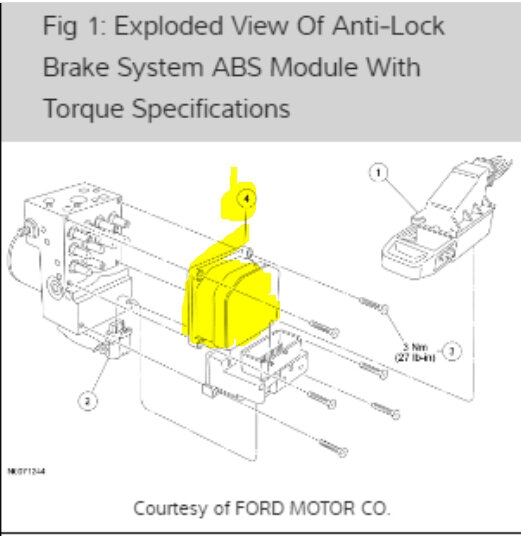

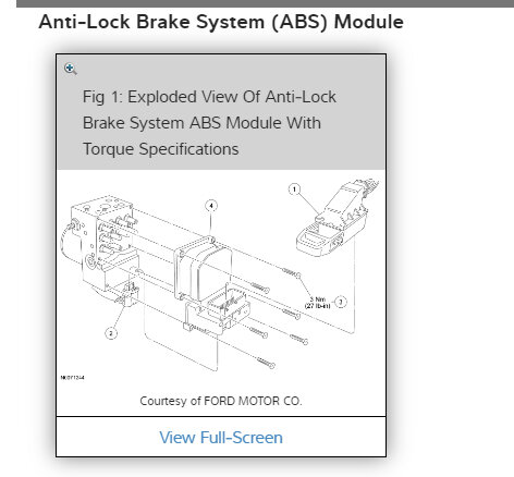

Thank you for your interest. I am confused in this case: Should he replace the ABS pump with the computer above it, or did he just replace the ABS computer only... as in the picture, pump No. 1 and computer No. 2. I hope you understand what I mean.
Sep 25, 2023 at 6:25 AM
  • 110,251 POSTS
The manual only indicates the ABS module. It is number 4 above in pic 2. I copied it and highlighted the component. It's attached below.
See pic below.
Sep 25, 2023 at 6:33 AM

I did as you instructed me, and everything was fine and the ABS light disappeared. Thank you for your cooperation.
