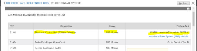

For your information, the vehicle is normal and there is nothing wrong with it, but I have these two signs: ABS and Brake. I do not know whether I should replace the ABS pump or whether I should replace the rear ABS speed sensor!! Please advise me.

The codes are B1342 and B1569.
Sep 24, 2023 at 1:05 PM
  • 110,244 POSTS

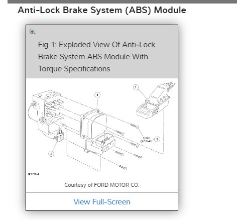

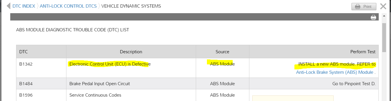

Based on what I'm seeing, the ABS module needs to be replaced. The B1569 isn't listed, but B15696 is. See pic one below. Note that it indicates the module needs to be replaced.
Is there a chance the numbers were transposed?

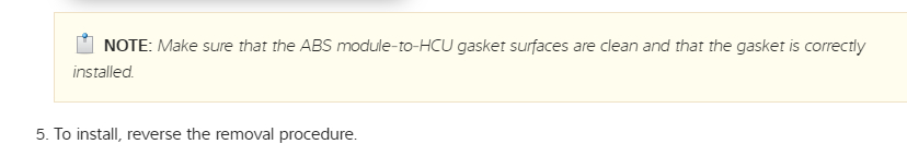

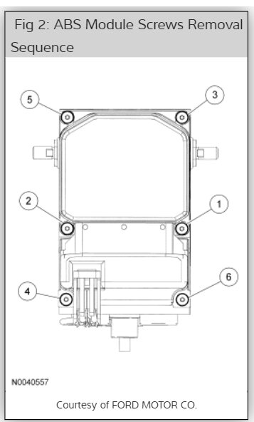

I attached the directions below for the replacement of the module. Let me know if this helps.
Sep 24, 2023 at 1:28 PM

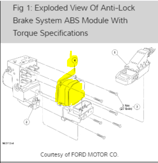

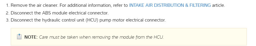

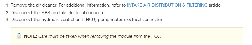

Thank you for your interest. I am confused in this case: Should he replace the ABS pump with the computer above it, or did he just replace the ABS computer only... as in the picture, pump No. 1 and computer No. 2. I hope you understand what I mean.
Sep 25, 2023 at 6:25 AM
  • 110,244 POSTS

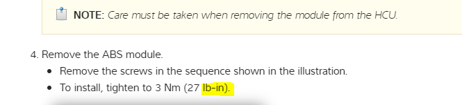

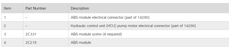

The manual only indicates the ABS module. It is number 4 above in pic 2. I copied it and highlighted the component. It's attached below.
See pic below.
Sep 25, 2023 at 6:33 AM
