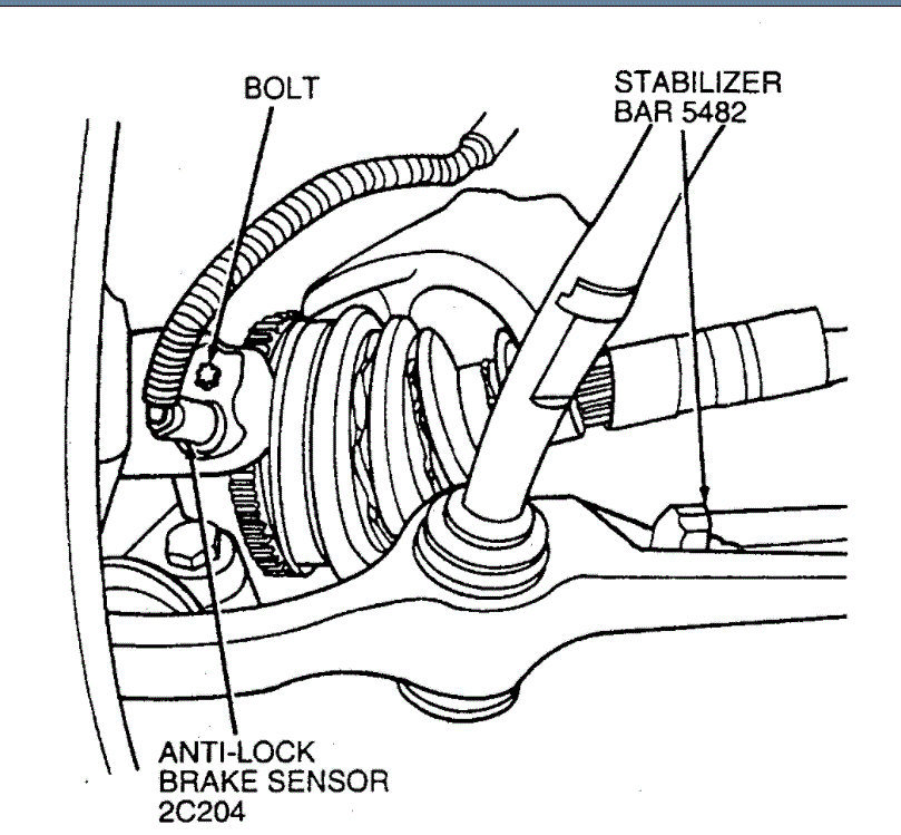

Also, I attached a pic below. Does this look like the design you have?

Yes, it looks like the pic. Part # Dorman 970015

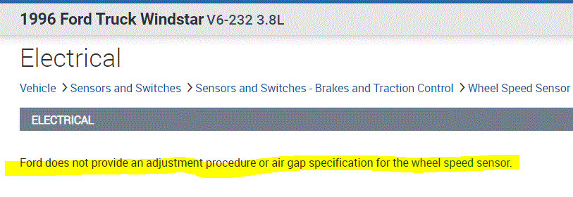

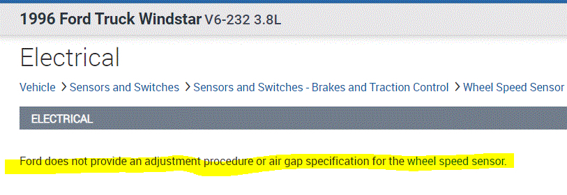

Now, some sensors can be adjusted when installed. However, this one isn't. IF you look at the attachment below, you'll see what I have in my manual. When no adjustment is provided, there isn't a procedure for adjustment.
One other question. Have you physically compared the old and new sensor lengths to see if they are the same?
See pic below.
