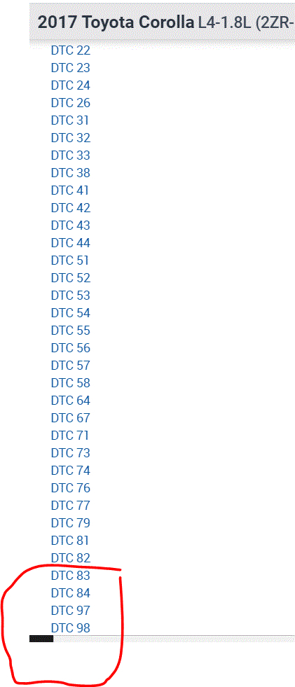

Good day.
I connect obd2. 4-13 port and counts the ABS light flash the code is 95 .
and the traction light flash as code 43
please i want to know the issue to fix it .
Thank you
Apr 9, 2020 at 6:22 AM
  • 110,244 POSTS

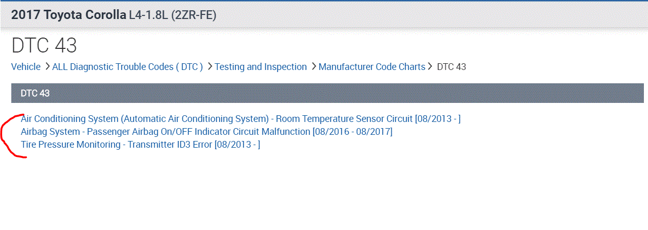

I looked up the codes you indicated. Code 43 doesn't indicate to be a traction control code, and code 95 doesn't show at all. Are you sure these are the codes? See pictures below.

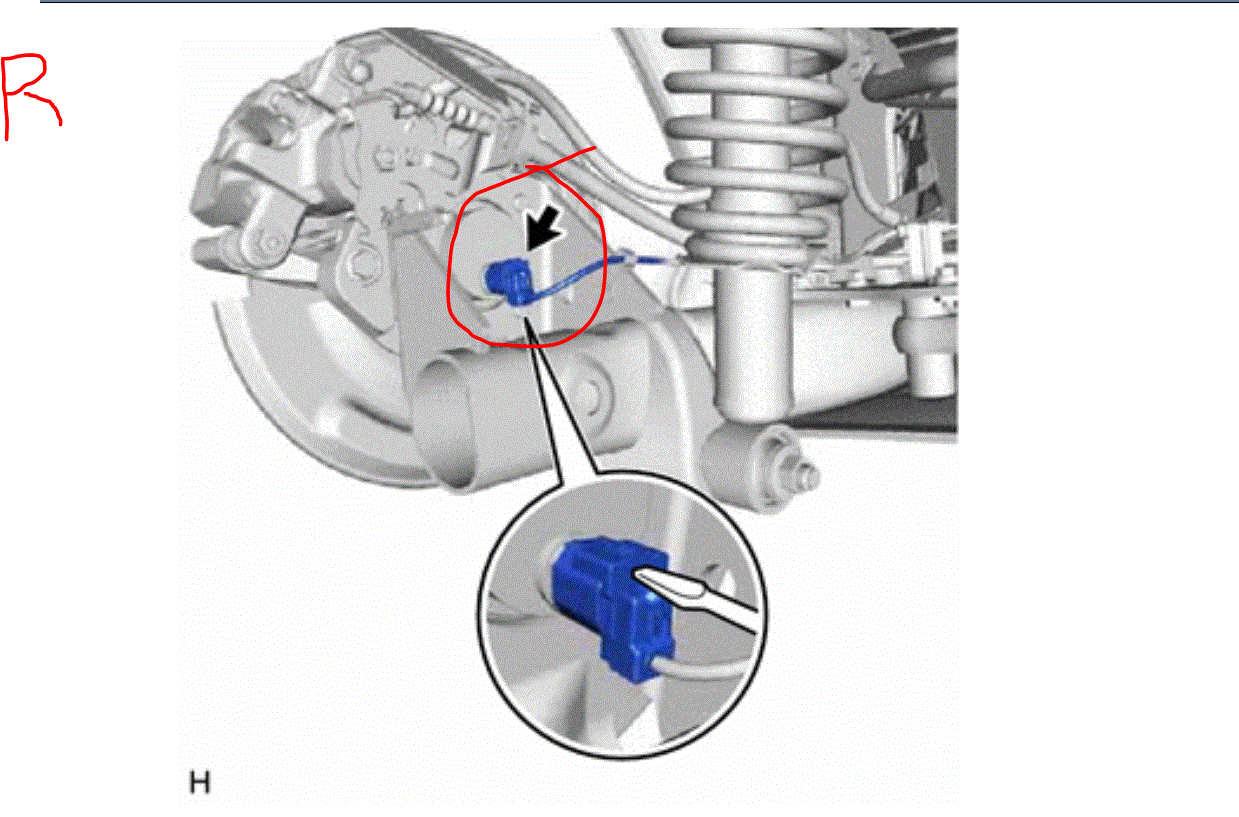

I can tell you that most tomes there is a traction control and abs light on at the same time, it is related to a wheel speed sensor. Do you have access to a live data scan tool? If so, you need to check for signals from each wheel speed sensor.
Now, if you don't have a scanner, you can check each speed sensor using a multi meter. Here is a link that shows how that is done:
https://www.2carpros.com/articles/abs-wheel-speed-sensor-test

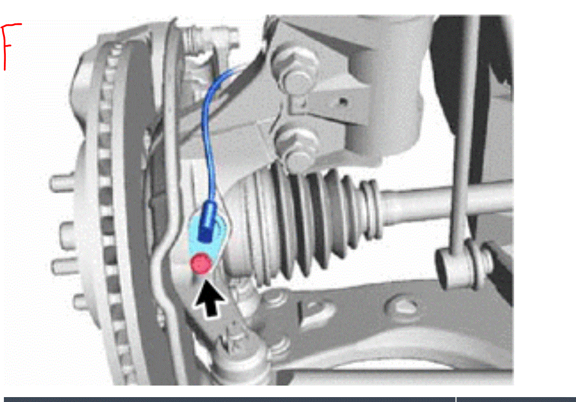

If you look at pics 3 and 4, they show the location of the speed sensors on your specific vehicle. There will be one at each wheel. I will tell you that if a rear sensor is bad, you will need to replace the hub bearing assembly. It is a sealed unit. The front is easier and only requires the sensor.
If you have questions, let me know. Also, if you are able to check these and find one is bad, let me know that as well. I'll help you through replacement.
