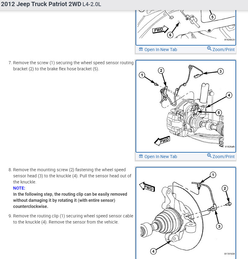

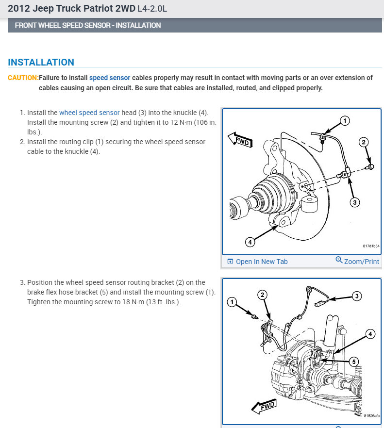

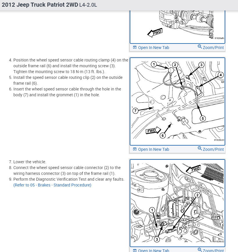

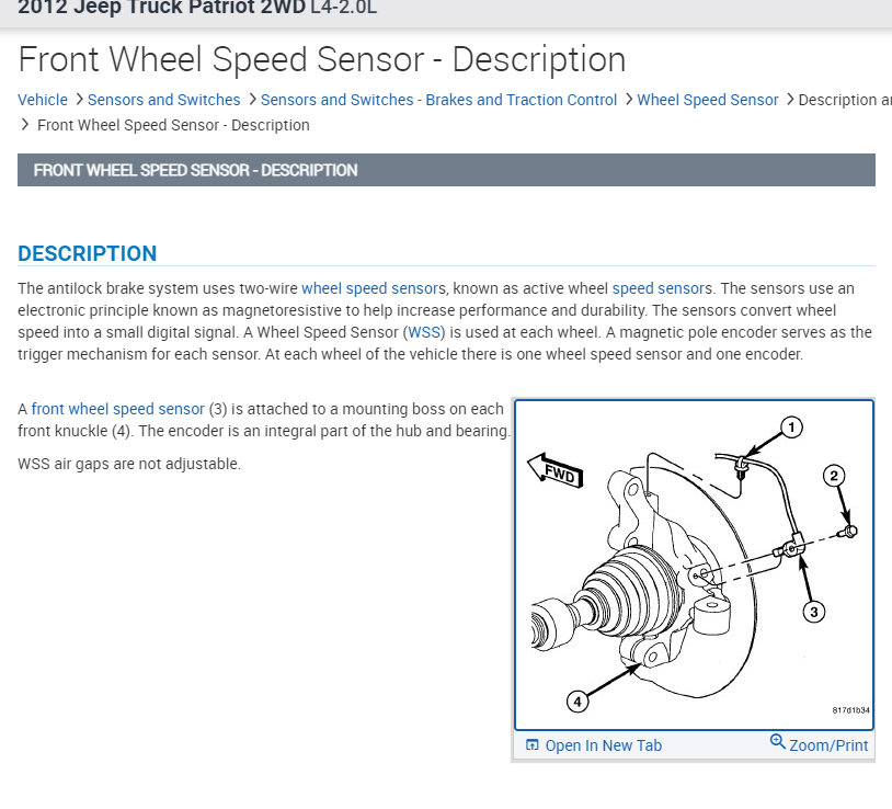

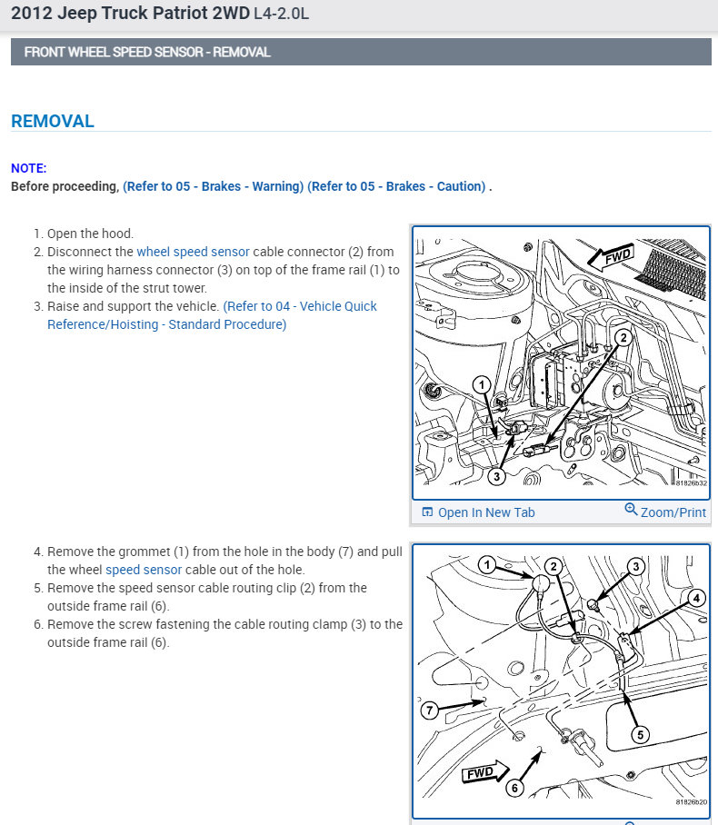

After someone replaced my tie rod, my ABS and traction control keeps flashing after 45 MPH. And if I turn left. It was unable to drive really after 45 MPH. I thought the wheel speed sensor got damaged, so it was replaced but that was not it.
