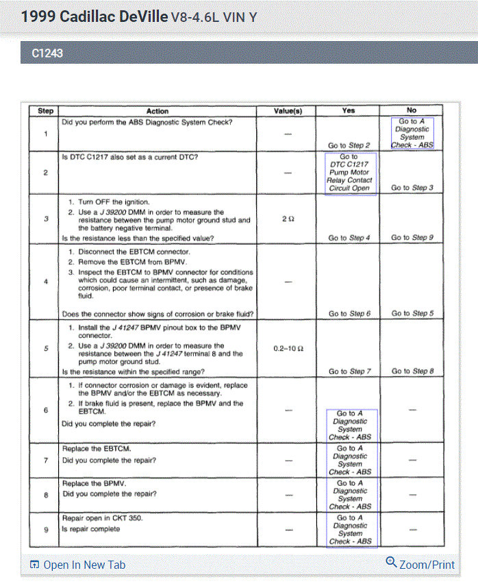

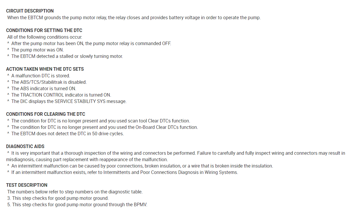

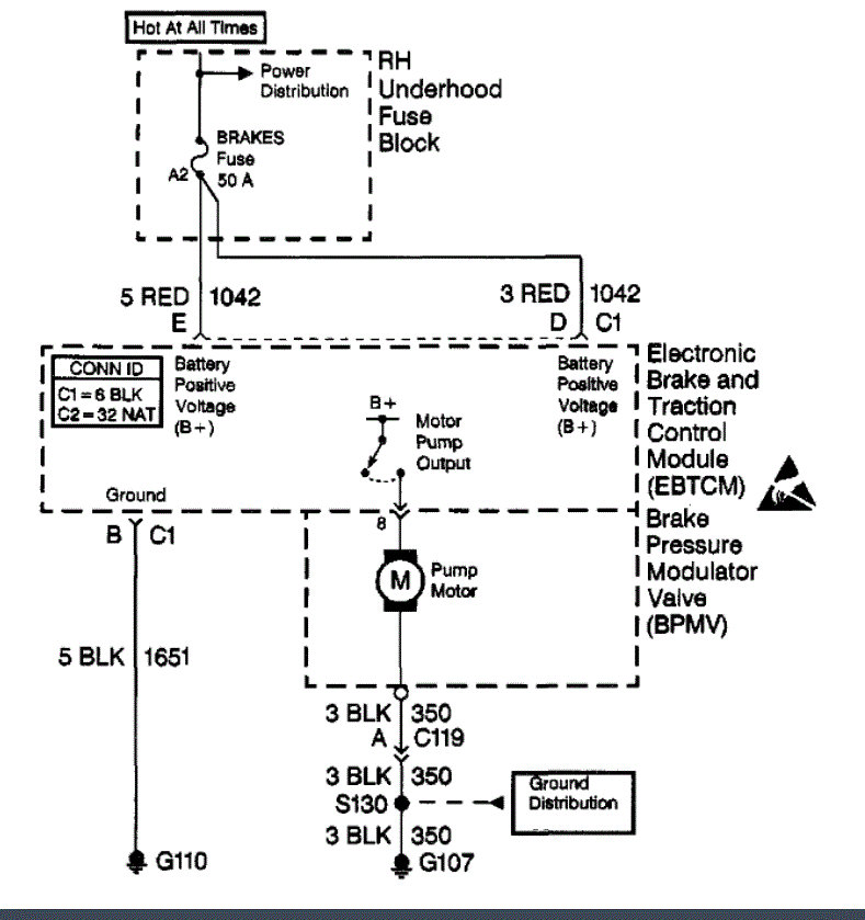

The code indicates a few different possibilities. Yes, it could be a wheel speed sensor that will set codes for the ABS and the traction control. However, there are other issues that are possible as well.
Take a look through the diagnostics below. They walk you through the procedure to check specific things for this code. Let me know if this is something you are comfortable doing.
Let me know what you find or if there is anything I can do to help.
