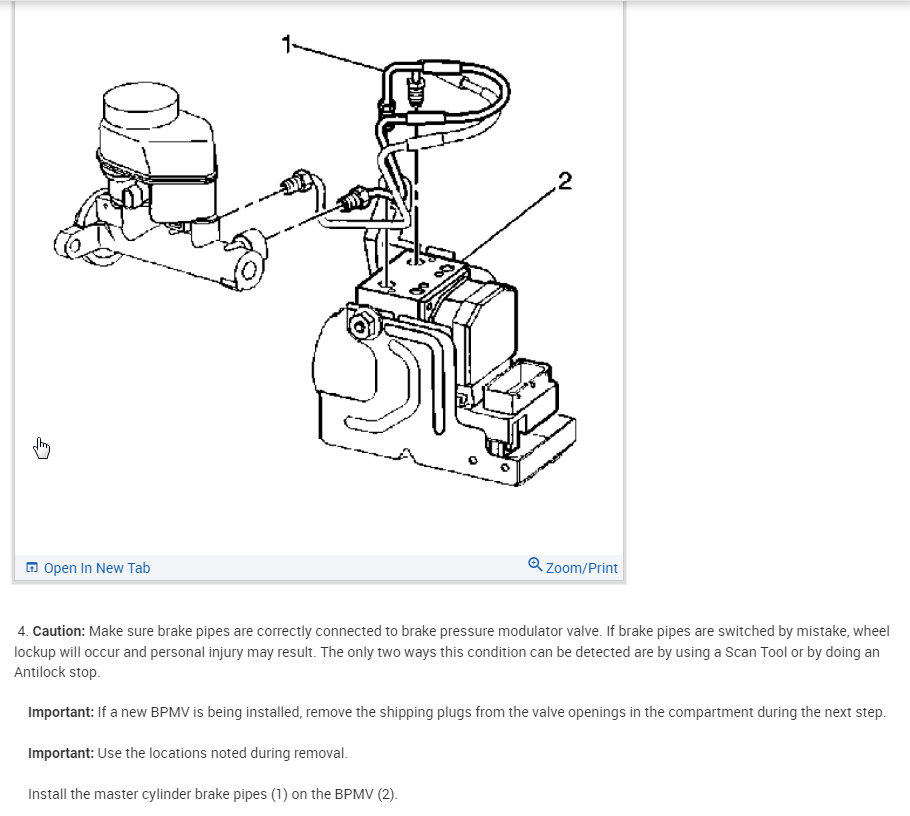

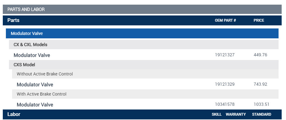

I believe i need an ABS control module with traction control. I can't seem to find the exact part i need. Can you help?
Nov 7, 2019 at 11:24 PM

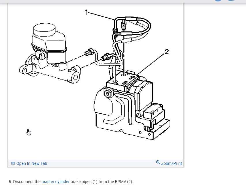

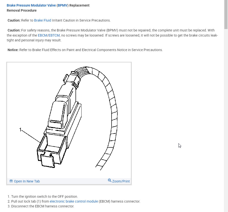

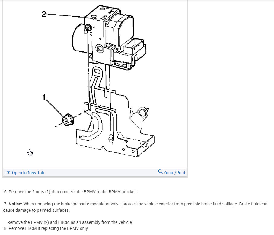

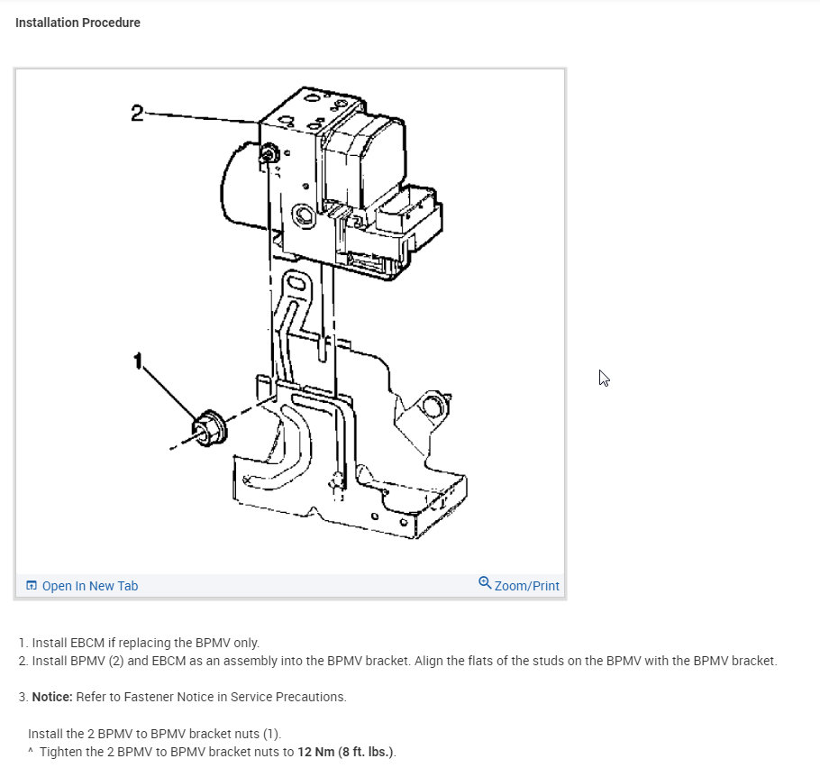

Take a look at the first attachment. This has the OEM part numbers depending on model and equipment. Let me know if you need more info. Check out the diagrams (Below). Please let us know if you need anything else to get the problem fixed. Thanks
