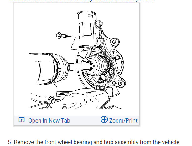

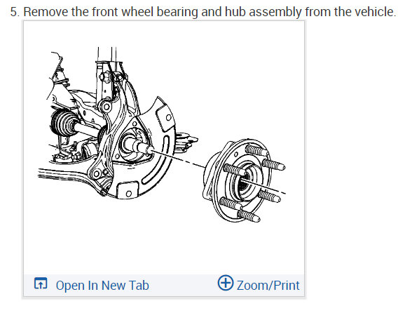

After washing my car, the ABS and Traction control lights came on telling me to service them. At first everything seemed to be working fine but now I have a noise coming from the front driver's side. It sounds like something is loose, but the noise stops when I apply the brakes. I only hear the noise at very low speed. We have had the wheel taken off and cannot find anything wrong. Any suggestions on where else to look?
Oct 13, 2024 at 11:37 AM
  • 55,399 POSTS

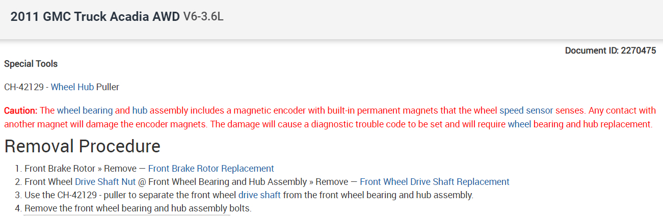

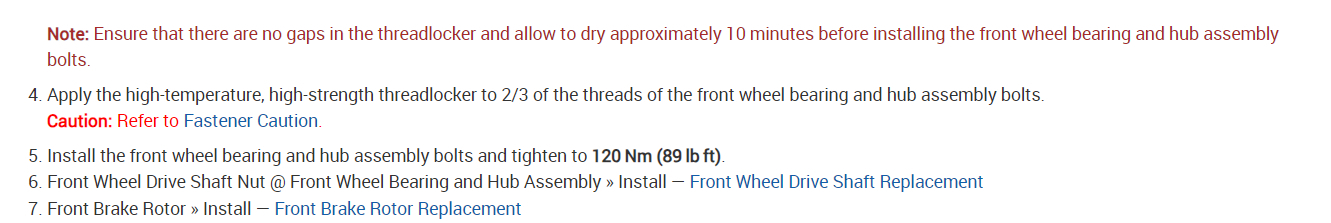

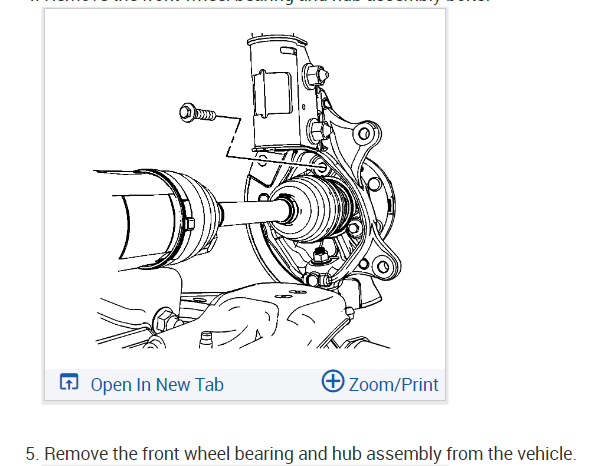

Super cute dog btw ;) yep, it sounds like you have a wheel bearing hub that needs to be replaced, this is why the noise, and the warning lights are coming on. here is how to do the job. Check out the images (below). Please let us know what happens.

Did he run the codes to see if the wheel speed sensor code is present?
This video will help:
https://www.youtube.com/watch?v=HvooM1X2SDs&t=327s
If the lights are on the system should have a code, hopefully it is not possessed, lol.
