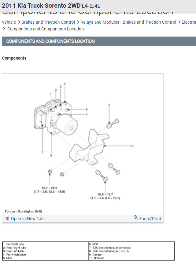

abs and traction control light on
2011 KIA SORENTO
68,998 MILES • 2.4L • 4 CYL • 2WD • AUTOMATIC
RAL WALLACE
While driving abs and traction control light on?
Nov 19, 2018 at 8:47 AM
SQM
  • 6,383 POSTS

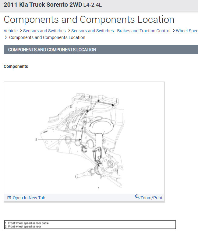

The ABS light gets illuminated when the on-board diagnostics detects issue(s) within the ABS system. It could be a wheel sensor to a module or wiring issues. ABS will also trigger the traction control light as when the ABS malfunctions the traction control does not work.
Best course of action would be to have the vehicle scanned for ABS codes. This can help with the diagnostics and can point to why the light might be illuminated.
Here is a helpful vide of how to check for ABS codes:
https://youtu.be/rTtAnsOlZU4
This guide below covers the common issues with the ABS system:
https://www.2carpros.com/articles/abs-warning-light-on-easy-repair-guide
Let me know what codes you get.
