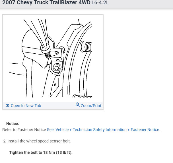

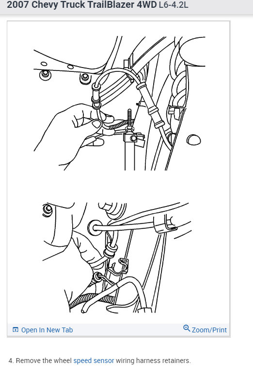

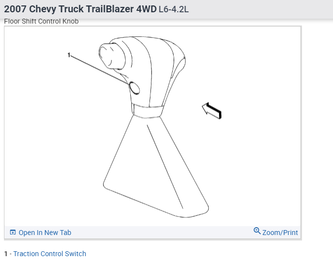

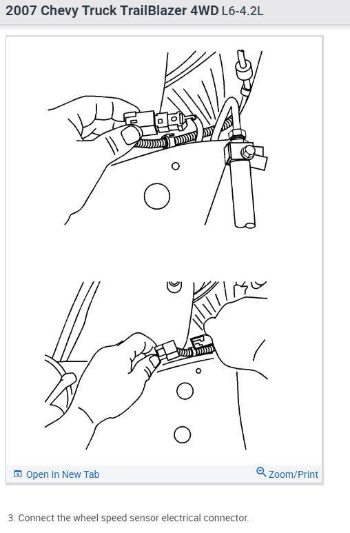

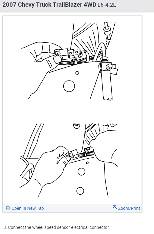

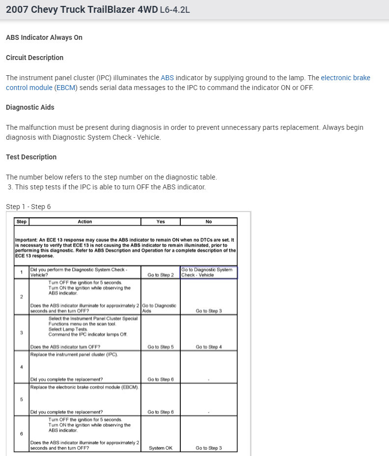

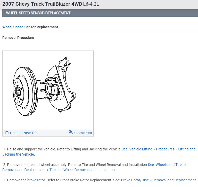

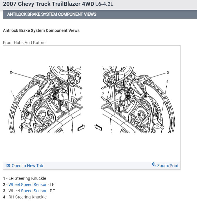

all i did was replace the upper and lower control arms and now all these lights are on. The abs and the stabitrack.By the way I did the alignment and checked to make sure nothing is disconnected. Thanks in advance
Apr 26, 2019 at 6:20 AM
SQM
  • 6,383 POSTS

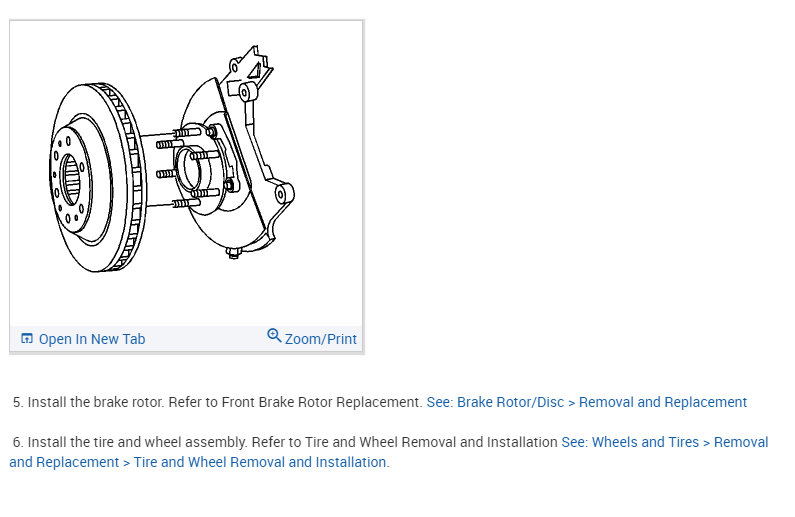

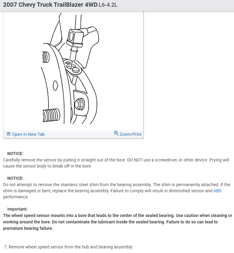

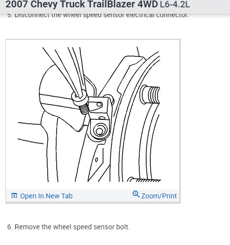

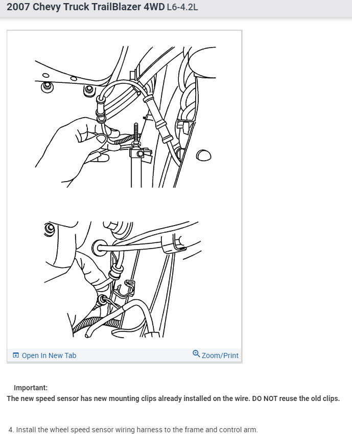

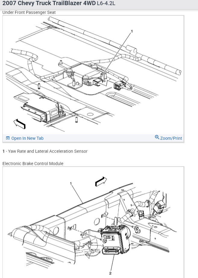

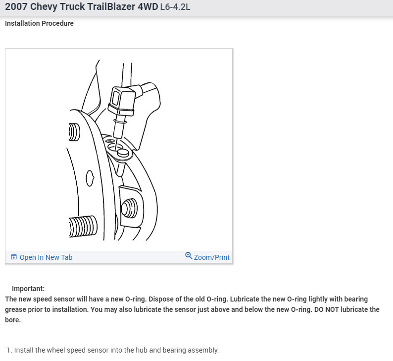

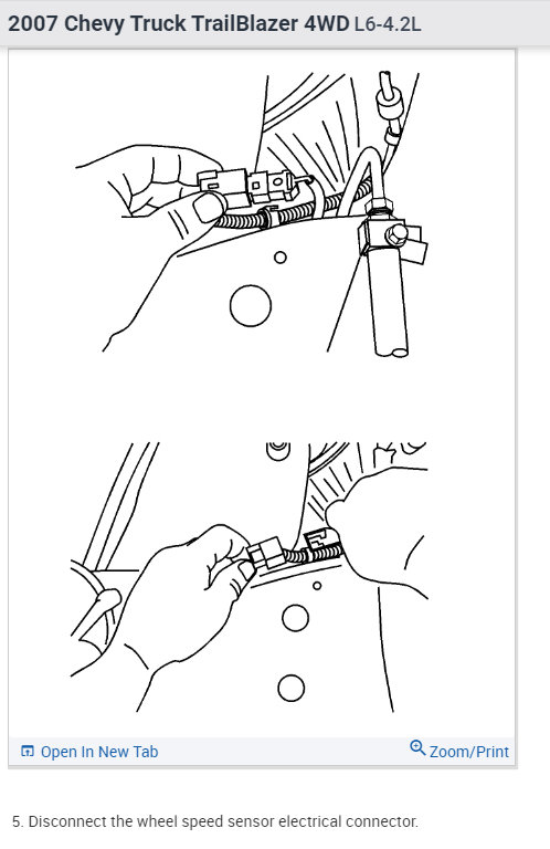

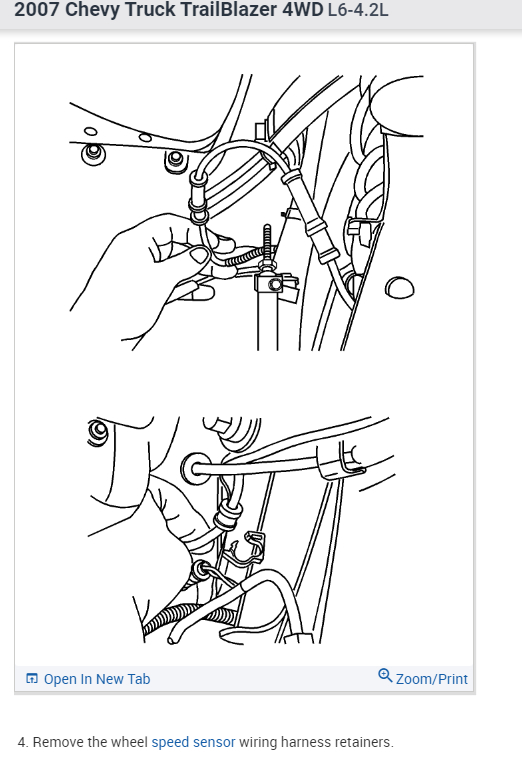

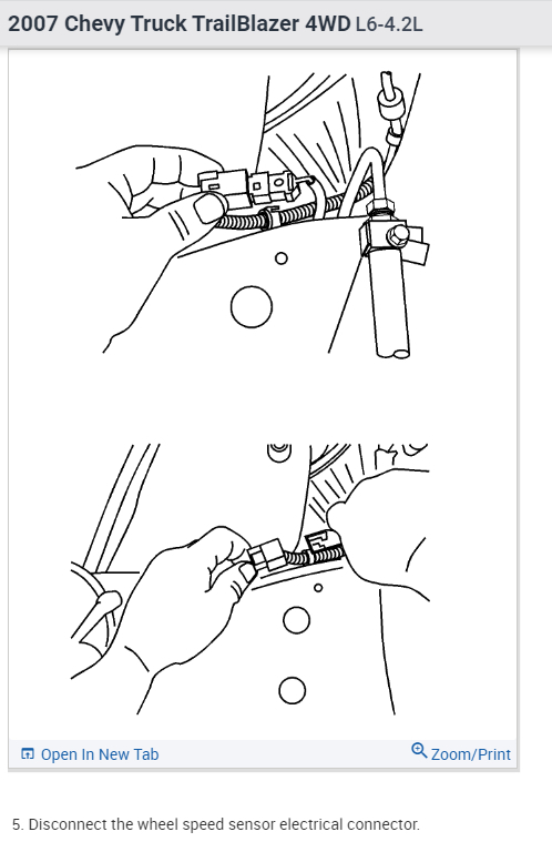

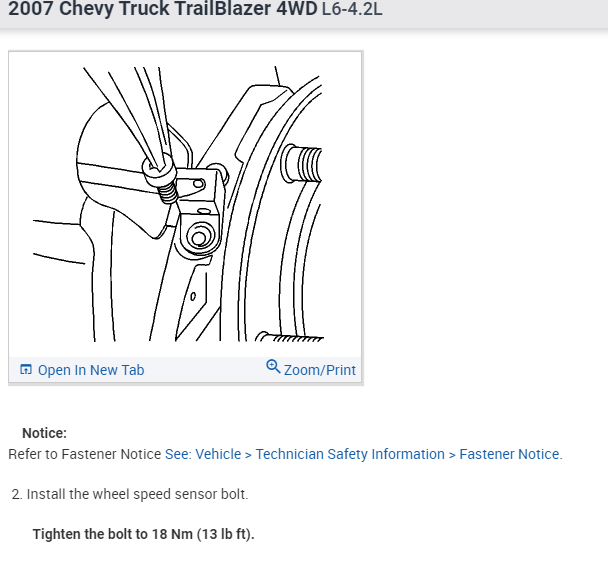

Since those lights were not on before changing out those components, it is likely that the ABS/wheel speed sensor got disconnected or could have pinched wires.
Inspect the ABS sensors. Make sure they are connected and secured.
https://www.2carpros.com/articles/abs-warning-light-on-easy-repair-guide
It will also be a good idea to scan the ABS system for trouble codes, as it could point the issue.
https://youtu.be/rTtAnsOlZU4
I have attached the ABS sensor diagrams for your reference.
