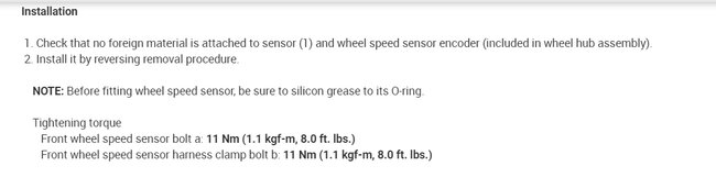

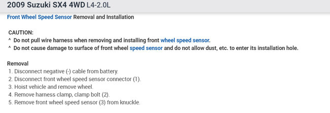

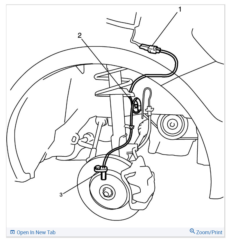

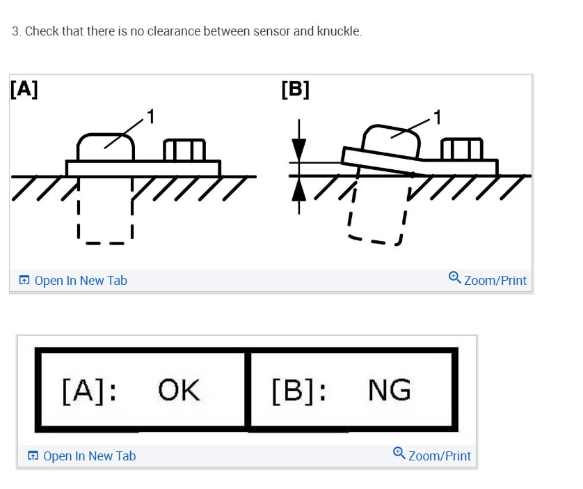

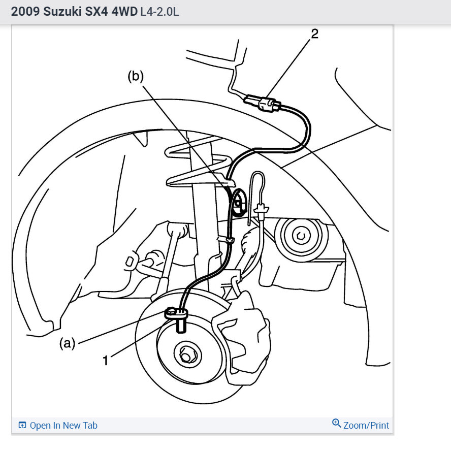

So, most of the time the light comes on when a wheel speed sensor goes out we just need to find out which one, this video will show you how to get the codes to tell you which wheel speed sensor is needed, and I have left instructions on how to change it in the instructions below.
https://youtu.be/rTtAnsOlZU4
