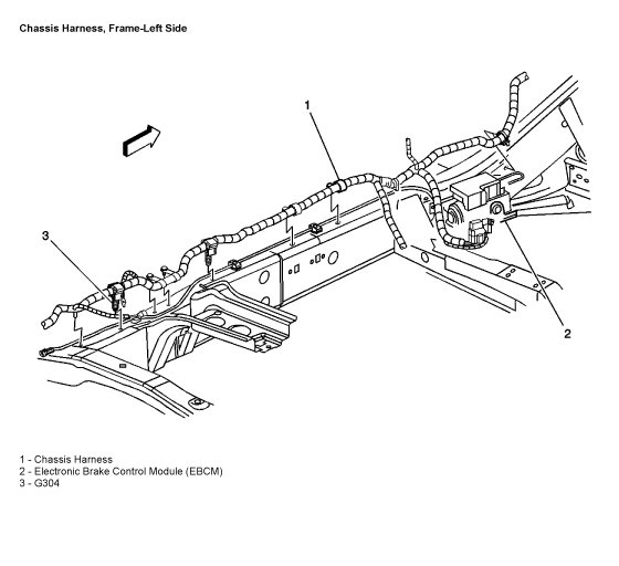

Sorry. I should have mentioned the code in my original question. I did scan it and the code it gave me was C0265 (solenoid valve relay circuit). Is the control module located on the side of the frame under the driver's seat? I think I see it but wow it is in a hard spot to get to!

That code is EVIL.... But you might be able to take care of it easily. There is a TSB on it because of a faulty ground. And you are correct on location. The parts they use are GM 11588337 (M6 sized bolt w/washer head),

1. Remove the EBCM Ground. The EBCM Ground is located on the frame beneath the driver's side door. If multiple grounds are found in this location, the EBCM ground can be identified as the heavy (12-gauge) wire.

Thank you Steve for your input advice and time. I've already cleaned the ground and backprobed the wire about 6" up and checked continuaty to the frame. It checked out good. Guessing i had the right ground. The one that I cleaned was on the left side of the frame but on the outside of it whereas the a module is on the left side of the frame but on the inside of it. I've also read somewhere that it could be that some solder may have come lose on the inside of the control module itself. I just wanna check all the possibilities before I attempt that operation.

The ground is a ways back on the frame up toward the top flange if I recall. If it's got a good ground it is likely that the module is bad, there are a couple of items that can fail inside and cause problems. I don't bother repairing them normally but I guess you could.

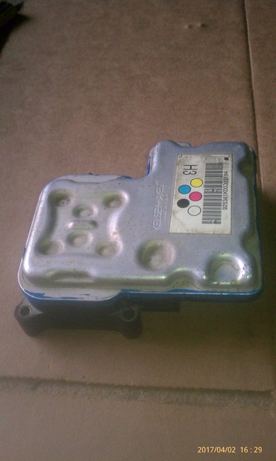

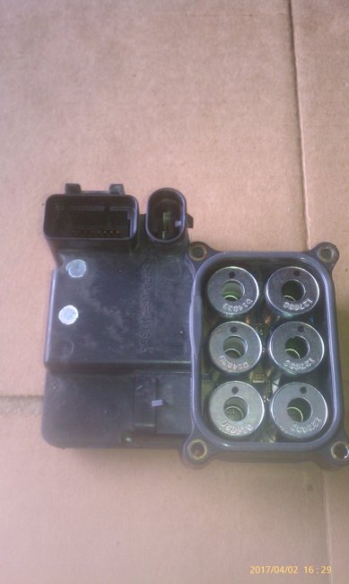

Thanks again for all the info. I took it apart and didn't see anything that stuck out as being wrong. I went ahead and heated up four solder points on two of the plug points then resealed it back together. I did all this before I got your last message about the pics. Sorry but I did take sum pics of something else I found that didn't look quite right. I was getting ready to put it back on the car and noticed some discoloration on one of the pistons.i don't know much about the antilocking systems. I'm thinking about spraying some penetrating oil on six of them and buttoning it back together. Then cleaning one more ground that's a little farther back and seeing what happens. With my fingers crossed of course. Worse case scenario I'll go get another setup at the junkyard. Does anybody know if this system is compatible with another vehicle's setup? I'm trying to find one that under the hood and easily assessable. I'll post the pics I took. Thanks again.

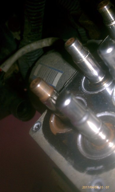

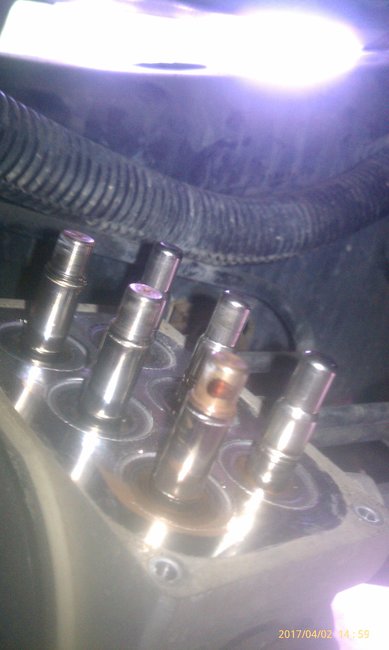

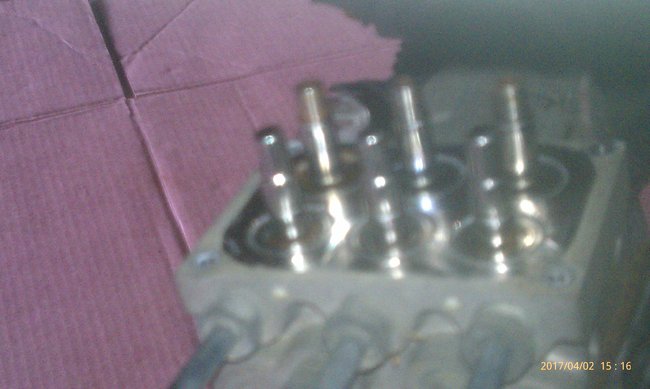

I didn't spray penetrating oil. I was thinking about it tho because one of them looked like it may be froze up. Where I'm talking about is the box that the module sits on and bolts up to with 4 torque head screws. It has what looks like 6 pistons sticking up and one looked odd. Like it was burned or maybe frozen. I don't believe brake fluid ever goes to this area but I could be wrong. I decided to just put the module on and clean up one more ground and see if it comes back on and if it's the same code. I'm not sure about the ABS light and the brake light being two separate problems. I thought the ABS light came on to tell me there's a problem in the anti locking system so the brake light came on too since it is the brake system. There is only one code when I hook up my scanner. And yes I'm reading the ABS diagnostics. The OBD2 has no codes.

The photos you included, (thank you), show the valves that control the flow of brake fluid during a skid. There is no brake fluid on that side, but still, do not use any type of oil there. That oil can reach the side of the rubber lip seals opposite of where the brake fluid is. The problem isn't the oil getting into the brake fluid. The problem is the rubber is not compatible with petroleum-based products. Brake fluid is a glycol product. The rubber will become soft and mushy, and will grow bigger. That will impede the movement of the valves at first, and eventually the seals will start to leak.
Those valves move first to block fluid flow to a wheel that is slowing down more than the others when the brakes are applied. If the wheel speed doesn't pick back up, another valve opens to bleed fluid pressure off. Once the wheel speeds up again, another valve opens to allow more brake fluid to flow to that brake. This "block, bleed, apply" can occur up to 30 times per second, although most systems do that just as effectively at 15 times per second. That is the buzzing you hear and feel when the ABS engages.
