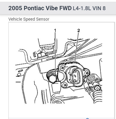

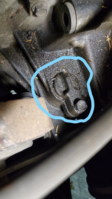

Hey again, decided to take the transmission speed sensor out, but it looks like my car does not have one!? I found a guide on where it's supposed to be for the Toyota Matrix version of my Pontiac vibe, but instead of finding the sensor, I found what looks like a "delete" plug covering the hole. Any suggestions for where to look next to solve this issue? Thanks

Take a look at the pic below. Are we at the same place? If so, do me a favor. Locate the production date of the vehicle. Maybe if it is an early or late production, something was done differently.

That does look like the same place to me. Here's a 10 sec video showing where I found the delete cover: https://photos.app.goo.gl/uxpPqcU4PwfRQcvU6
Car build date was 04/04 and the VIN is 5Y2SL62894Z470423

I did watch the video and believe you are looking in the correct place. I also looked up the sensor for a 2004 and 2006. Both are the same as what I attached.

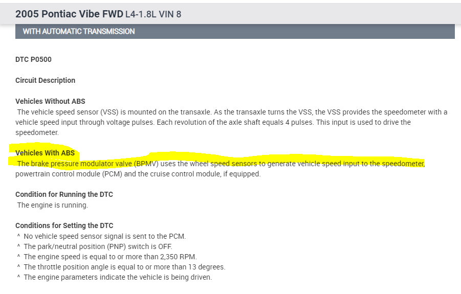

So, I did more digging. You do have ABS. That means the sensor signaling the speedo is a wheel speed sensor and not one mounted on the truck. See pic 1.

No problem whatsoever. It was driving me nuts because I couldn't make sense of it. LOL I had to look up codes (guessing which would help) to look for variations. That's how I found it.
Since the sensors are sending a signal right away, I suspect there is a connection issue. At least, that is where I would start. The faster the vehicle moves, the higher the voltage to the speedo gets.

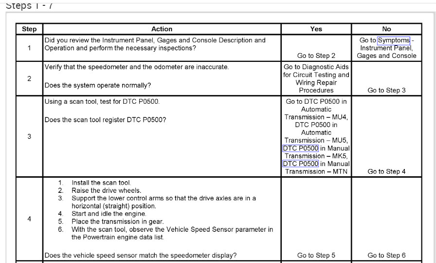

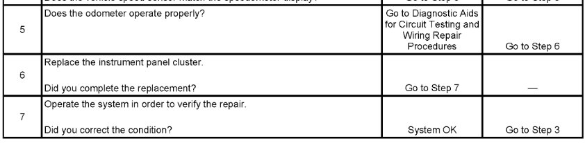

I just read through the diagnostics for a speedometer issue. I attached them below for you. The diagnostics are basically what I explained to do. The interesting thing is there is no diagnostic trouble code (P0500).
If there is no code and the speedo doesn't work in conjunction with the speed sensors, they indicate replacing the cluster itself. If you have a chance, recheck to see if there are any codes that showed up.

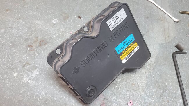

The speedometer diagnostics seem to be basically, drive the car and see what the scan tool says. The scan shows wheels speed sensors to be fine and vehicle speed to be zero for the first 100' of driving, just like the speedo. Unless it's related to the ABS and brake lights staying on for the 1st 100' of driving, I'm not concerned about the speedometer not working for the first 100' of driving. I wouldn't even worry too much about the ABS and brake lights since they always go off and stay off after the first 100' of driving, but I need to ship the car, and they won't accept it like that.
I'm thinking of replacing the ABS module. Does that seem like the next step? They are available used for not too much.

Just wanted to follow up. I got a salvage ABS unit and removed the black plastic electronics module from it, despite the sticker warning not to loosen bolts ;). I removed the black plastic electronics module from the ABS unit in my car and installed the salvage one. On startup ABS and brake lights went out as they should. Salvage ABS module scan showed numerous faults. Cleared the faults and test drove the car. Scanned again and no faults found. Seems to be fixed. :)
