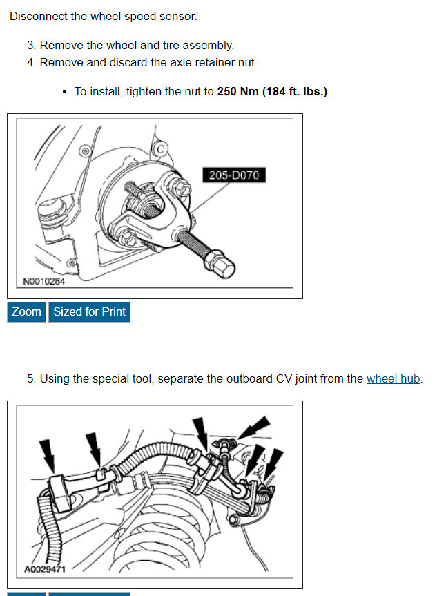

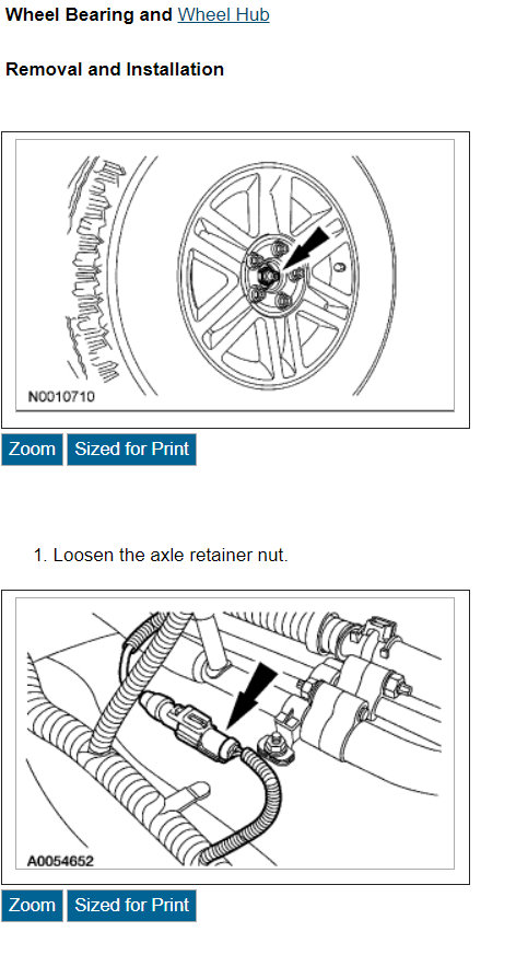

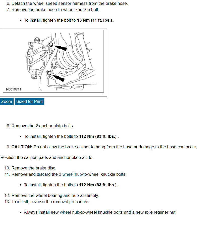

Yes the left front wheel bearing hub holds the ABS wheel speed sensor which sounds like it has gone bad. Here is a guide to help you test the sensor and replace the sensor
https://www.2carpros.com/articles/abs-wheel-speed-sensor-test
and
https://www.2carpros.com/articles/bearing-hub-replacement
You can get a replacement form Amazon.
Here is how it will be for your car (below)
