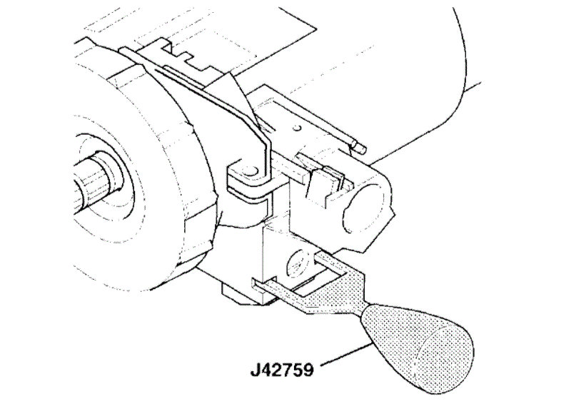

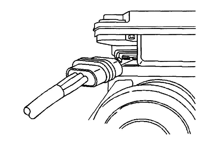

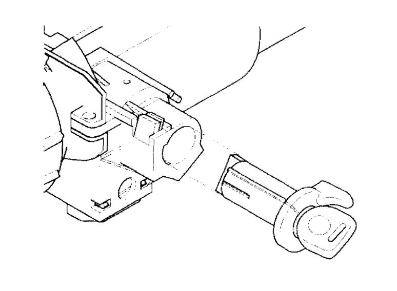

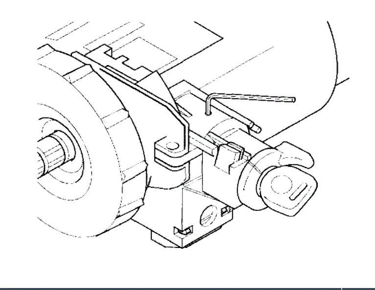

This could be the ignition switch dropping out.
GM had a huge recall on ignition switches for all kinds of issues. I would call the dealer and give them your VIN and see if you were in the recall.
1. Disconnect the negative battery cable.
Caution: Refer to SIFI Caution in Cautions and Notices.
2. Disable the SIR system.
3. Remove the hush and knee bolster.
4. Remove the steering column trim covers.
5. With the key installed, turn the key to the RUN position.
6. Install an alien wrench into the hole on top of the lock cylinder housing.
Push down on the alien wrench to release the tab on the lock cylinder inside the lock cylinder housing.
7. Slide the lock cylinder out of the lock cylinder housing.
8. Disconnect the PASSLOCK and key buzzer from the lock cylinder housing.
9. Insert J 42759 into the lock cylinder housing to release the tabs on the ignition switch.
10. Pull the ignition switch out of the lock cylinder housing.
11. Disconnect the connector from the ignition switch.
