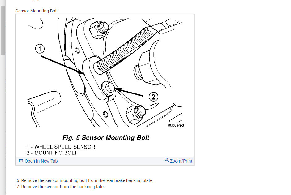

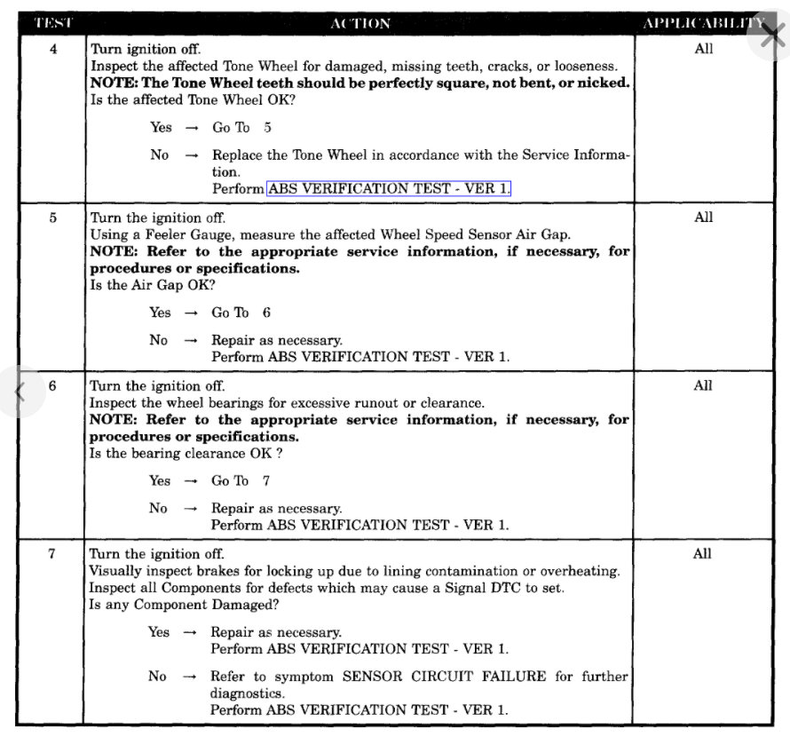

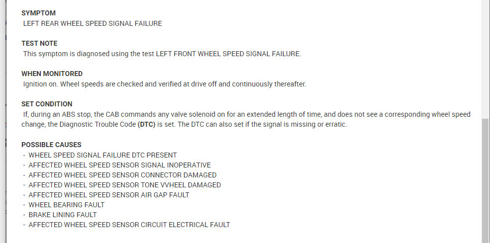

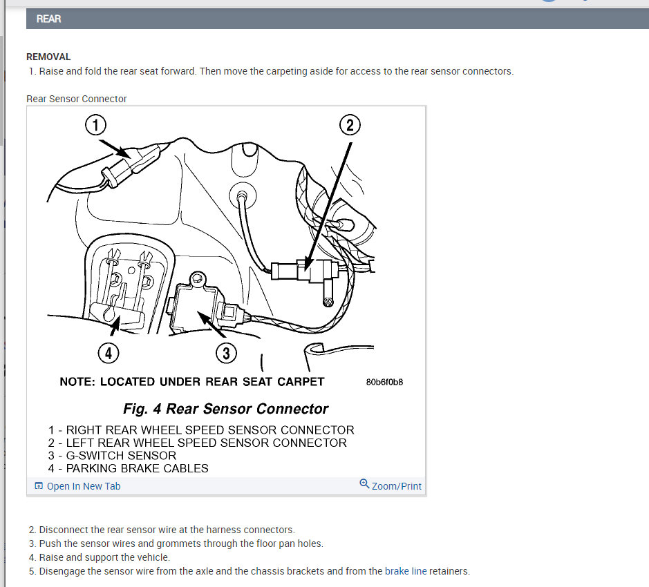

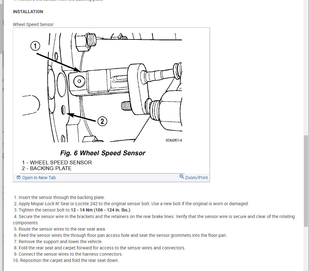

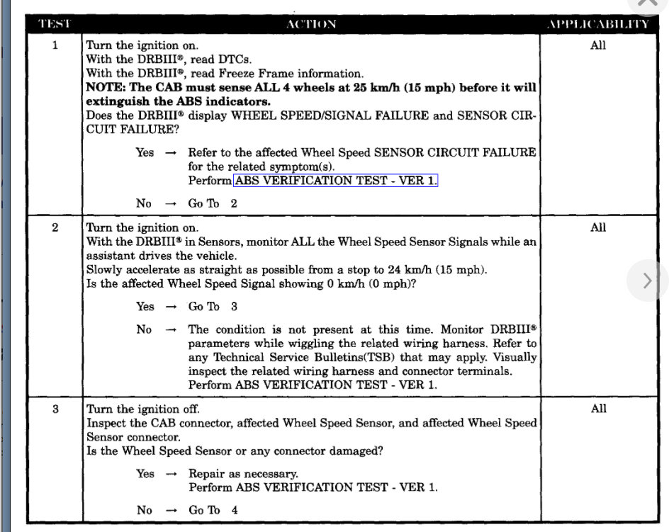

I am also attaching the info below from the manual on how to test and replace the wheel speed sensor if this proves out. This testing is for this failure but I suspect the sensor or hub is the issue since you have to be moving before the light comes on.
Please run through this and let us know what you find. Thanks
