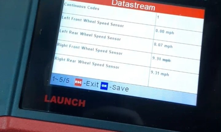

Since I need one for the future anyways, I am picking up an OBD reader which can read live wheel speed sensor data. Should be able to pick up if one isn't reading right. Found no obvious problems that could be causing it.

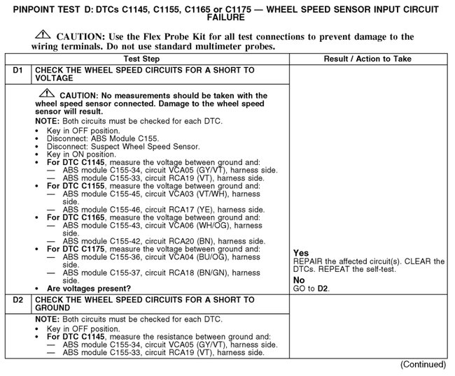

Code is C1155-20: Left front wheel speed sensor input circuit failure. I went ahead and pulled the ABS pump fuse so it doesn't kick on without me wanting it on for the time being until the weather clears up so I can fix it. I'll make sure to inspect the ring for missing teeth etc., too since it is odd that it only does it turning.

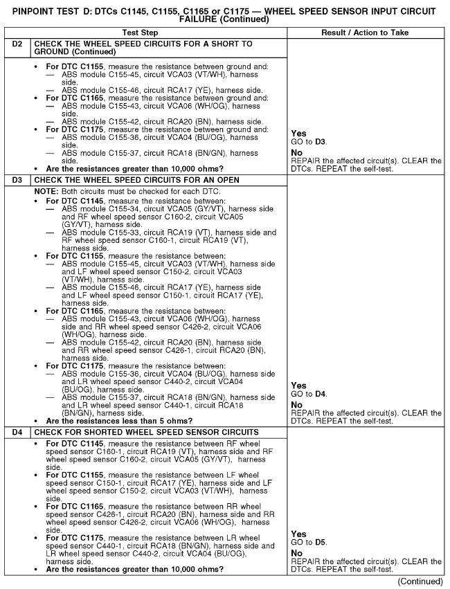

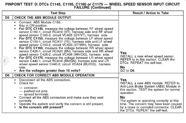

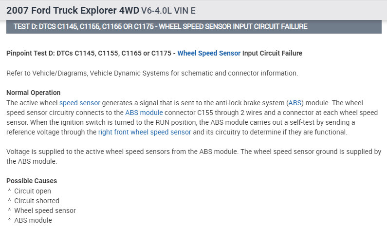

The code C1150 can get triggered due to an open or short circuit, bad wheel speed sensor or even faulty ABS module.
I have attached the troubleshooting steps for this code below.
Follow those steps and that should help you determine the issue.

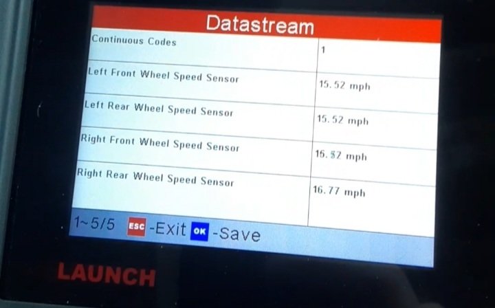

Did a test with a scanner. Sensor only reads 0 when turning. I'll look at the rings when replacing the sensor.

So, when you turn it is probably losing signal/connection due to worn wire. It might not be the ring as that stays constant unless there is some excess movement.
