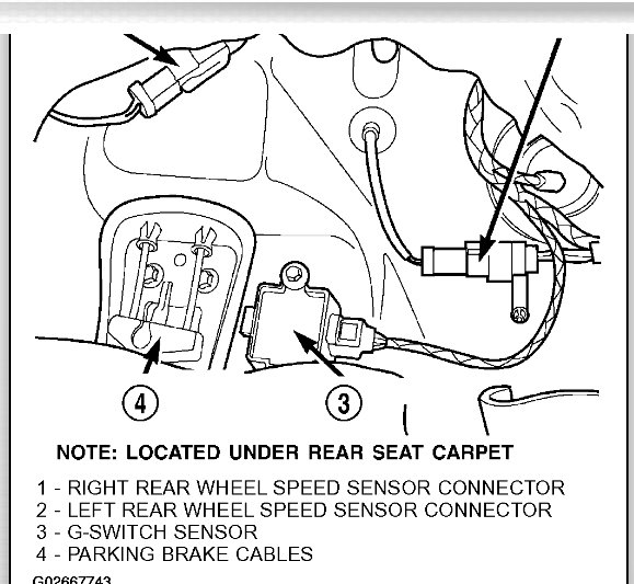

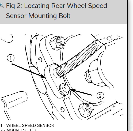

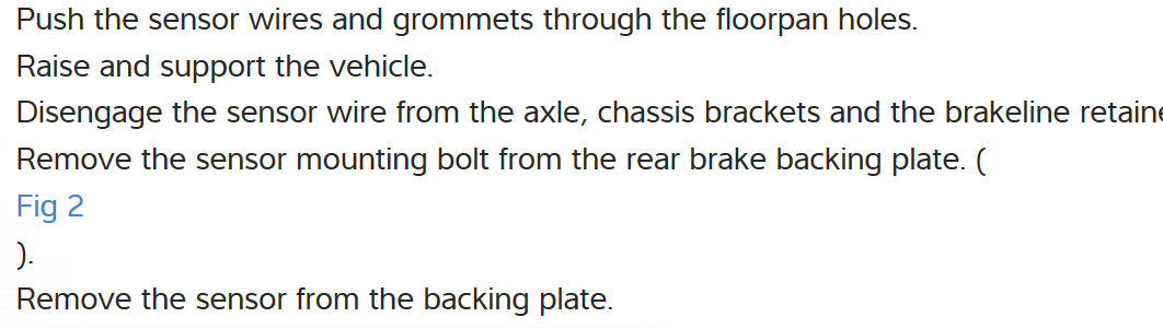

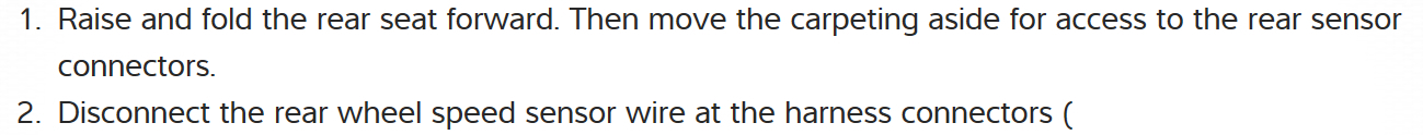

I took it off the wheel, but the other end goes into the body, is it in the spare tire compartment somewhere? thanks again!
Jul 10, 2017 at 4:14 AM
HMAC300
Experienced Mechanic
48,601 POSTS
See pictures. Install is basically reverse of removal torque sensor bolt to 106-140 inch lbs. if bolt is damaged replace it.
