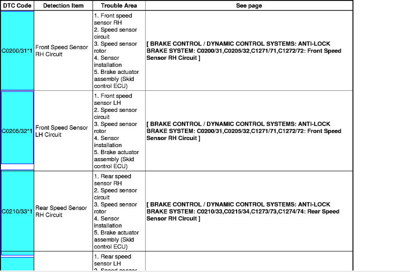

Can I pull codes without a scan tool? Tried jumping pins 4 and 13 at the ddl connector under dash and got ABS flashing code 91, but no listing for this code. Maybe not able to read code on this newer model.

The easiest way to read fault codes is by using scan tool, ABS fault codes appears as(C) codes for example check the tables at figure 1.
Check the fault code then together will can properly troubleshoot and repair your problem.

no, the proper way to read faults by using scan tool. only at old cars without OBD socket can be pulled the fault codes by counting the blinking of the check engine light then check on workshop manual.
