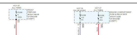

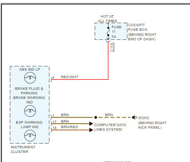

Where is the ABS system fuse located?
2010 MERCEDES BENZ R350
150,000 MILES • 6 CYL • 4WD • AUTOMATIC
KEVO57
Dec 22, 2023 at 2:01 AM
  • 55,381 POSTS
There are four fuses that run the system fuse# 11 in the fuse panel at the left side of the dash controls the ABS warning light. Fuse #6 100 amp located in the fuse panel at the right rear of the engine compartment is the main ABS pump motor fuse, and the fuse #115, and #109 in the fuse panel at the right side of the engine compartment control the ABS module. Check out the images (below). Let us know if you need anything else.
