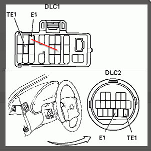

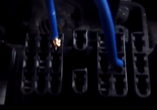

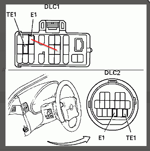

Hello Kasekenny1, i try to pull out the codes, but the check engine light stay blinking constantly. I did it like the image below.
Can you tell me why?
Thank you so much for the support.
Oct 25, 2020 at 12:07 AM
Okay. I think that is telling you that you have no engine codes but ABS codes I believe you are to jump TC and E1. Looks like that will cause the ABS light to flash to give you the code. You count the first flashes and then there is a pause and then count the next flashes. If there are more then one code it will pause for 3 seconds and then flash the next one.

Hello kasekenny1. Sorry for the late.
I pullout the OBD code 52 for the Lexus gs300 1995 knock sensor signal.
The instrument cluster melt (literally) but with your help i can make the check engine light came back to life and pullout the code.

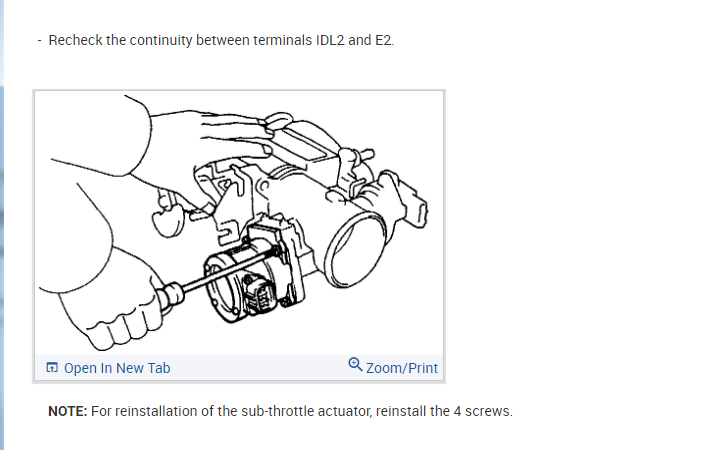

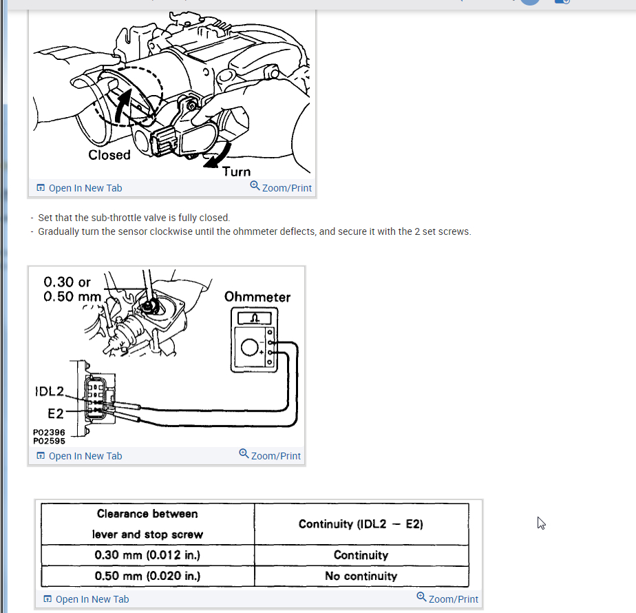

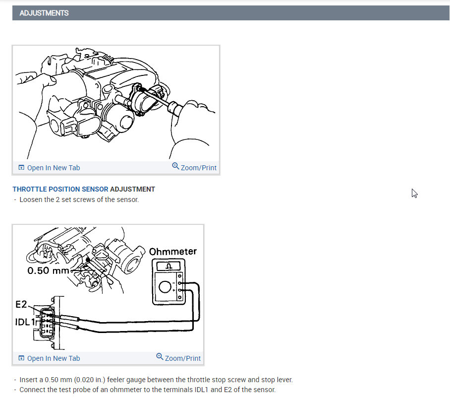

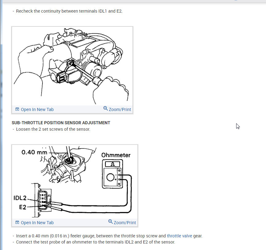

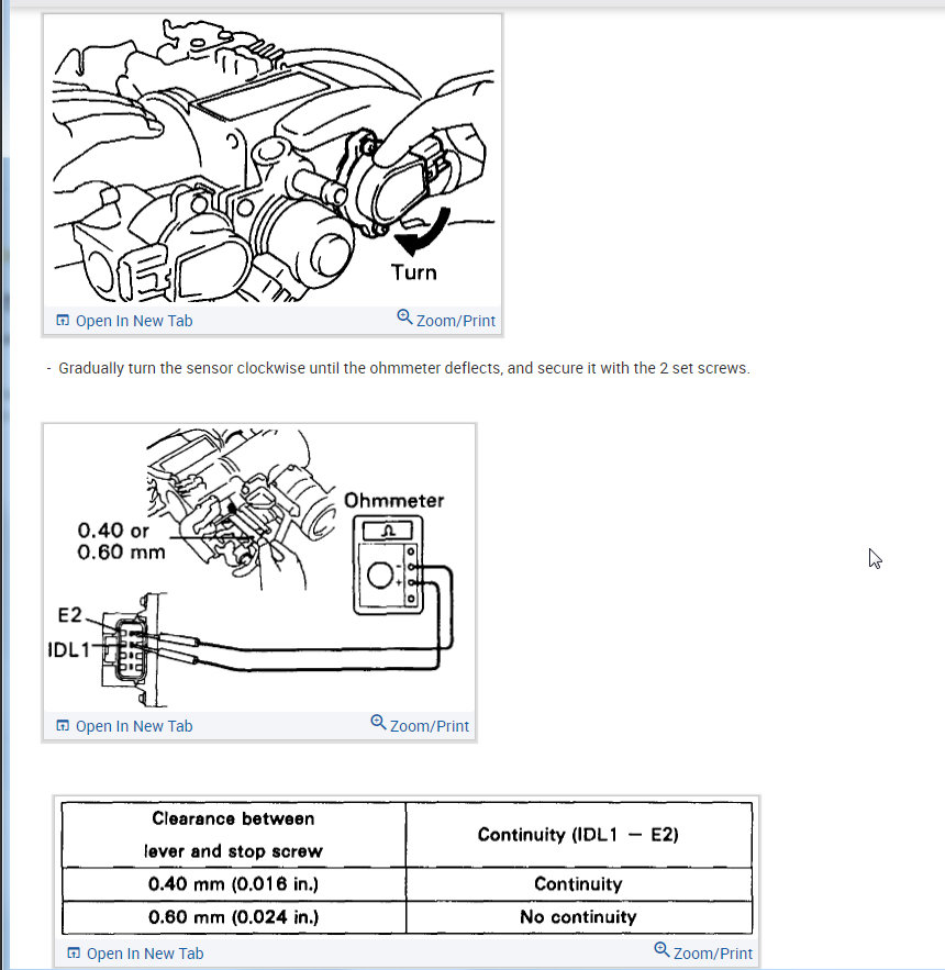

I need a little more help. Can you send me information to set the new TPS and the location of the knock sensor and wiring diagram to make some test i get that Lexus to the road again?
Thank you so much for all your help.
Nov 14, 2020 at 10:20 AM
Okay. Here is the process for adjusting the throttle body/sensor but we need to get a new post started as these issues are no longer related to the title and others are not going to find the solution to these items under this post.
