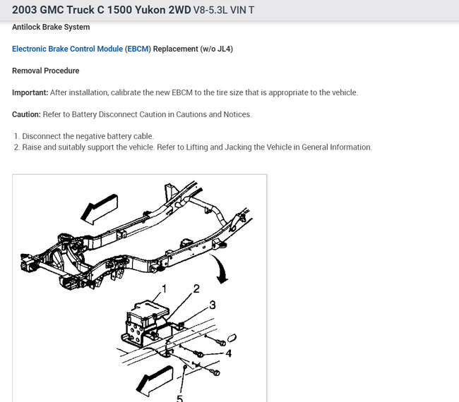

If I replace the ABS Module, will it need to be programmed to the vehicle?
2003 GMC YUKON
246,000 MILES • 5.3L • V8 • 2WD • AUTOMATIC
AUTOMCH
ABS Module replacement.
Jul 31, 2023 at 1:39 AM
  • 55,224 POSTS

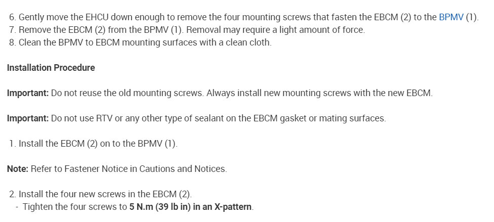

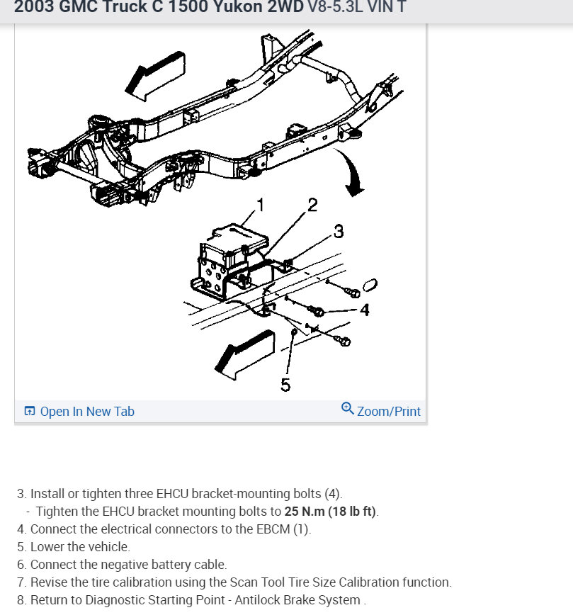

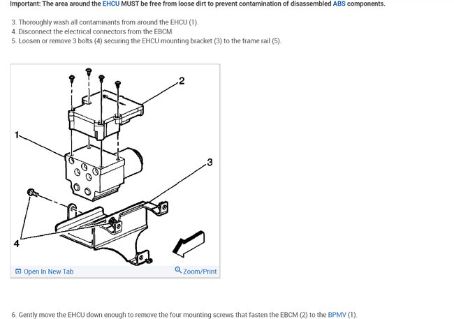

The ABS control module does not need to be programmed but you will need to revise the tire calibration using the Scan Tool Tire Size Calibration function, but I have seen people skip these steps and the system still worked. Here is a video and guide to help you with the job:
https://youtu.be/lUotkKXG9dY
and
https://www.2carpros.com/articles/how-to-replace-a-abs-controller
Check out the images (below). Please let us know if you need anything else to get the problem fixed.
