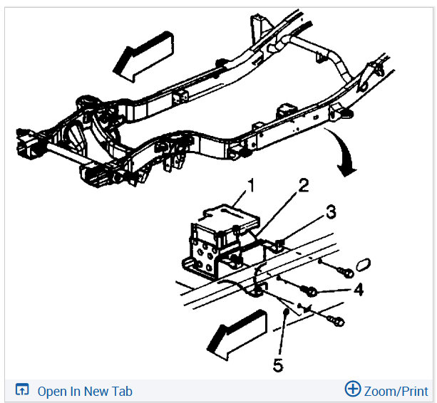

how to replace ABS pump motor on the truck?
Jul 22, 2025 at 2:32 AM
CLASSIC-AL

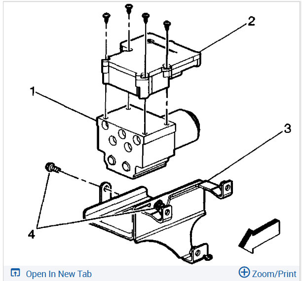

Can pump motor only be replaced?
Jul 22, 2025 at 3:29 AM
  • 55,433 POSTS
If the pump motor is stuck on the control module needs to be replaced, you should be able to change the motor on the hydraulic valve block. here are some diagrams and instructions on how to bleed the ABS system once you are done.
https://www.youtube.com/watch?v=nQRnKyVyMuQ
Check out the images (below). Let us know what you find.

CLASSIC-AL
Thanks. Looks like I need to pull mounting bracket off unit to do so. Maybe can do on vehicle. But first must double check motor operation. If scan tool (bi-directional) can't force it, is there another way? (Besides slamming the brakes on, at speed,) Thanks, Classic-Al.
Jul 23, 2025 at 10:23 PM
  • 55,433 POSTS
If the scanner cannot force it to activate the only other way is the brake hard on a gravel road. You can remove the unit and put 12 volts to the motor to see if it works.
