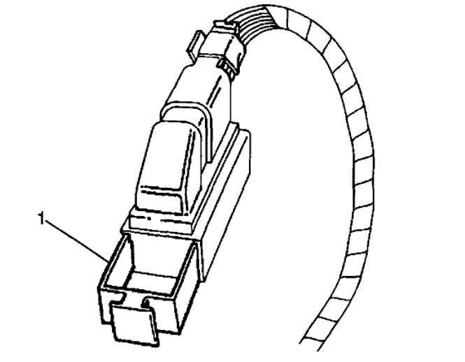

7. Disengage the locking tab (1) from the EBCM harness connector.
8. Disconnect the EBCM harness connector.

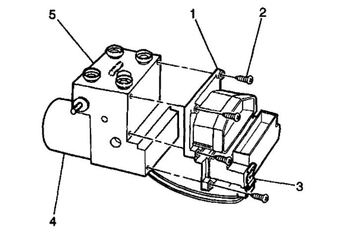

10. Remove the 6 EBCM to BPMV retaining bolt/screws.
Important: Do not pry apart using a tool. Be careful not to damage BPMV surface.
Important: Care must be taken not to damage the solenoid valves when the EBCM is removed from the BPMV.
11. Separate the EBCM (1) from the BPMV (4) by gently pulling apart until separated.
12. Disconnect the pump motor connector (3) at the bottom of the EBCM.
