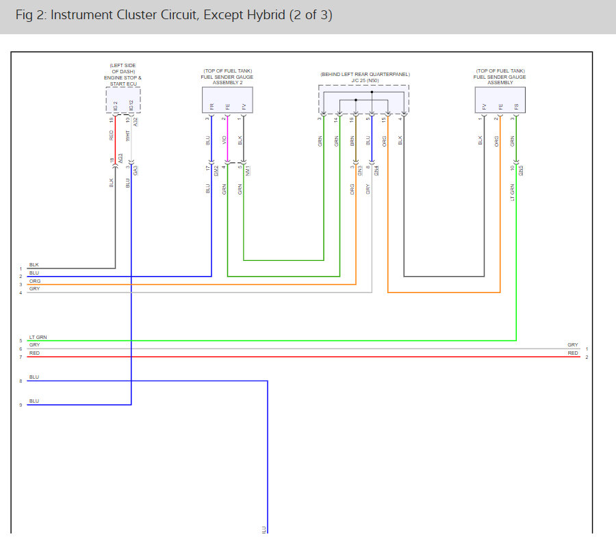

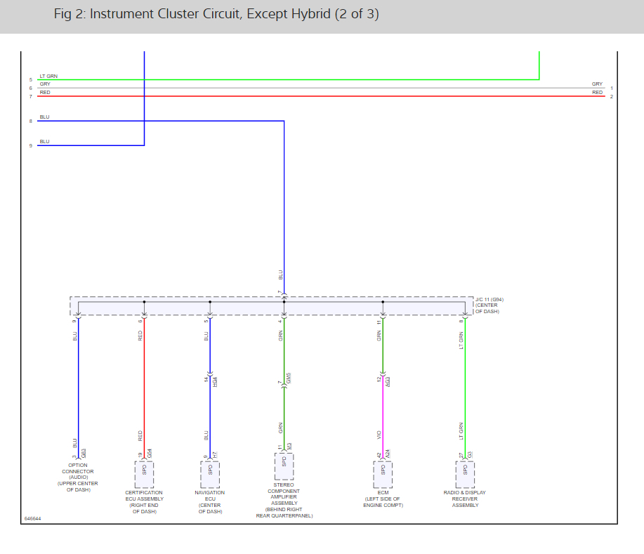

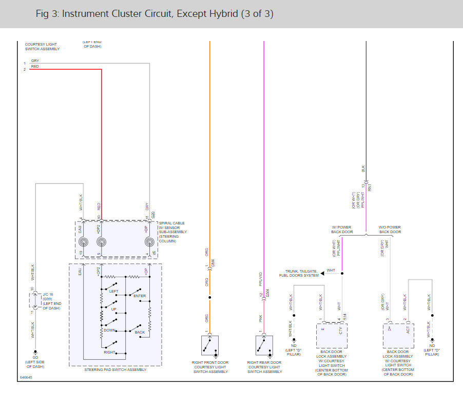

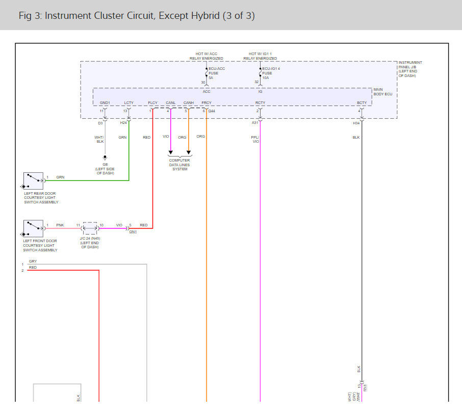

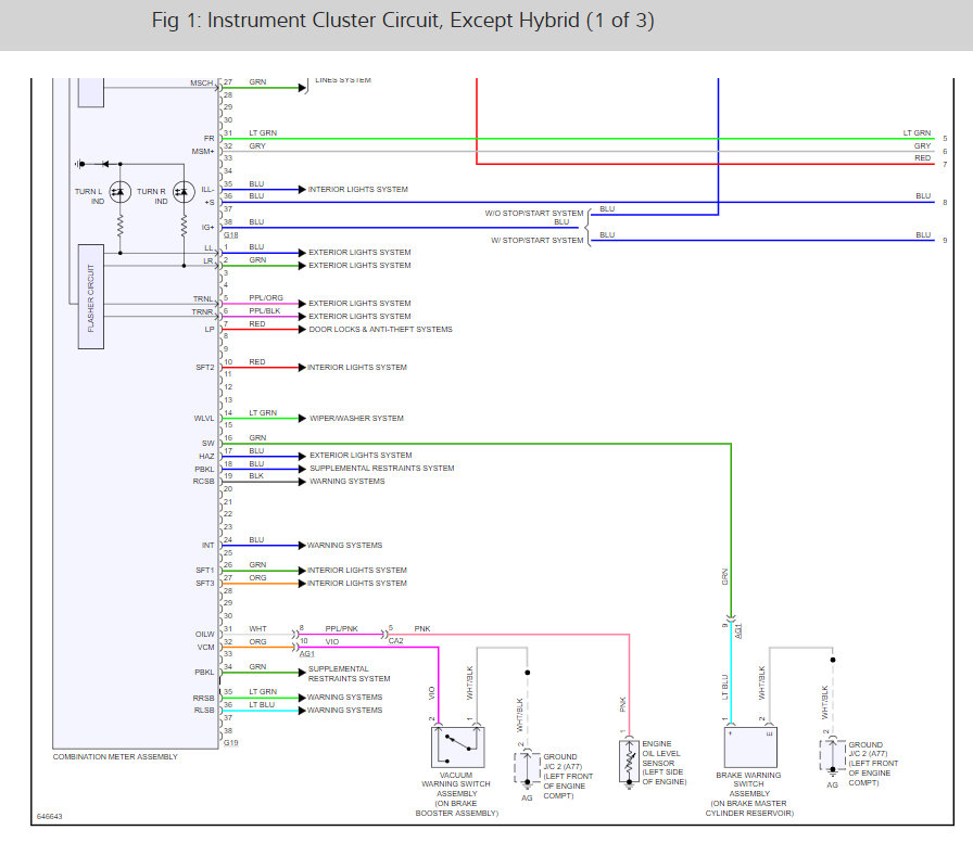

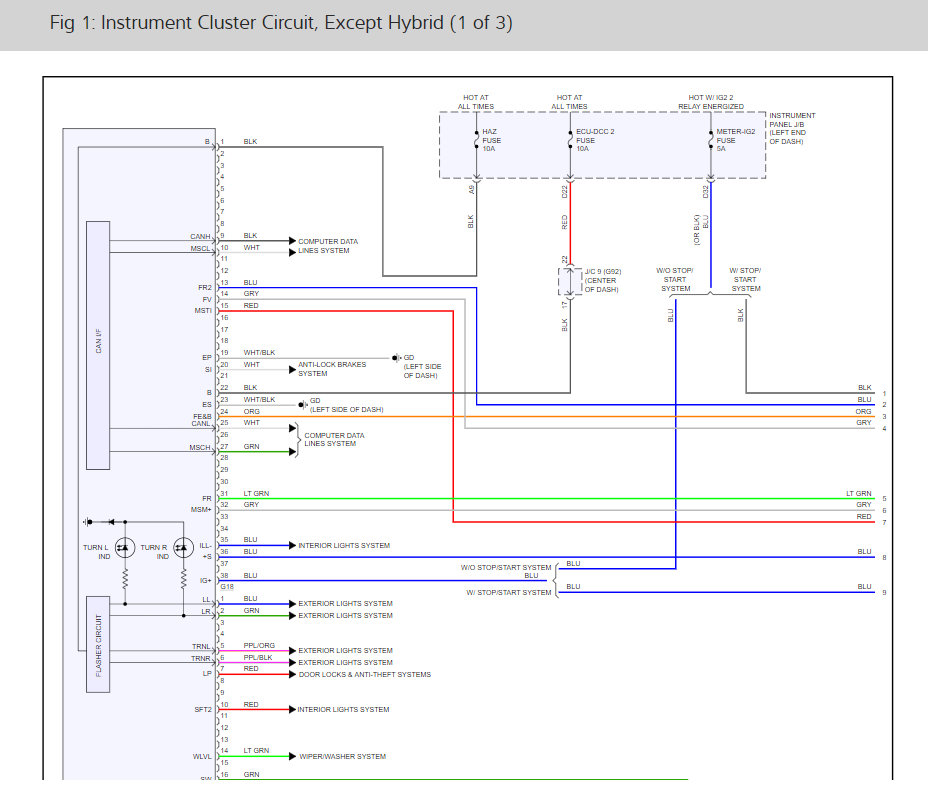

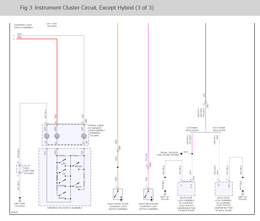

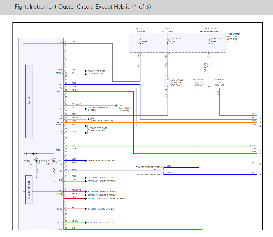

Which sensor wire do you need? Here is a guide on how to check the wiring and the instruction cluster wiring diagrams below:
