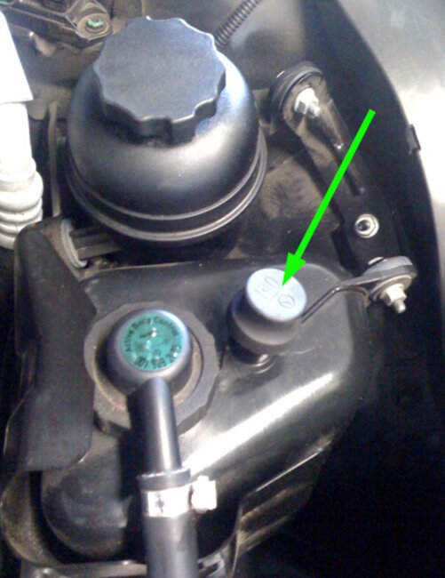

I noticed some hydraulic oil leak under the car front left side and the car drop down only left side, checked there are no leaks from the front valve block unit or the shock absorber. i found oil coming from the top of the ABC fluid tank, see picture.

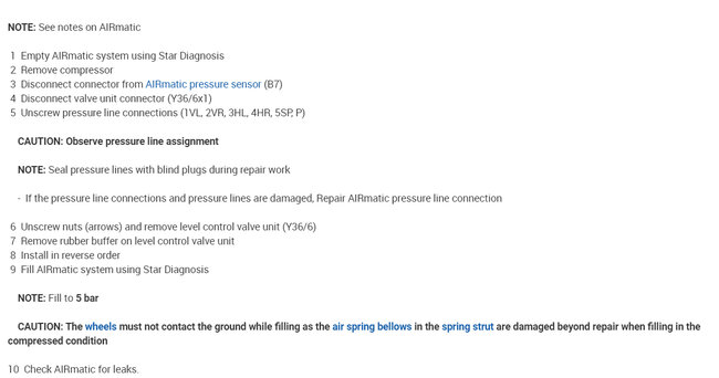

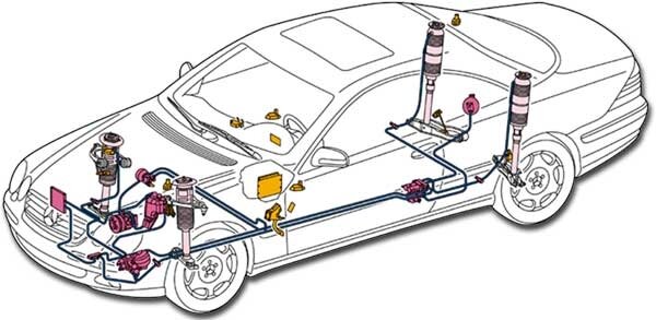

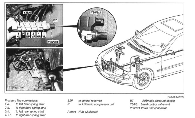

This problem happens when the valve inside the hydraulic control unit leaks and bleeds the system down and back into the reservoir. These systems are notorious for problems. Check out the images (below). Please let us know what happens.

Please note that I don't have the same picture you sent to me, my car is ABC Hydraulic system and not AIR Matic system, please see the attached picture. thanks

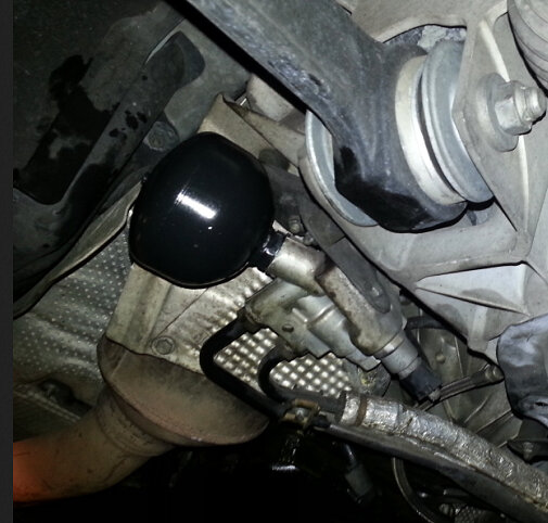

Now I have checked the right side and see under the car which is ABC pressure sensor (pic Attached) found leaking, will replace with another one and let you know what happen soon.

Thanks for the image let me know how it goes. I think you may have fixed it.
