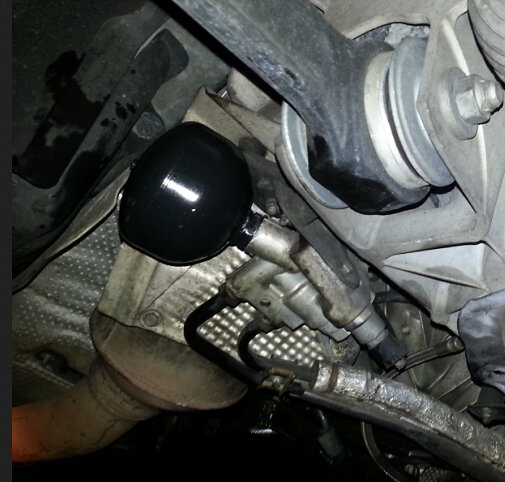

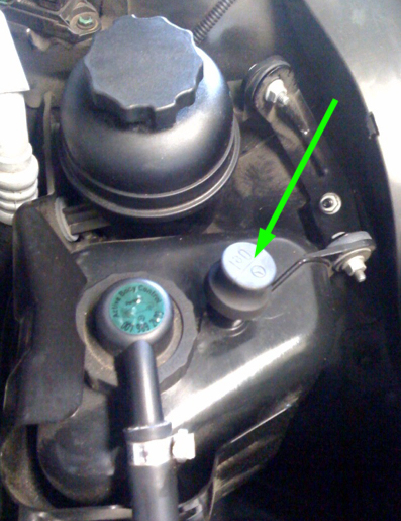

I noticed some hydraulic oil leak under the car front left side and the car drop down only left side, checked there are no leaks from the front valve block unit or the shock absorber. i found oil coming from the top of the ABC fluid tank, see picture.
I opened the ABC valve block unit to change the seals and found all okay, but changed with new ones and fixed back, there is no leak.
Again, the car drops down from the front left side and the same oil leaks from the top side of the tank.
I appreciate your kind help me, i use to get professional help from you to solve my problems with this car.
Thanks,
Ramzi

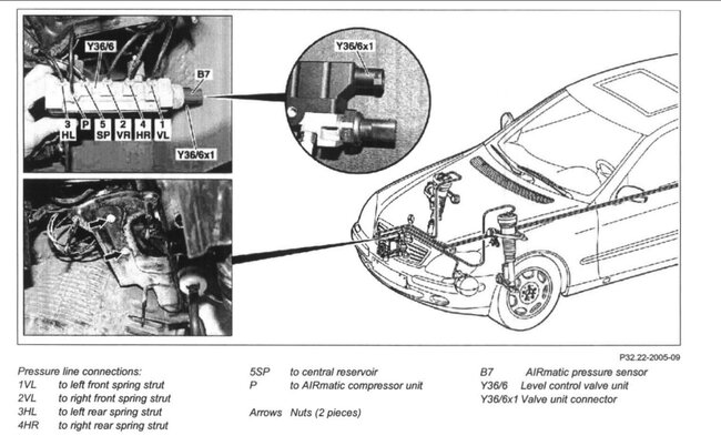

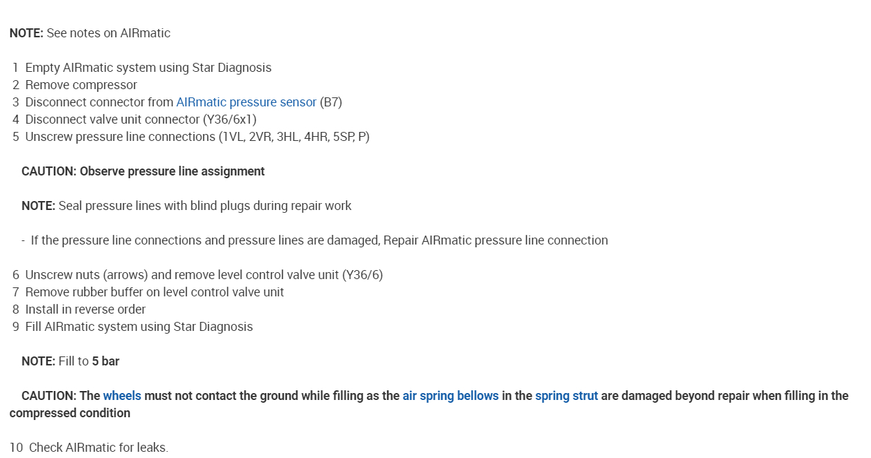

This problem happens when the valve inside the hydraulic control unit leaks and bleeds the system down and back into the reservoir. These systems are notorious for problems. Check out the images (below). Please let us know what happens.

Please note that I don't have the same picture you sent to me, my car is ABC Hydraulic system and not AIR Matic system, please see the attached picture. thanks
