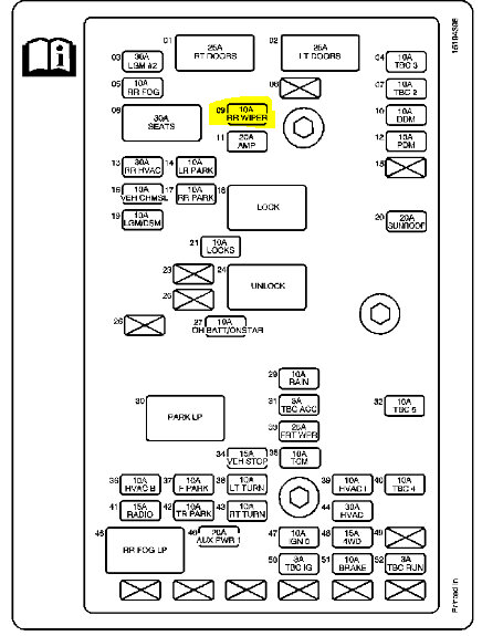

Is there a fuse for the back windshield wiper and what is the abbreviation for it?

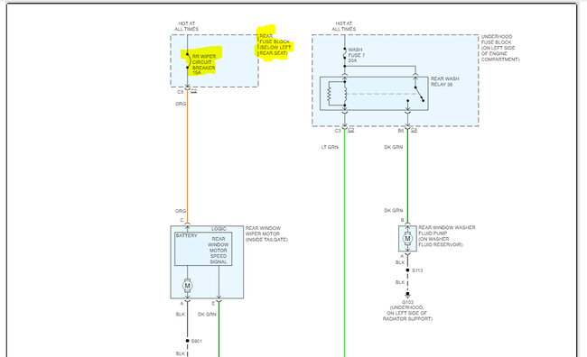

Actually, the rear wiper/washer is on its own circuit. And although there isn't a fuse, there is a circuit breaker. It is located in the rear fuse box, under the left rear seat.
I attached the wiring schematic, so you have it as a reference if needed. (Pics 1 and 2 below)

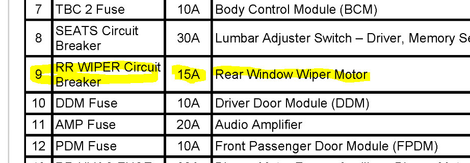

If you look at pic 3, it shows the fuse box. I highlighted the CB. Interestingly, the schematic indicates it as a 15-amp circuit breaker. The legend for the fuse box indicates a 15-amp circuit breaker. When I look at the fuse box pic, it shows a 10-amp fuse. LOL
Check it out and let me know your thoughts.
