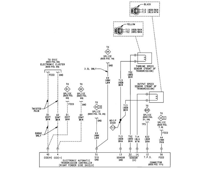

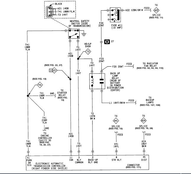

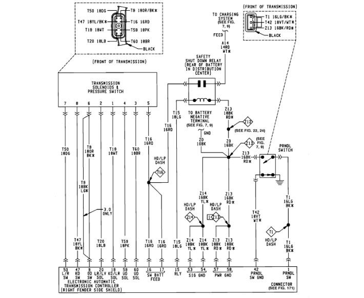

My mom's car has been into the garage for a couple of years, some weeks ago we decided to bring him back to the life but surprisingly it does not work. Our mechanic said there is a problem with transmission and it might be caused by rats which have probably ate the wires. Is it possible to find some wiring diagram? Thank you beforehand. :)

I found some diagrams for you to view as requested.

Hello Roy! I forgot to mention our transmission is the A604/41TE. Are you sure these diagrams are the right ones?
Oct 25, 2018 at 7:19 AM
Yes, that is the electronic transmission diagrams.
The other transmission has no electronics involved.
