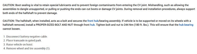

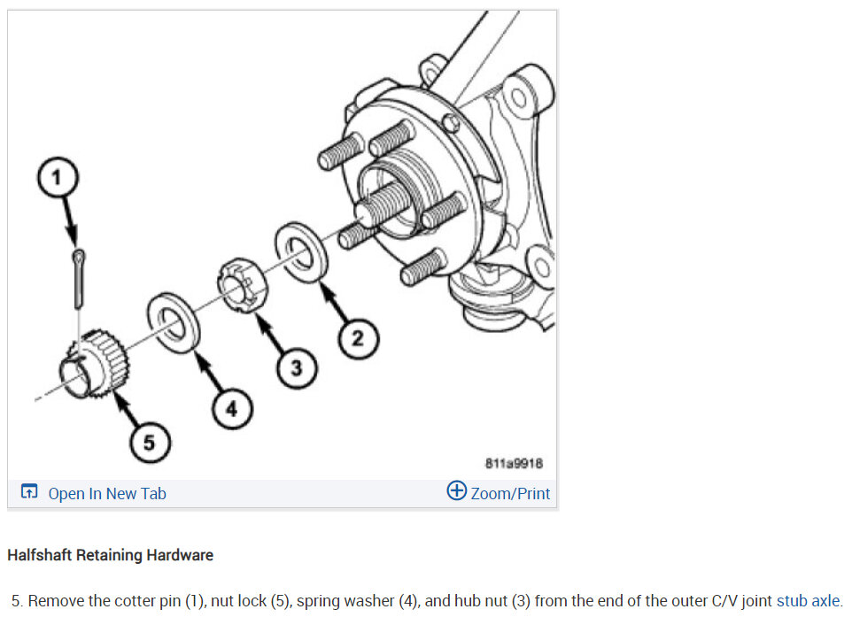

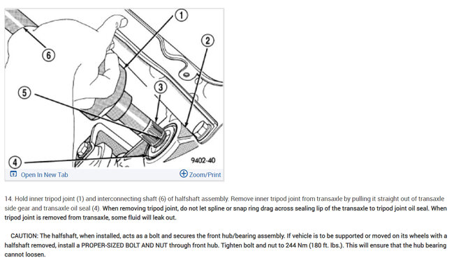

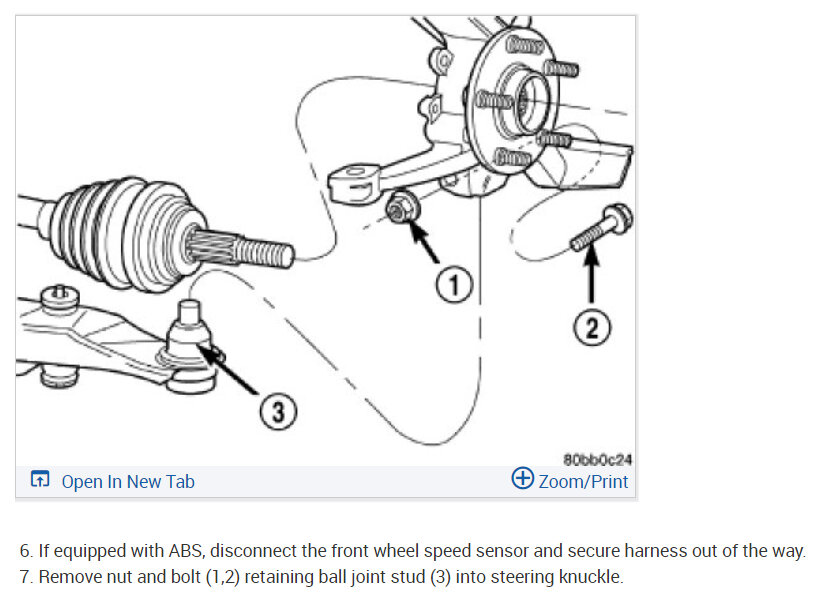

  • 55,851 POSTS

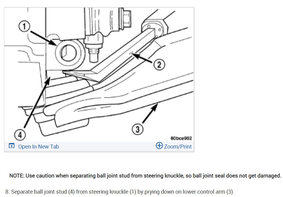

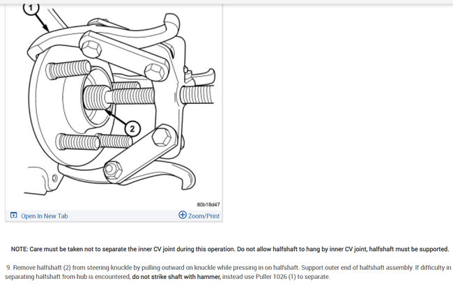

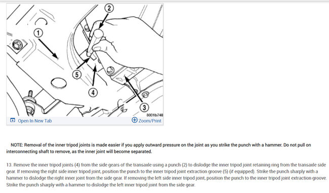

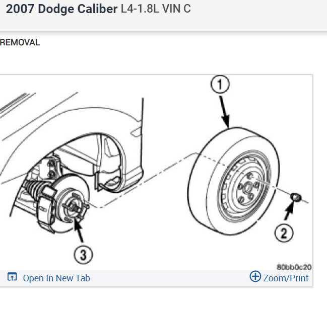

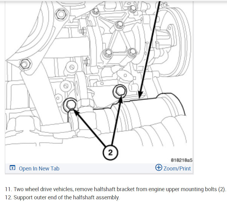

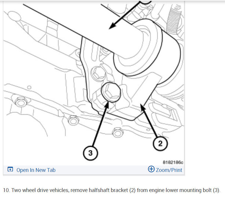

This happens when the CV axles wear out and bind under certain conditions, I would remove them for inspection, check for binding or wear marks on the inner CV cage. Here is a generic guide to help you step by step with instructions in the diagrams below to show you how on your car.
https://www.2carpros.com/articles/replace-cv-axle
