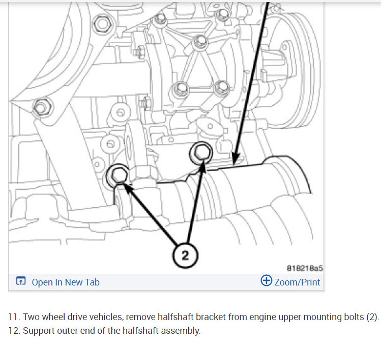

Hello, I've been having an issue with my 07 Caliber. It seems to be having a wobble/uneasy drive when I am going between 20-35 & 50-75. I've tired the tires aligned, balanced twice, and the tie rods looked at, as well at the ball joints. I'd like some help, because when others test drive it they don't seem to feel it. I'm not sure if I'm just sensitive to it or I'm crazy, but it's getting on my last nerve. Any help would be much appreciated.

have axles and mounts checked.

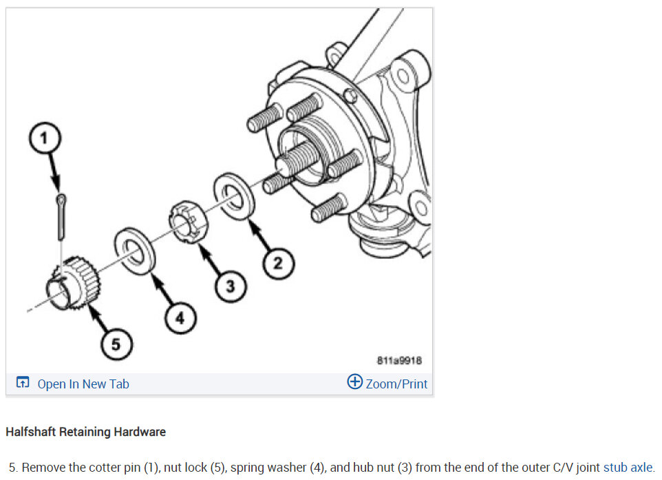

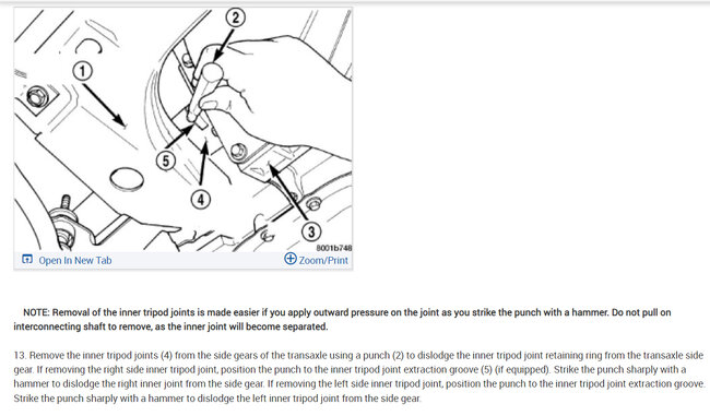

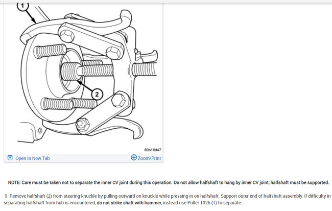

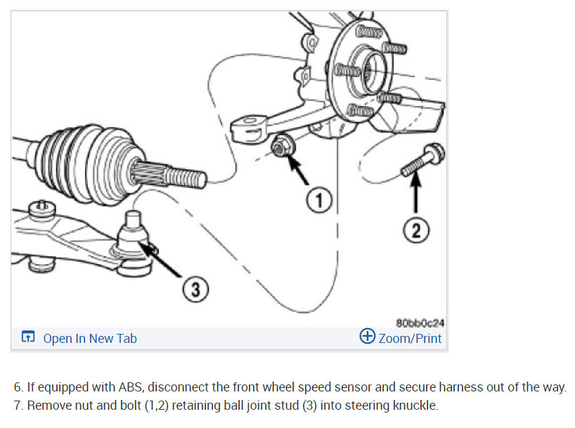

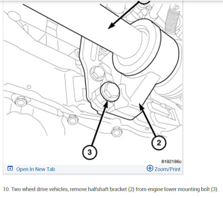

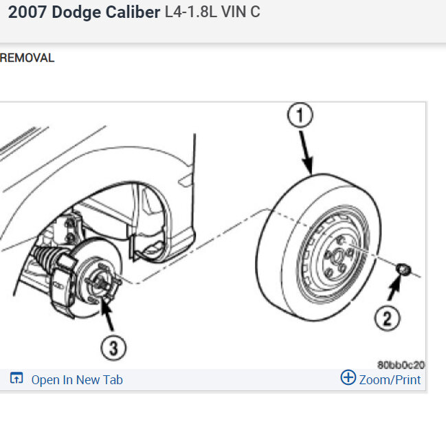

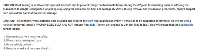

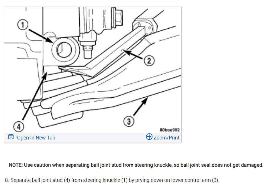

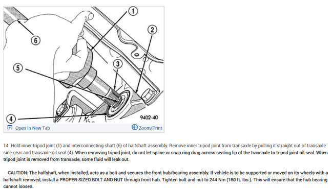

This happens when the CV axles wear out and bind under certain conditions, I would remove them for inspection, check for binding or wear marks on the inner CV cage. Here is a generic guide to help you step by step with instructions in the diagrams below to show you how on your car.
https://www.2carpros.com/articles/replace-cv-axle
