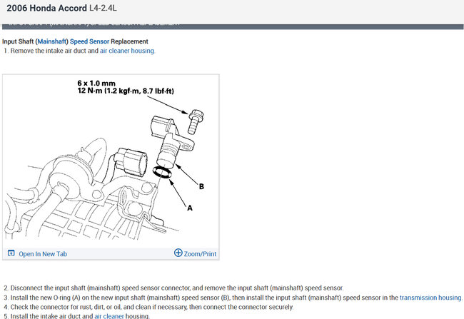

Hello! I bought the car listed above with a 2.4l VTi and engine light popped up when i started the car, also when i turned to bigger street and drive a bit faster (over 40kmh i think) the D started flashing. Mechanic searched for codes and that came up (picture attached). I have driven it a couple of days like that and haven't noticed anything weird from gearbox. After a fresh start, D starts flashing after higher gear change (3rd to 4th i think) i have noticed.

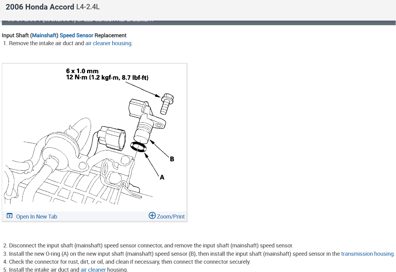

I don't see the image can you please reload it or just tell me? I have seen the input shaft sensor cause this issue, here is the location but it would be better if I had the code. Let us know how it goes Check out the images (below). If you change the sensor out, you need to clear the codes after.
