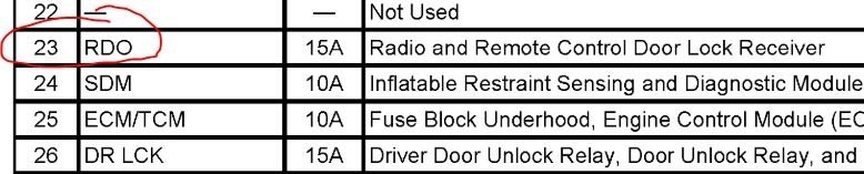

The CD won't eject from the radio.It shows "disc error".Is there a way to get it to eject?You guys are the experts and I always trust your expert advice.Your site is the best.Take care, BOB.

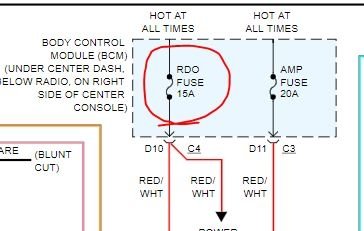

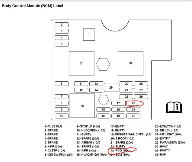

Bob, the only thing I know to remove one is to remove power to the CD player by pulling the fuse. When reinstalled, most times it will eject. I did find the following and it is basically what I have seen done.
STUCK CD'S
Interrupting the battery power by pulling the fuse will sometimes release a stuck CD. If a CD is stuck, and removed, inspect it for warps, cracks, etc.
See pictures for fuse location.
Let me know if that gets it out.
