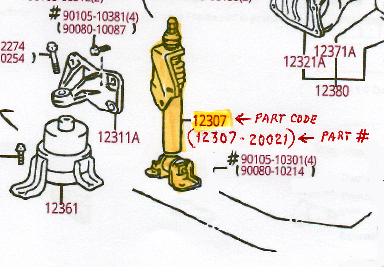

You asking:
Did the vibrations start after the engine mount were replaced?
My answers:
1) No, the dashboard structure vibration/rattle was noticed long before the engine mounts replacement.
2) The dashboard structure vibration/rattle when on brakes at the red light was the reason for the engine mounts replacement.
But that replacement did not help.
I suspect that one of the replacement mounts was defective.
The picture of that part is attached.
Its Toyota original number is 12307-20021, part code 12307.
That motor mount is also called "Engine Shock".
But as I remember, the cylinder and piston of that part were
moving freely up and down without any resistance.
That is not the behavior of shock absorber.
So I will study other equivalent parts for shock absorbing operation (Auto parts Stores and Dealer's place) and will do a new replacement if needed.
3) I agree with your statement:
"To raise the idle of the engine is not logical and will make the car bang when it goes into gear".
Jun 3, 2018 at 3:52 PM
