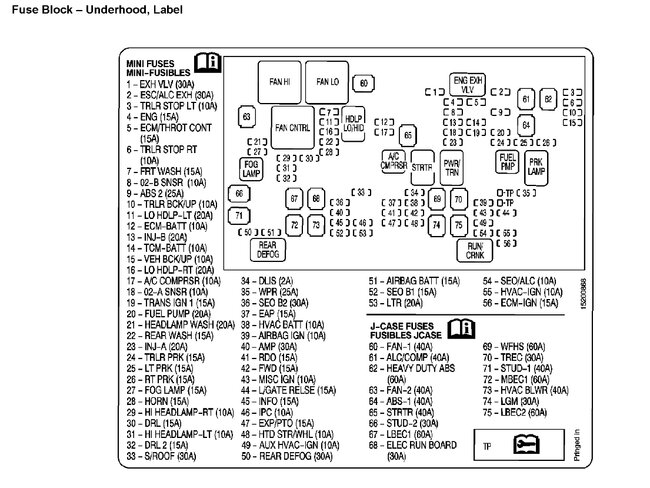

Parking light drivers' side stays on while driving unless you turn it out manually or turn ignition off?
Oct 6, 2022 at 6:33 PM
  • 54,837 POSTS

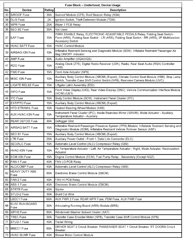

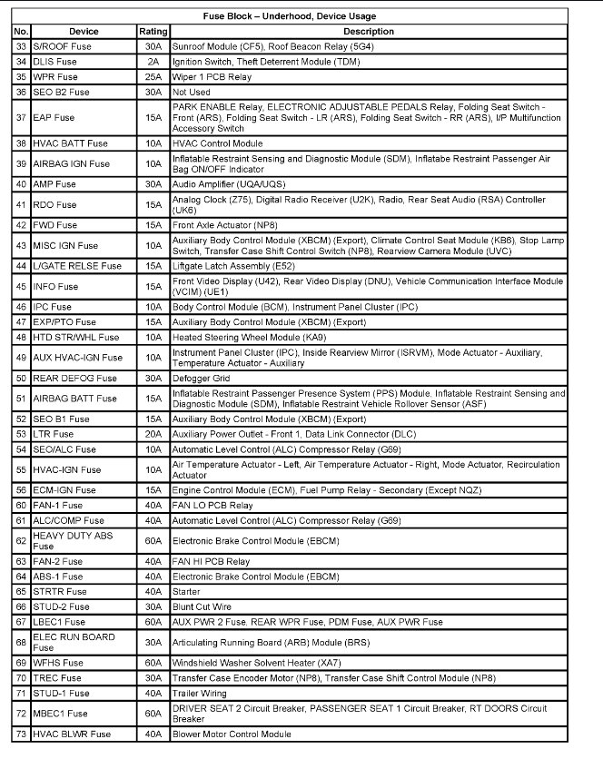

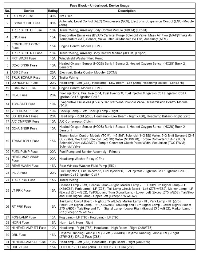

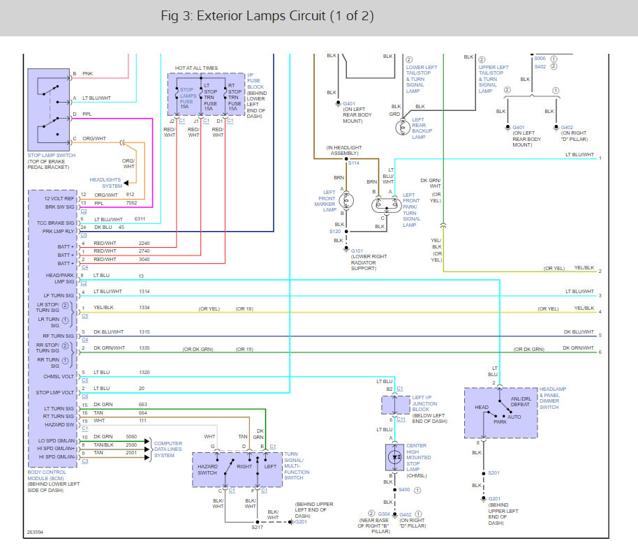

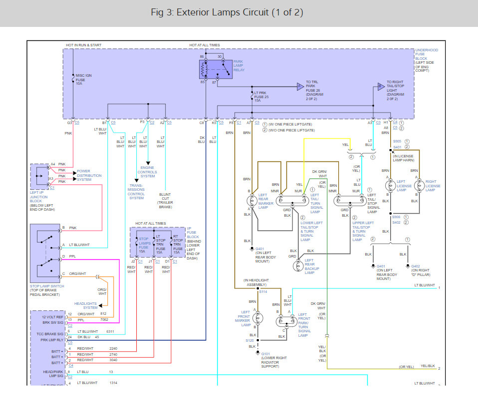

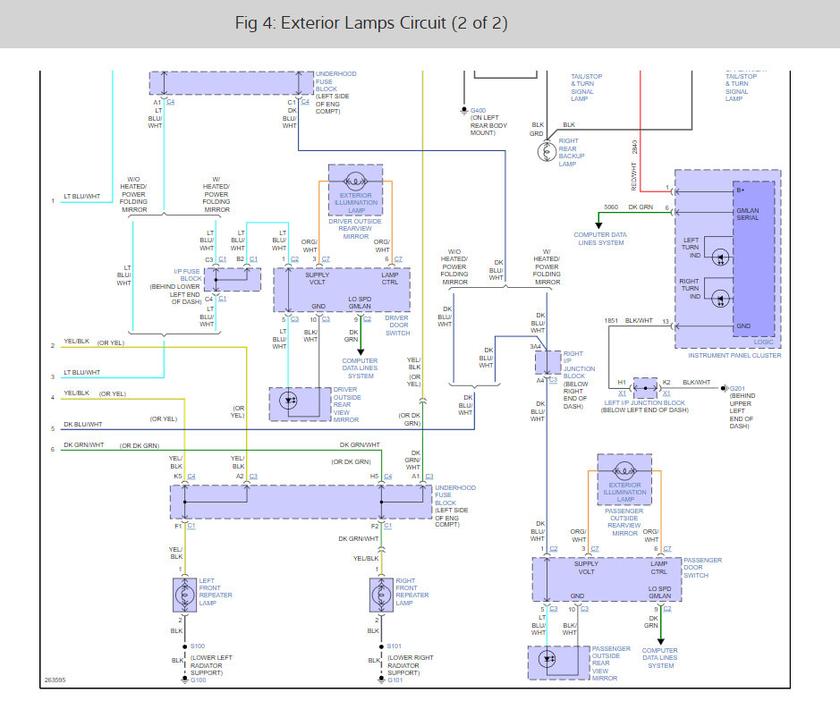

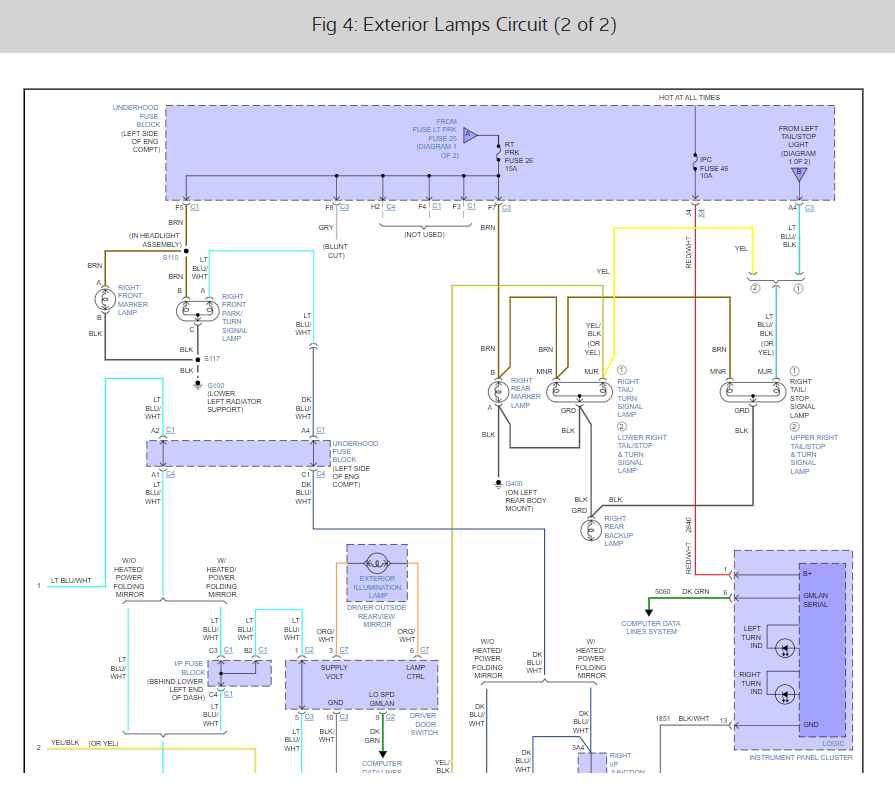

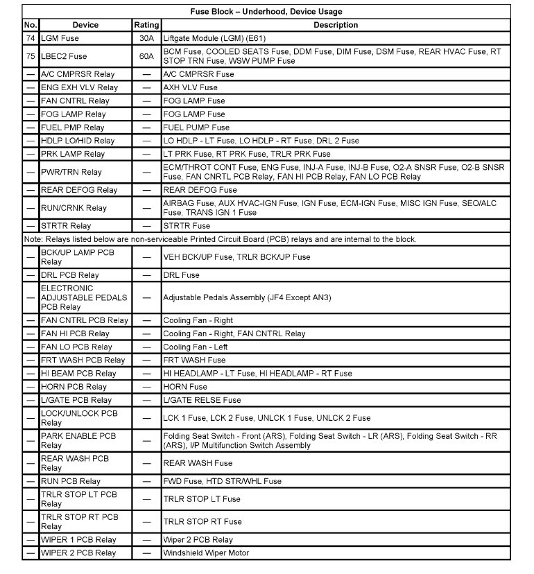

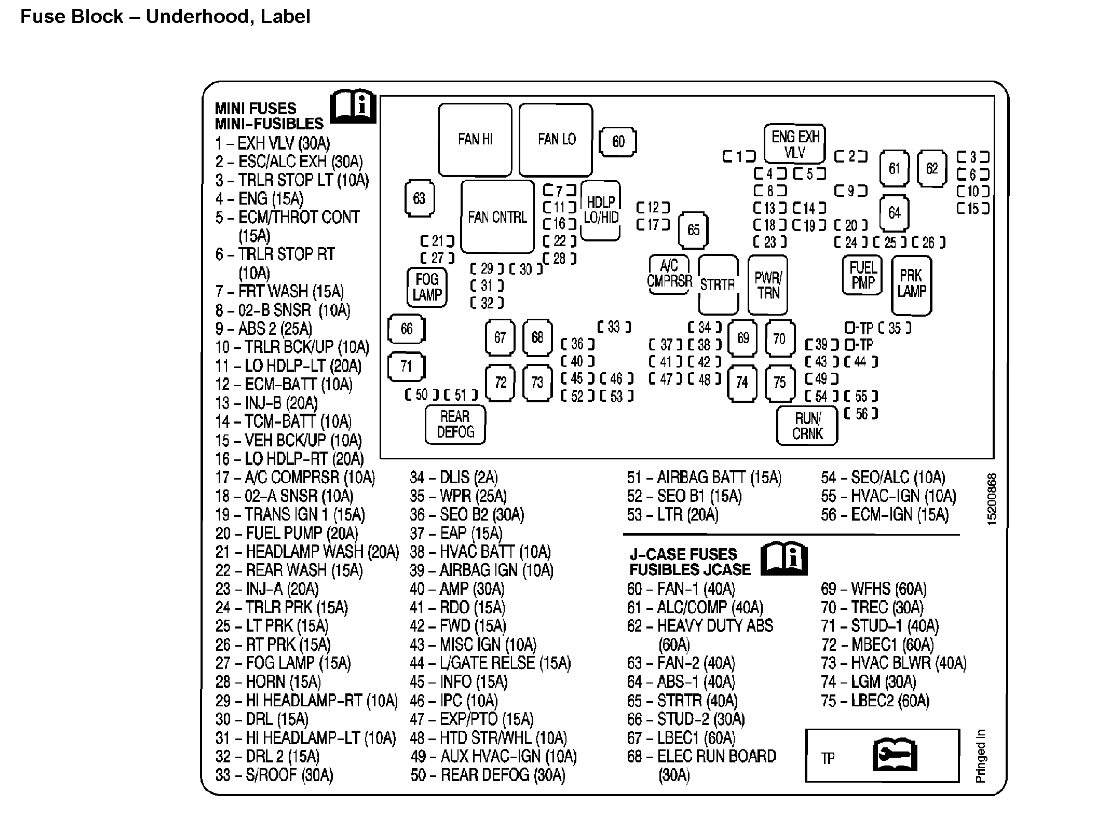

This can happen when there is a fuse out, let's check fuses MISC IGN # 25, #26 and fuse #46 in the under-hood fuse panel (PDC) here is a guide to help and the fuse locations in the images below with the parking lights wiring diagrams so you can see how the system works.

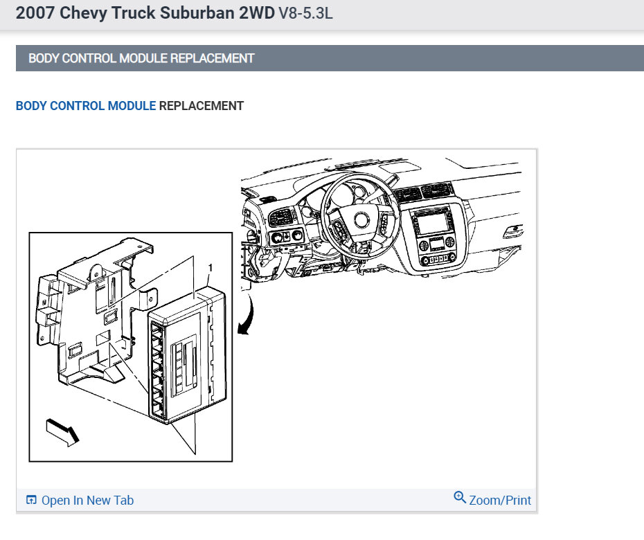

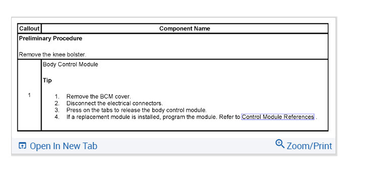

Also, there is a parking light control relay that needs to be checked or swapped out which is in the PDC as well. If everything checks out the BCM is bad and needs to be replaced, which I have included in the instructions in case you need them. You can get a rebuilt BCM by searching Google or eBay, have your VIN ready. Check out the images (below). Please let us know what you find. We are interested to see what it is.
