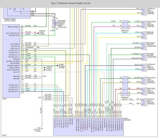

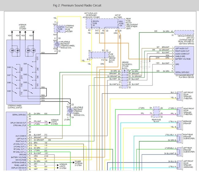

It looks like the CD changer or the amplifier is not turning off, here is a wiring diagram to look over. Try plugging each item one at a time to check if the draw stops.

Thank you for the wiring diagram. I have been looking for this.
