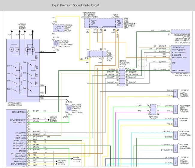

I seem to have a draw on my car battery. I checked my amp draws and came up with .53 and it should be between 30-50. So I started pulling fuses and found the stop fuse dropped to .39 .
This should mean that something in the stop fuse system is drawing some power. Nothing seems to be wrong. All the lights and brakes signals work. Brake switch works. Can anyone make a suggestion? Maybe a body control module (BCM) shorted? But where would that be.
The battery drains after about three days to a dead battery. I cannot find where the draw is in that circuit. 0.53 miliamps. The readings were taken after the car went to sleep. About fifteen seconds.I did not turn on the ignition to do the test. I just made sure the battery was charged.

It seems the draw was from the cd/pn fuse. I have no cd player in trunk or telephone. After I pulled the fuse under the back seat the meter finally settled at .02 milliampes before that is was at .52 milliamp . The cd player and radio in the car work fine.
So something is draining from this circuit but nothing is attached. Anyways thank you for your help.

It looks like the CD changer or the amplifier is not turning off, here is a wiring diagram to look over. Try plugging each item one at a time to check if the draw stops.

Thank you for the wiring diagram. I have been looking for this.
