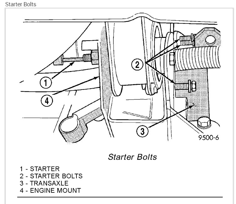

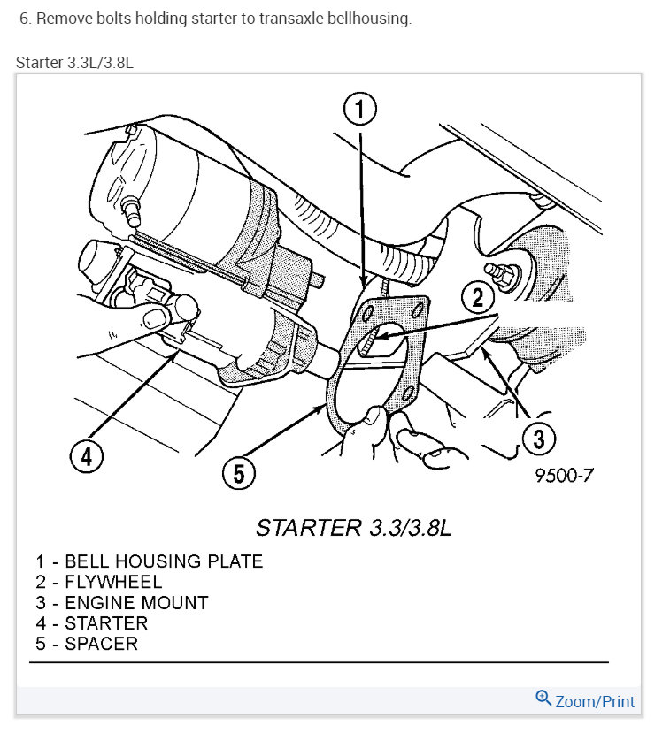

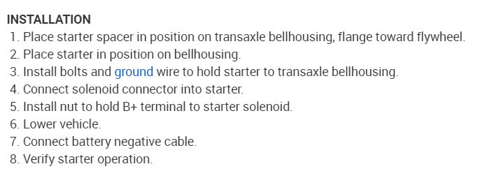

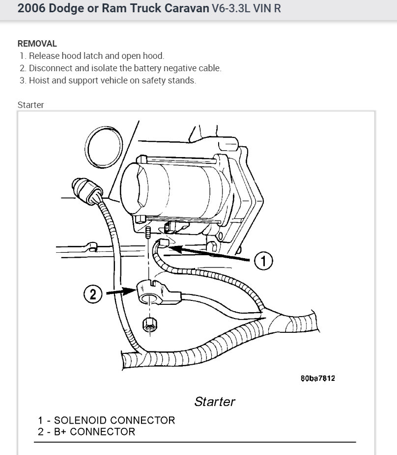

Sounds good you do the same. I would remove the starter just to check to see if the pinon gear just flops around and is not held is the starter. Here is a guide to help you see what you are in for when removing the starter for inspection and diagrams below to show you on your car:
Check out the diagrams (below). Please let us know what you find.
