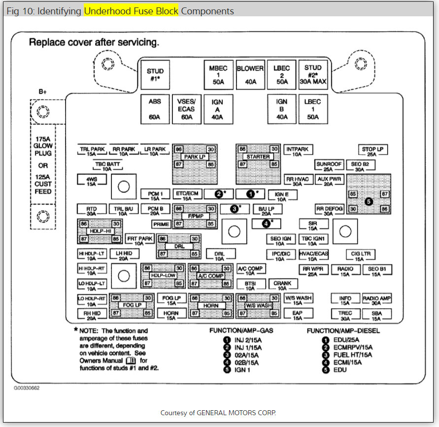

air bag light on. interior and bed light not working. ac not blowing cold air?
Jun 16, 2023 at 3:50 PM
  • 55,249 POSTS

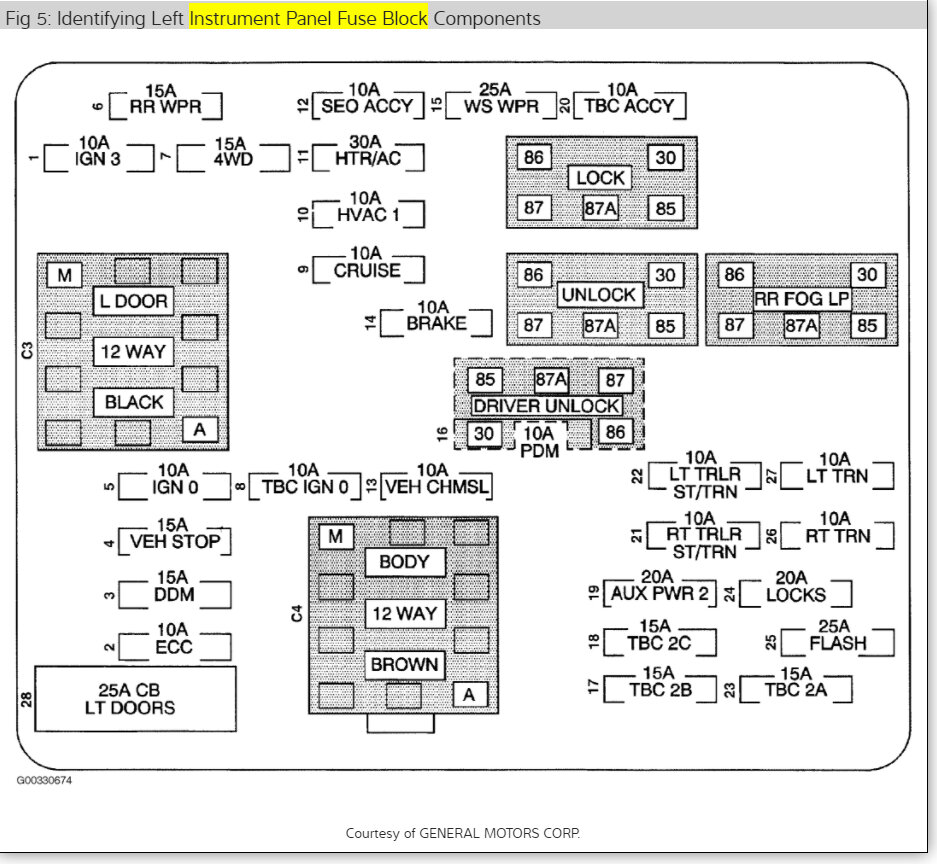

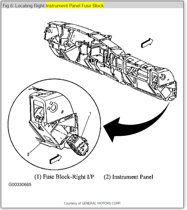

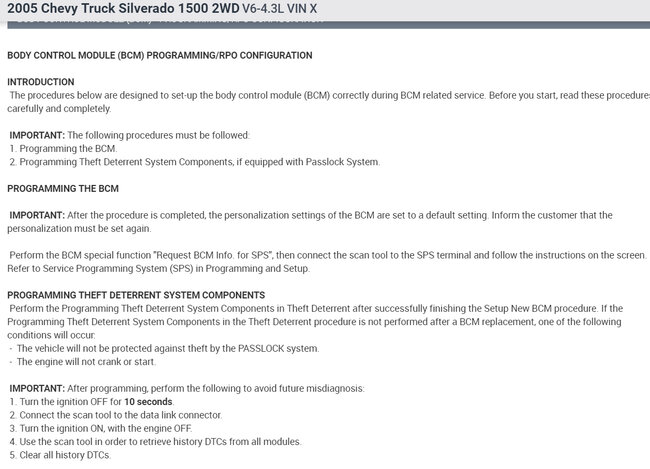

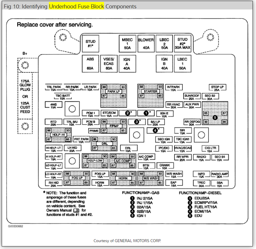

It sounds like the BCM has gone out, but to be sure we should check all fuses first here is a guide to help with the fuse locations in the images below. Please check the fuses with the key on.
If all fuses are okay, I would run a CAN scan to see if the BCM code comes up, you can get a CAN scanner (Controller Area Network) which will work on most cars from Amazon.
https://youtu.be/u-4syLc-ifQ

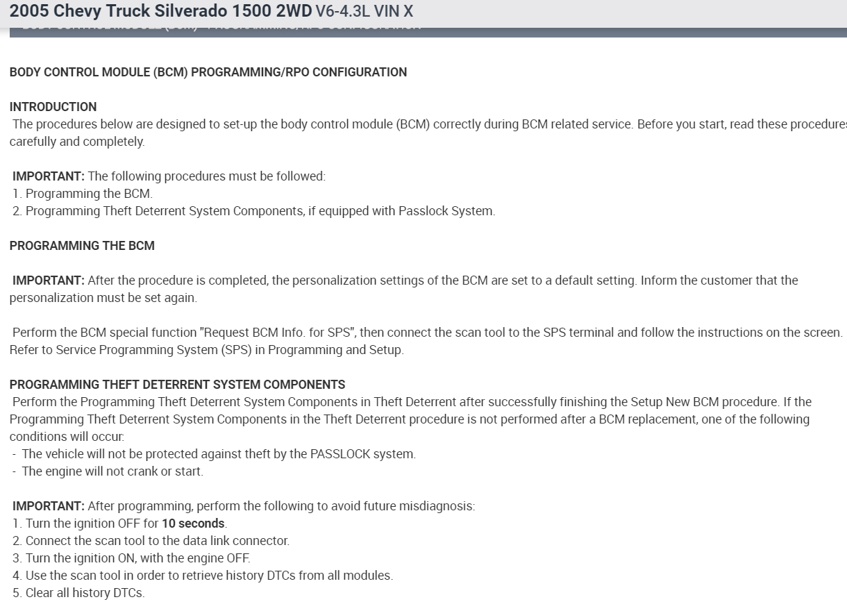

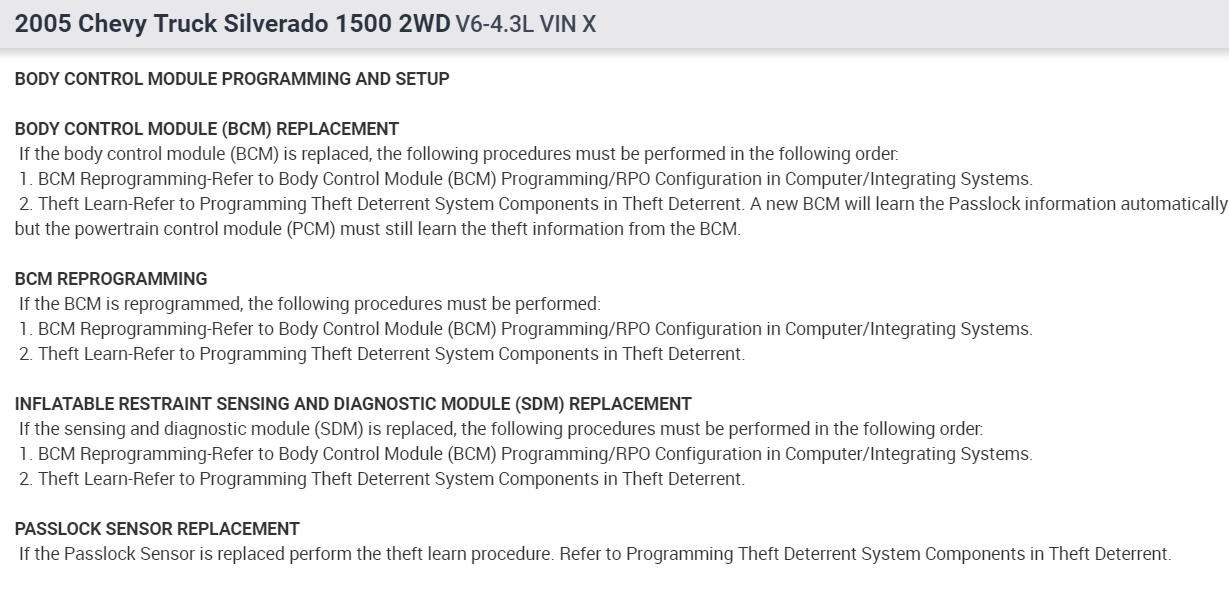

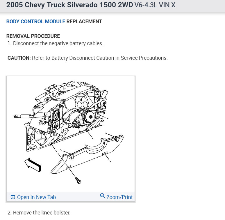

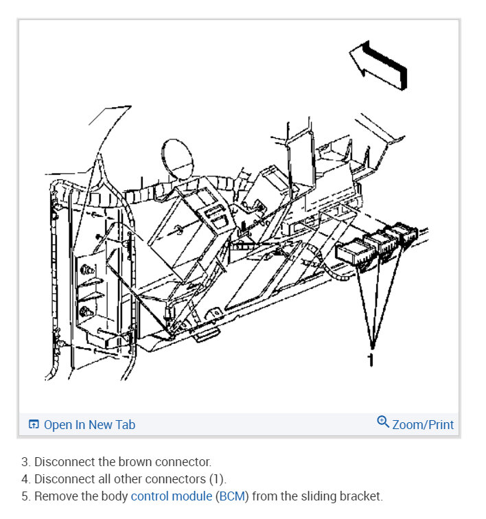

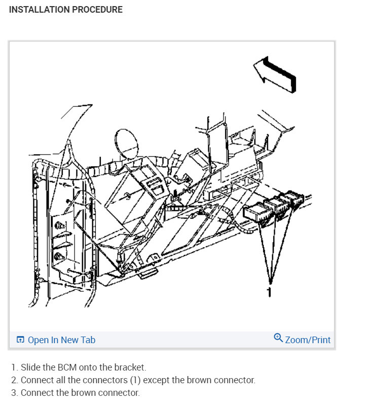

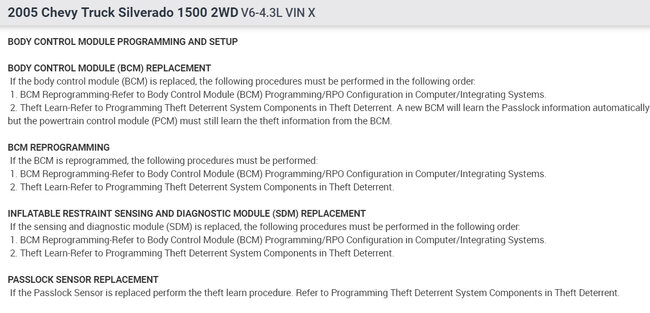

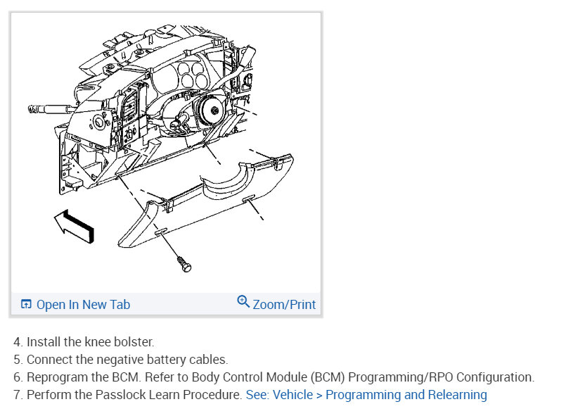

Here is how to change the BCM out in case you need it as well, you can get a preprogrammed unit by searching Google or Ebay. Check out the images (below). Let us know what happens and please upload pictures or videos of the problem so we can see what's going on.
