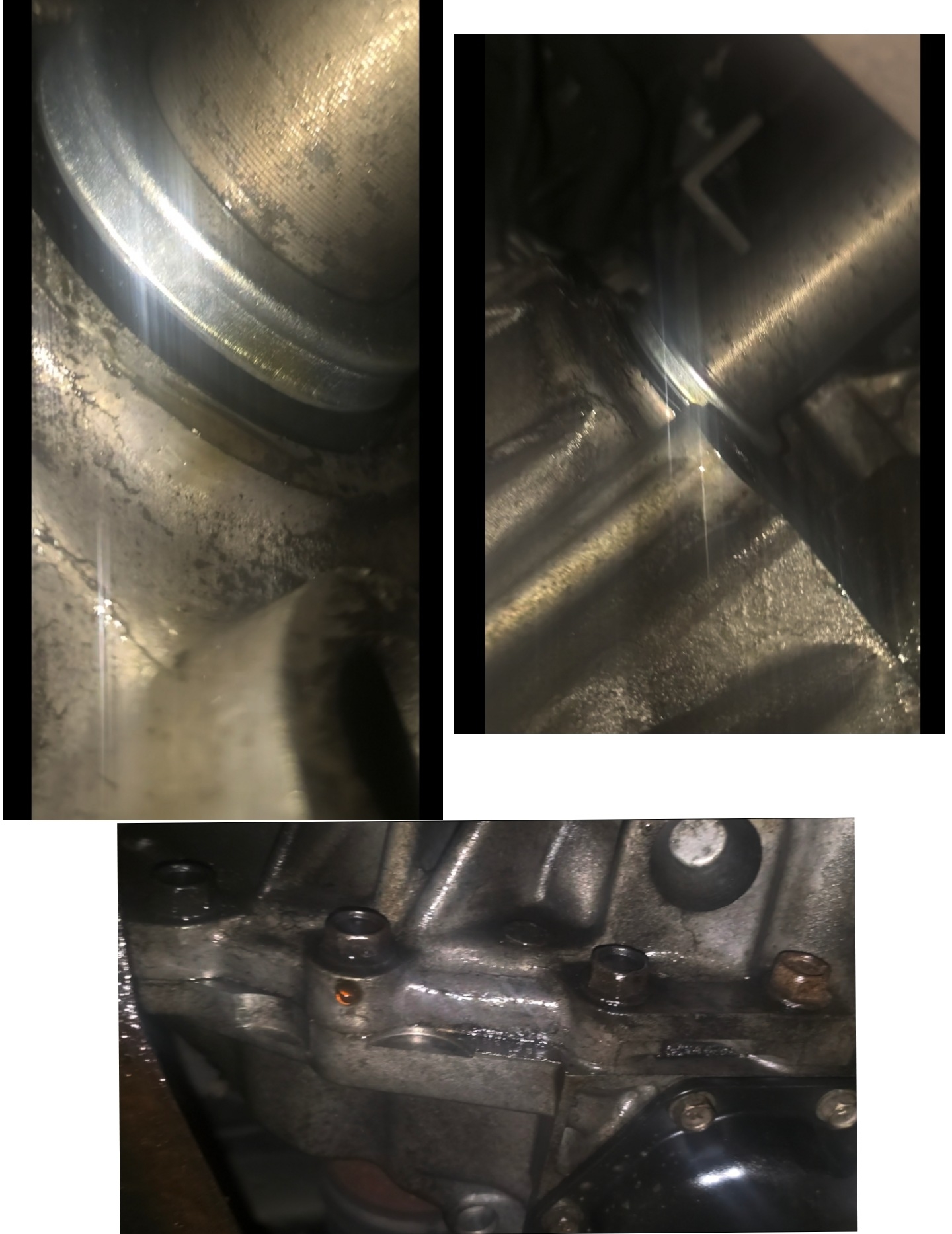

My car is leaking a little bit of transmission fluid it looks like it is coming from where the axle meets or connects to the transmission.
Mar 11, 2021 at 4:28 AM
  • 110,244 POSTS
I looked at your pics and agree. It looks like the axle seal is leaking. Actually, it's called a differential seal.
To replace it, you need to first remove the axle assembly. I will provide directions for both. First, I will give you the directions for removal. Looking at the pic, I believe it is the passenger side I'm seeing. If that isn't correct, let me know.

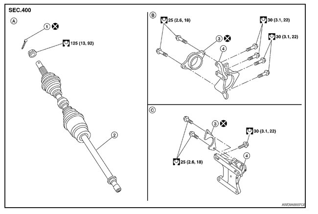

Exploded View FAX-10 (Part 1)
pic 1

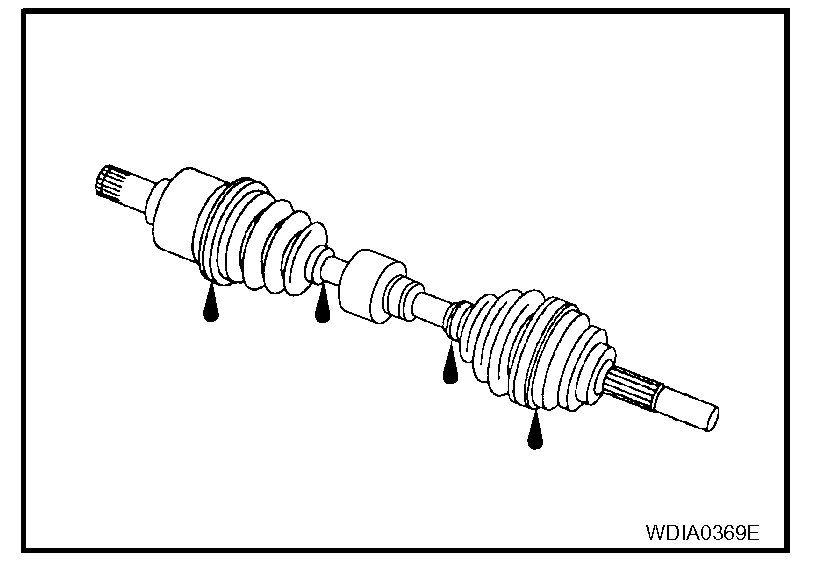

Exploded View FAX-10 (Part 2)
pic 2

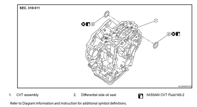

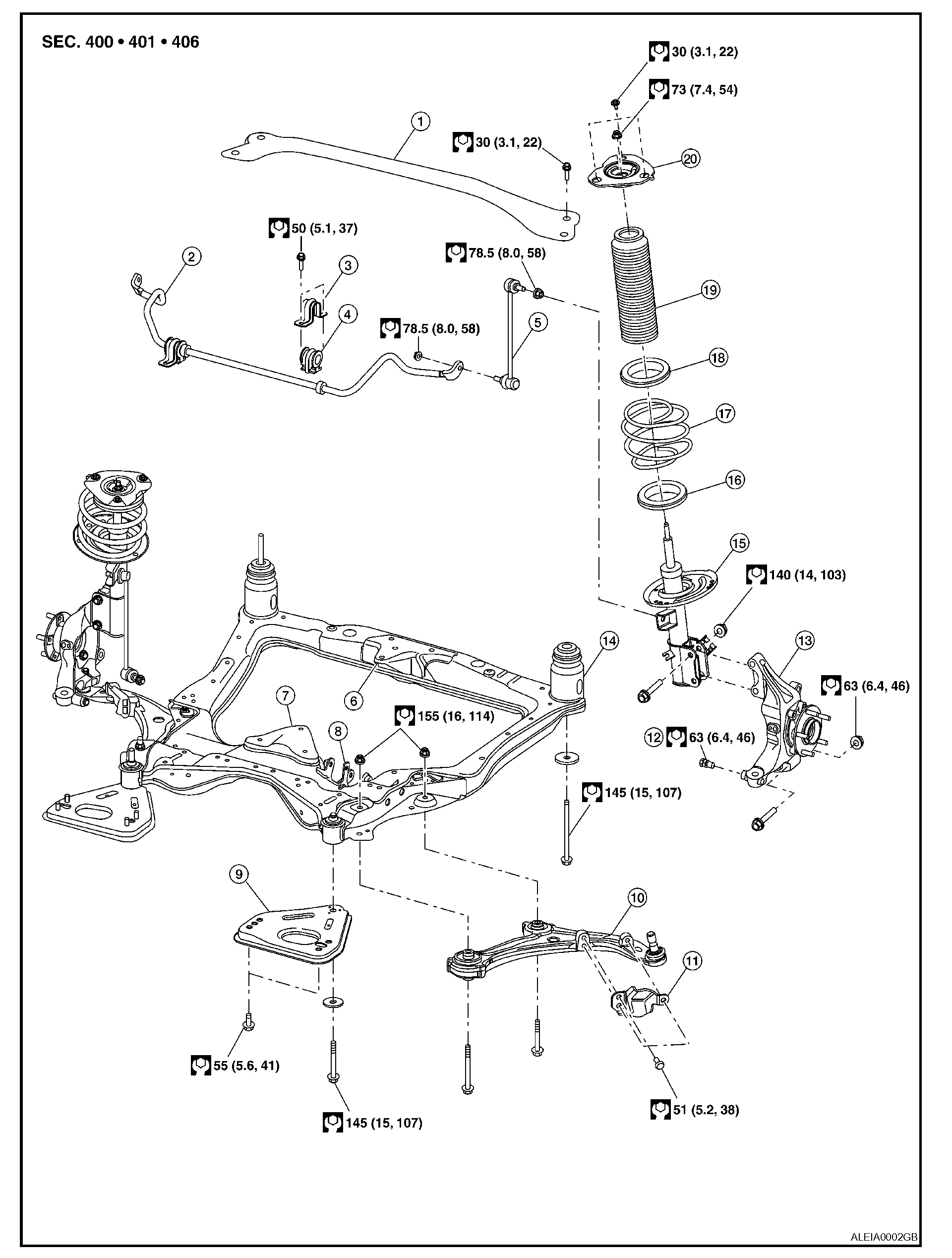

Exploded View FSU-13 (Part 1)
pic 3

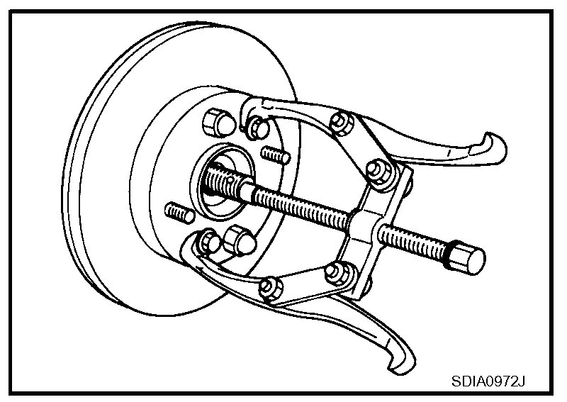

Exploded View FSU-13 (Part 2)
pic 4

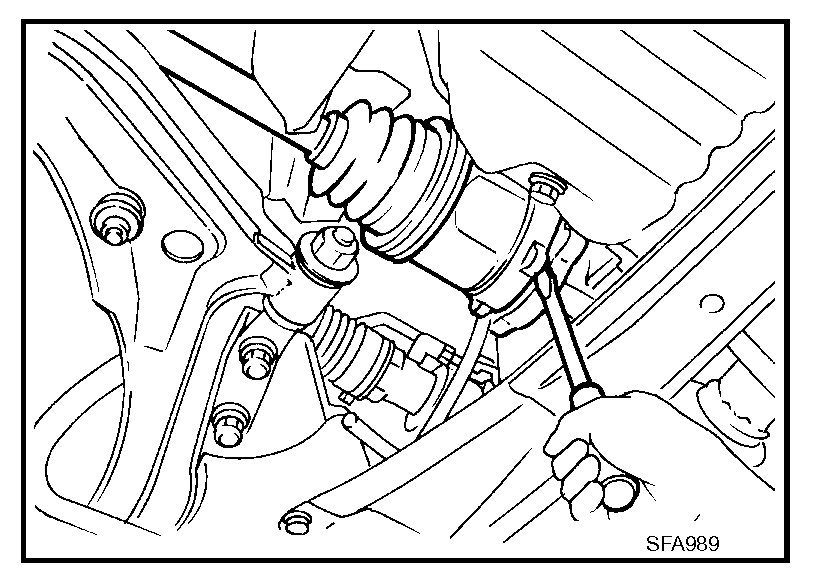

5. Remove the lower ball joint pinch bolt using power tool, then separate lower ball joint from steering knuckle. Refer to Exploded View FSU-13.
pic 5

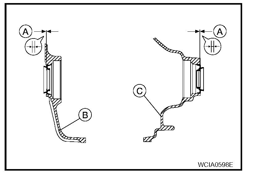

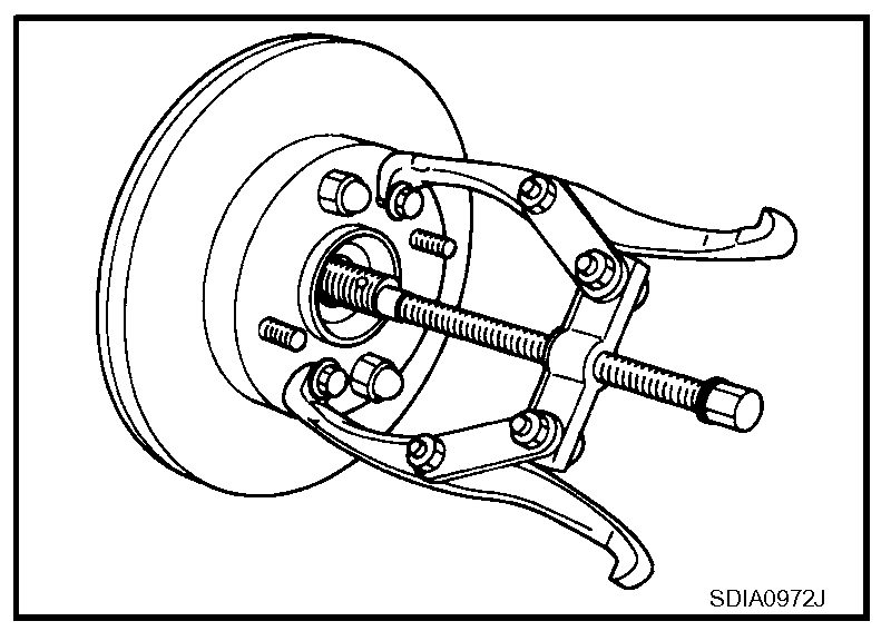

6. Remove drive shaft from wheel hub and bearing assembly, using a puller or suitable tool.
CAUTION: When removing drive shaft, do not apply an excessive angle to drive shaft joint. Also be careful not to excessively extend slide joint.
pic 6

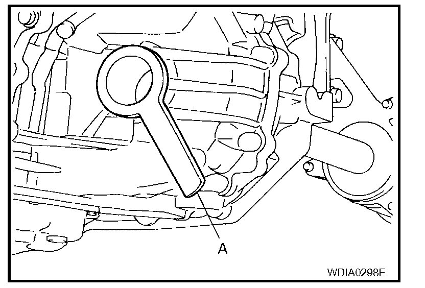

^ In order to prevent damage to differential side oil seal, place Tool "A" onto oil seal before inserting drive shaft as shown. Slide drive shaft into slide joint and tap with a hammer to install securely.
Tool number: KV38106800 (J-34297)

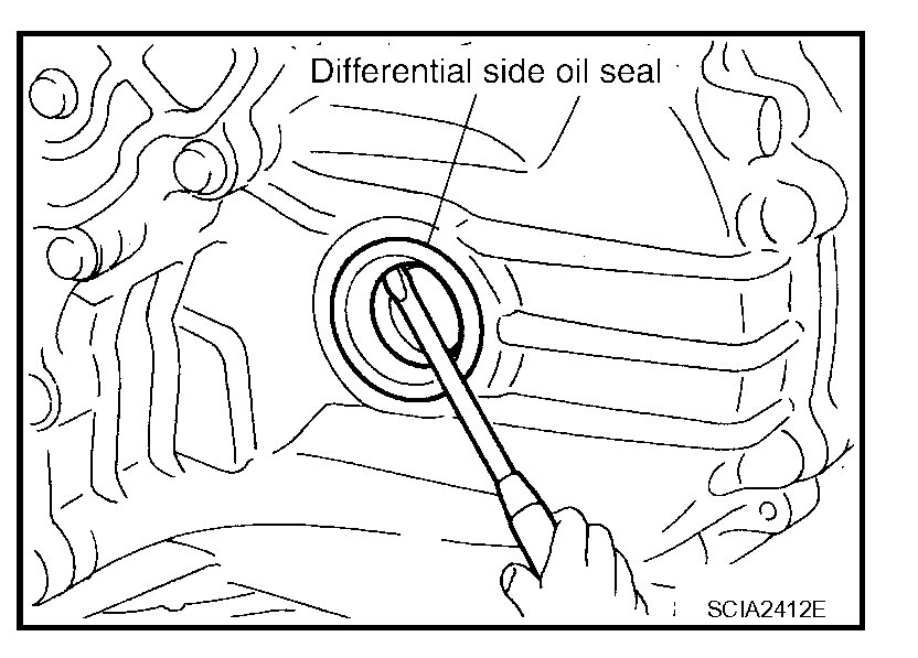

DIFFERENTIAL SIDE OIL SEAL
Exploded View TM-386
pic 8
Removal and Installation
REMOVAL
pic 9
1. Remove drive shaft assembly.
2. Remove the differential side oil seal using suitable tool
CAUTION: Do not scratch transaxle case or converter housing.
INSTALLATION
pic 10
1. Drive the new differential side oil seal into the transaxle case side (B) and converter housing side (C) until it is flush using suitable tool.
Dimension A: 0 ± 0.5 mm (0 ± 0.020 in)
CAUTION:
^ Do not reuse differential side oil seals.
^ Apply specified NISSAN CVT fluid to side oil seals.
2. Install drive shaft assembly.
3. Check CVT fluid level.
