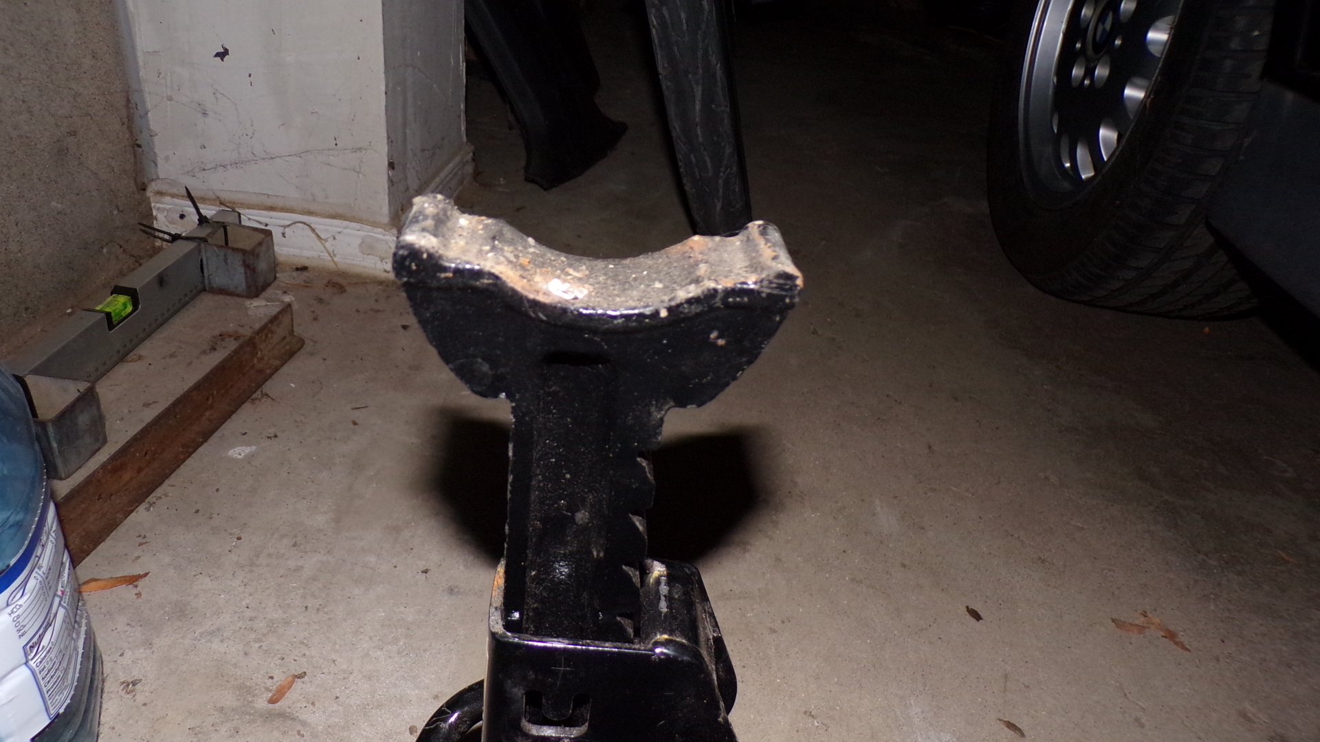

I have always wondered why the ends of hydraulic car jacks and mechanical jack stands had such weird shapes for the car to rest on.

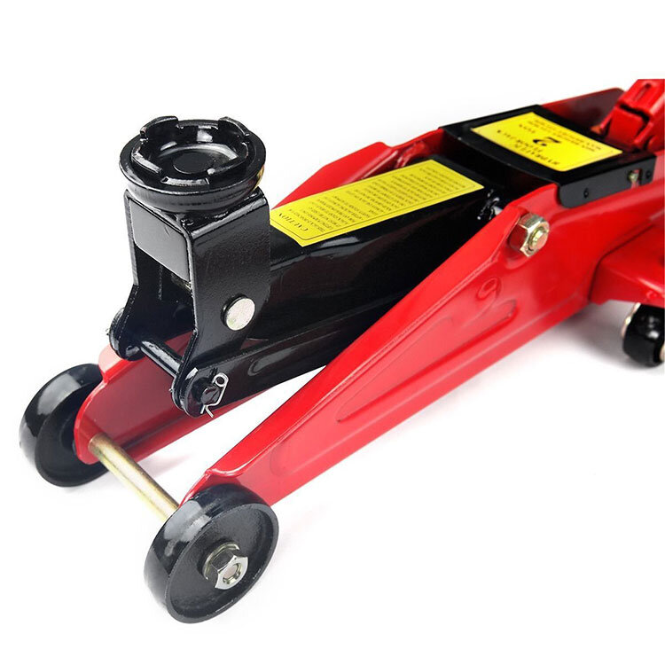

The jack stand shown has an end shape that is just about standard across all jack stands and I have never been able to find a spot on the chassis where I was comfortable in placing one of these. The hydraulic jack end/cup is also just about standard on inexpensive hydraulic jacks. This one is a bit more logical as on a BMW E36 it comes with jack placers made out of plastic that push in to holes underneath the jacking points on the side of the car. But even so, they are still not secure, usually with the car resting on just one or two of the protruding 'tabs' on the edge of the cup, and a bit precarious to use.
Can you shed some light on this?

The top saddles for both were designed long ago for use when cars had real frames and solid axles. At that time, you could put the jack under a spring perch and lift the car, then slip the jack stand into place under the axle tube or the frame rail and support the vehicle. As times have changed to now where there are no real full framed cars, and many are lifted using the pinch welds or small jack points you have to get a bit creative as to where you can lift the vehicle and the same for locating jack stands. Many will show the jack or lift locations in the owner's manual or service information. In my case I tend to use simple processes. Namely if the vehicle has a suspension, it has to have mounting points for that suspension. Say where an A arm or trailing arm is attached to a subframe. As those parts are designed to support the vehicle using the suspension itself, they should also be capable of lifting and supporting it with a jack and stands.
Now on newer jack stands you will usually find a notch in the top saddle, the idea of that notch is that you can use it where the pinch welds are located, the problem there is that most of them are not ground very well and instead of supporting a wider area they crush the pinch welds due to a small surface area. In those cases I avoid the pinch welds if possible or if I have no choice I grab a flat saddle floor jack, not one with a cup like the one shown but a wide flat rubber surface, I have also added a rubber pad to the older jacks as well, and for that a very easy item to use are hockey pucks.
Keep in mind though that for the most part, companies don't intend on having the average person working on their vehicles with a floor jack and stands, they design them so they can be put on a lift instead.
