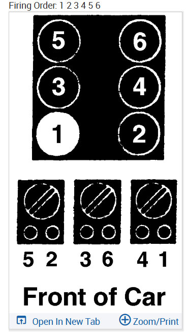

I’m needing a diagram of the sequence of the spark plug wiring.

Sure, here is the firing order for the 3.2 liter. Check out the images (below). Let us know if you need anything else.
