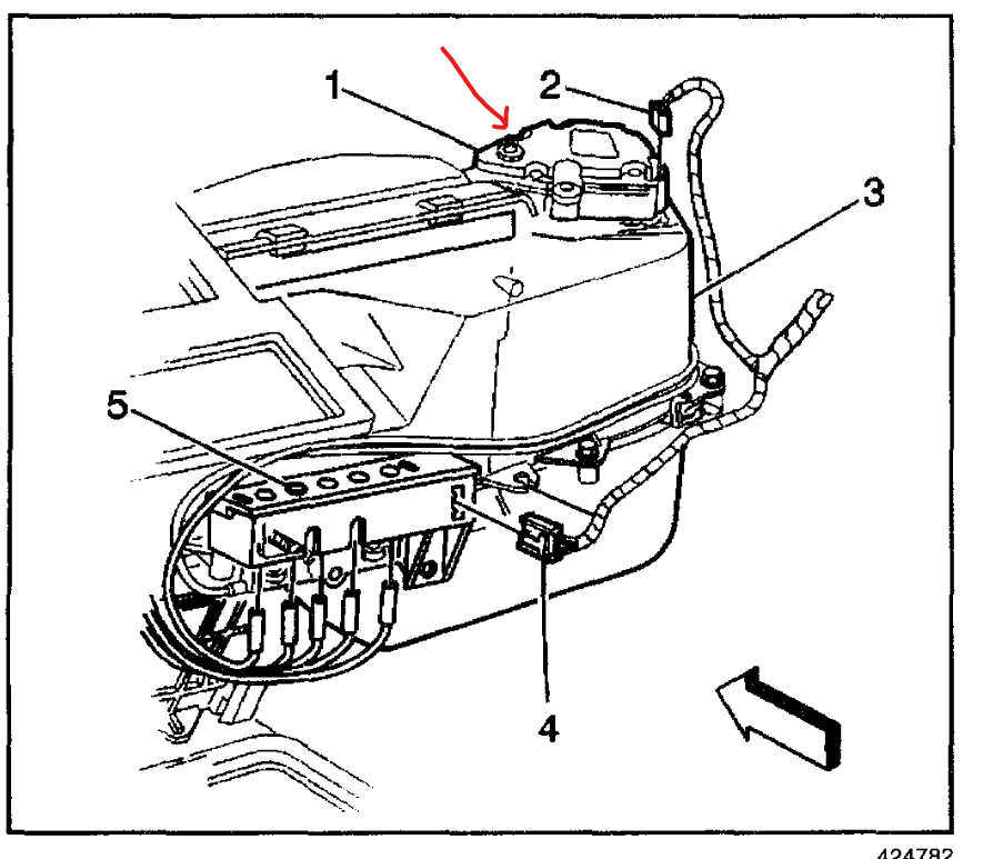

Just recharged the A/C unit. When i am driving, i always get heat on the floor vent. And when i put the A/C on, all i get is very hot air blowing, not cold. I replaced all the vacuum lines in the engine area, checked all the actuators inside the dash, even used a vacuum tester to make sure they are all working. Once i hear clicking noise after i replaced the blend door actuator and looked and seen that it looked like it opened up or came apart. What a headache replacing that. So, i replace it again to see if this is the problem with the A/C unit not blowing cold air? i can do this again if i have to.... Main reason i need the A/C working. thanks for any help.

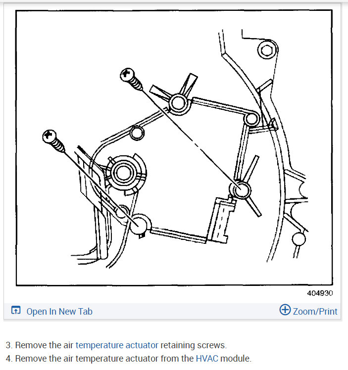

The actuator clicking is telling you it is not working but to be sure I would remove the temperature blend door actuator and move the blend door pivot by hand with the A/C system on to see if the vent air temperature changes. Are you sure the A/C system is getting cold? With the A/C system on, check the temperature of the outlet tube to the compressor at the firewall to see if it is cold. Please go over this guide:
Here is the location of the temperature blend door actuator so we can be on the same page. Also, the actuator must be calibrated:
Use the following steps to perform the calibration update:
1. Turn OFF the ignition.
2. Remove the battery positive voltage circuit fuse of the HVAC Control Module.
IMPORTANT: The module memory will not clear if the battery positive voltage circuit fuse is installed in less than 60 seconds.
3. Wait 60 seconds.
4. Install the fuse.
Check out the images (below). Please upload pictures or videos in your response to any problems so we can see what to help you with.
