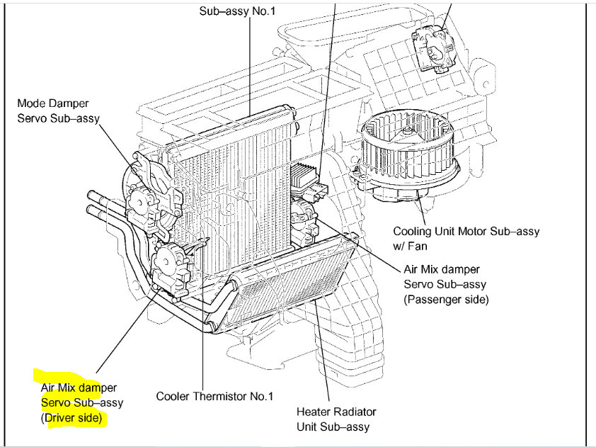

There are two air mix dampers (blend air door actuators) on this vehicle. One is for the passenger side (which appears to be working properly). You indicated that the actuator is moving. Did you check the one on the driver's side?
I attached a pic below showing the location. Let me know if this has been done.
See pic below.

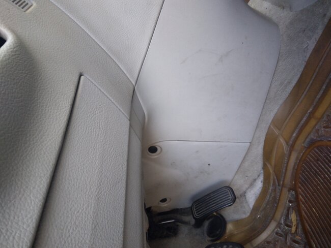

In the attached photo you see the gas pedal. You may have to rotate the picture 90 degrees to make sense of it. To the right of it, is a small panel with 2 black clips. I can take that panel out. But I want to get to the driver side A/C actuator. The diagrams don't show exactly where it is, so I may have to take off the panel to the right of the small panel mentioned above. That is the one I can't figure out how to take out if I need to.
Mar 26, 2023 at 10:11 AM
  • 110,248 POSTS
If you remove that panel, you should be able to access it. In the pic I attached above, it doesn't appear very high up. When you remove the one panel, are you able to see up inside where the HVAC box is located?
The other panel you are referring to shouldn't have anything to do with it. If I am seeing it correctly, that likely has screws holding it in place that are hidden under plastic covers.

Thanks for the update. And I agree. There is no room. If you look at the pic I attached above, see if that can help you locate the actuator.
I look forward to hearing from you. I'm interested in knowing if you are able to replace it.

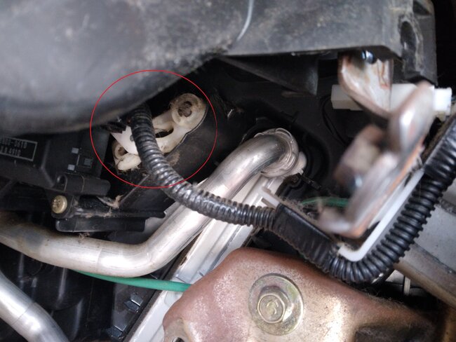

I finally took apart the covers that hid the actuator. I am attaching 2 pictures of what I saw. Interestingly, the actuator moves when I change the temp from low to high. The pictures show when the arm is up and when it is down.
So, if the actuator is working, we're back to square one. What can be causing the A/C not to work on the driver's side?

Here is the 2nd picture (it only allows one at a time).

As far as the cooling fans are concerned, it is normal for one to come on with the AC. That is referred to as a condenser fan. The other fan will come on when a specific engine temp is reached to help cool down the engine coolant.
If the air temp actuator is working, the next question is if something broke that connects the door and the actuator.

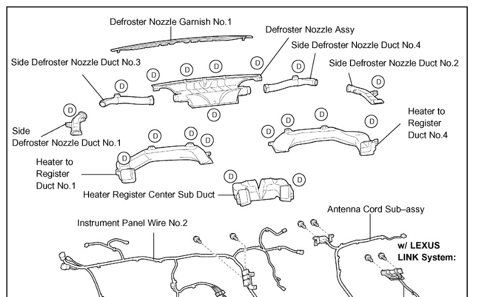

I tried to get to all screws holding the actuator but there is a black plastic vent in the way. It is for the air to warm or cool the feet. I could not get it to come out. I unbolted it with the one bolt in the front, but it still does not come out. I'm missing something in how it is held in. But that's in the way. Now that I know how to take everything apart, I feel comfortable doing it.
Any thoughts on the getting out the plastic vent?

Do me a favor. Take a look at the attached pic and let me know which one is in your way. Some of these require the use of a screwdriver to lever up the 2 claws on the body from inside the register.
See pic below.
