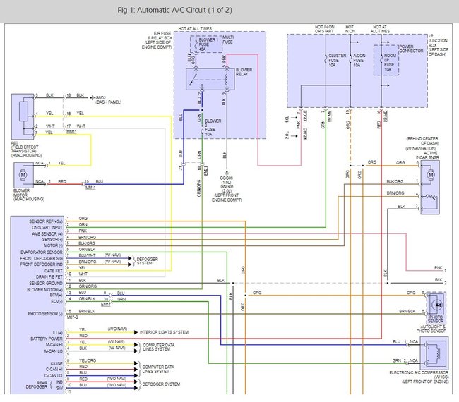

No air is coming out of the vents. The compressor is working, but there is no air. I changed the blower motor, still nothing. I thought it could be the resistor, bought a new one put it on and still nothing. I do not know what else it could be. The fuses are fine but the blower just does not turn on.

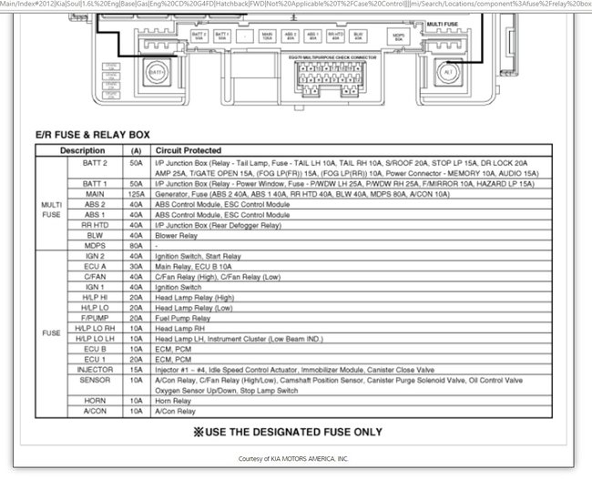

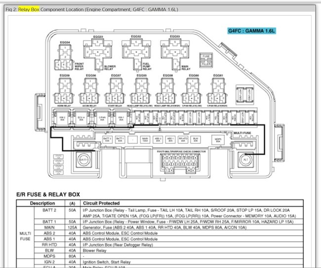

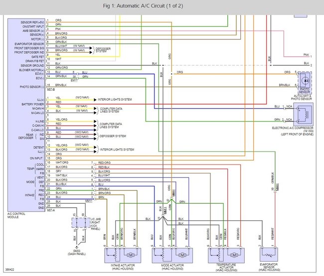

There is a blower motor relay that sounds like it has gone out. Here is a guide that will help you test the relay and a wiring diagram (below) to show you how the circuit works.
and
Please run some tests and get back to us we are interested to see what it is.

Thank you so much, had I known about you it would have saved me a ton of trouble with the removal of the blower. Changed the relay, it was fried literally, and wam bam it worked!!
