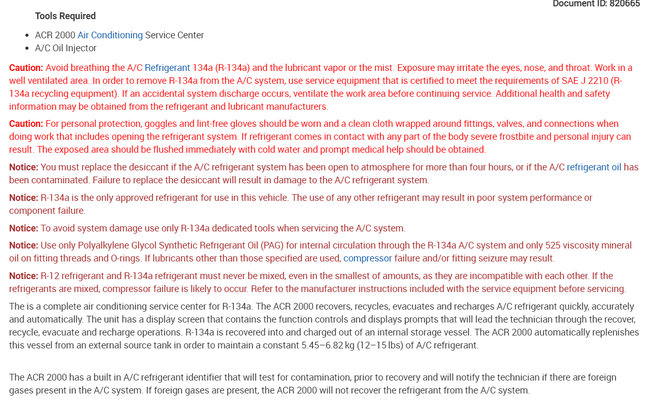

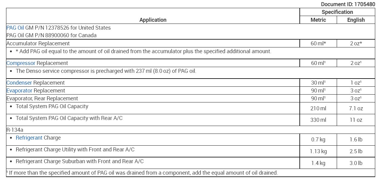

I need to know how much pag oil and Freon my truck listed above 1500 Classic crew cab will hold? Also, I had a Schrader valve go bad which leaked all the Freon out. Well, I pulled a vacuum on the system after i replaced the valve and when it got time to recharge the Freon would go in. Please someone tell me how to fix this!

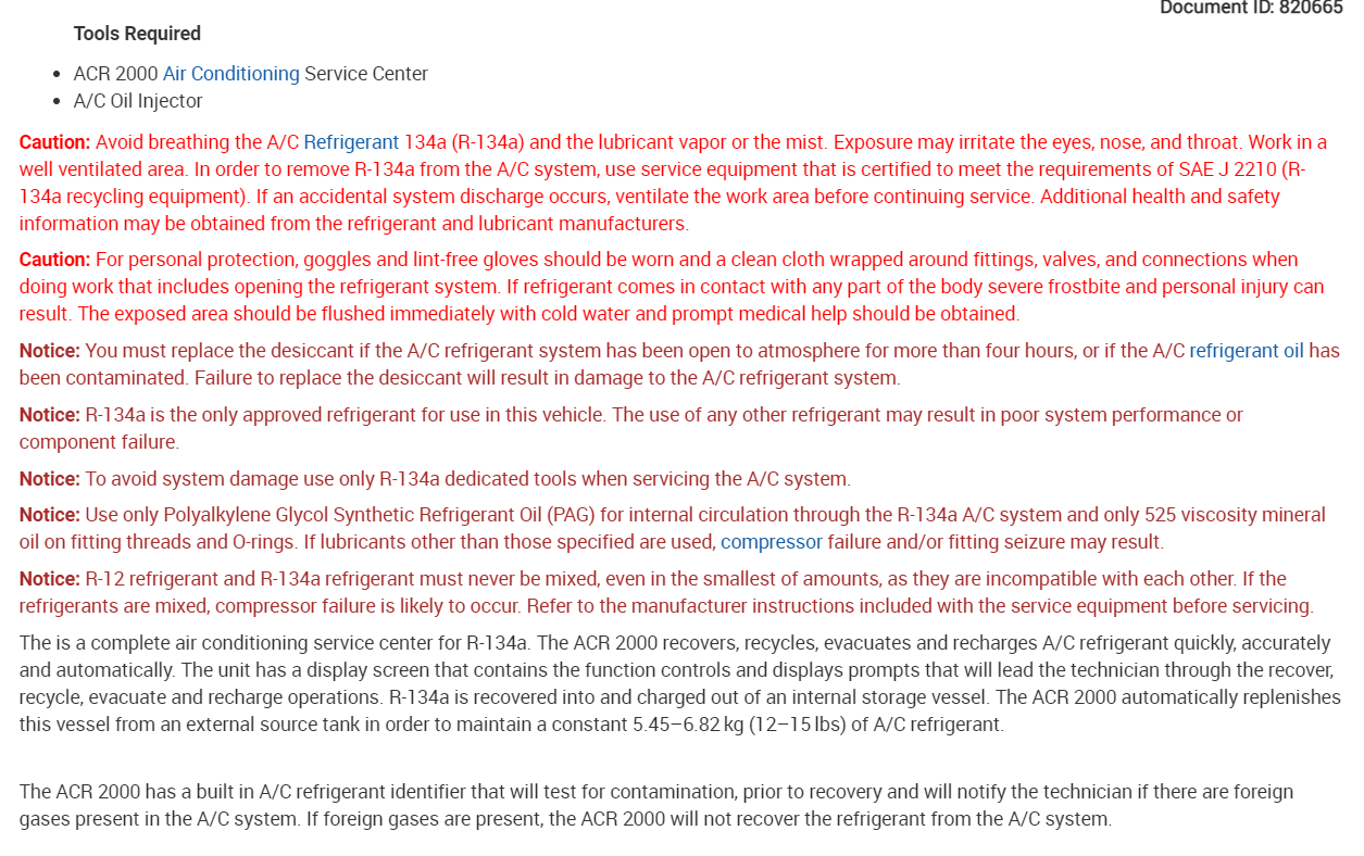

If no oil comes out when the refrigerant, we lost none needs to be added. This is all the manual says in the images below. Check out the diagrams (below). Please let us know what happens.
