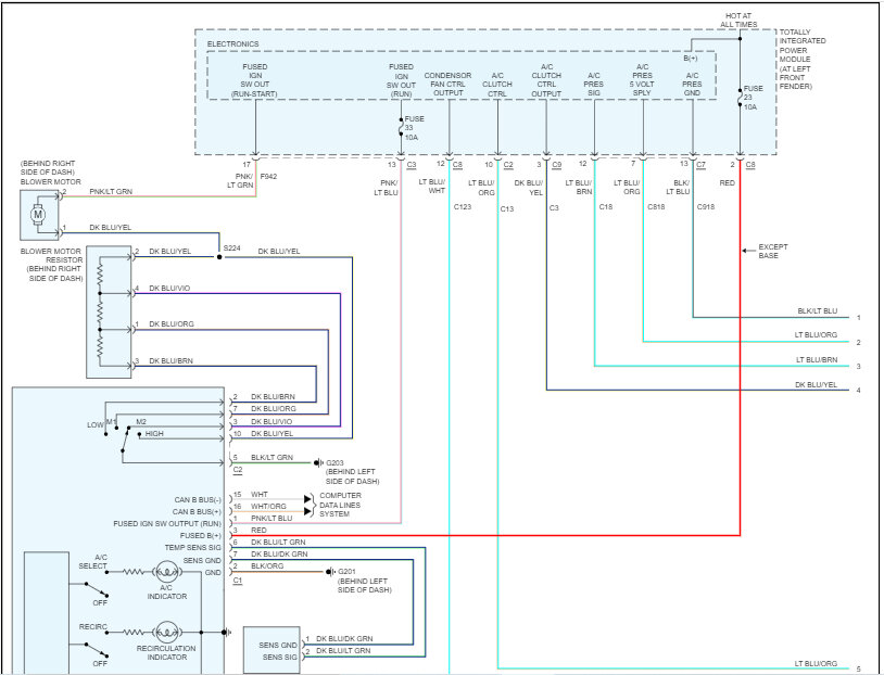

A/C Wiring Diagram needed?
2007 DODGE TRUCK
177,000 MILES • 3.7L • V6 • 2WD • AUTOMATIC
JOHNSTRAWSER
The button that turns on the A/C is not working neither is the nob that controls where the air goes. A wiring diagram would help.
Aug 24, 2023 at 9:21 AM
  • 110,240 POSTS

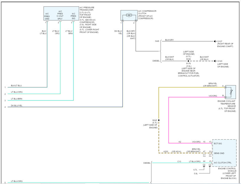

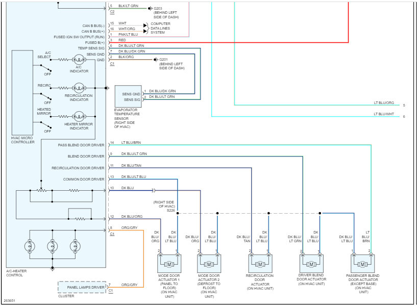

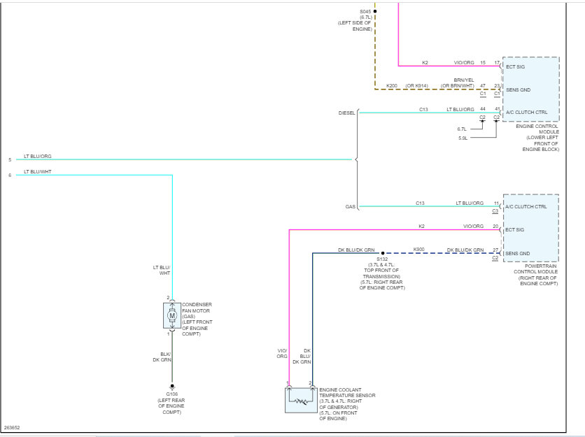

I attached the wiring schematic for the entire HVAC system. I'm assuming this is a full-size truck but need confirmation. They used the same engine in the Dakota.
Let me know. Also, the schematic below is two pages. I had to cut each one in half to make them readable for you. I did overlap them so you can follow from one to the next.
Let me know if this helps and if I got the correct model.
Aug 24, 2023 at 2:02 PM
