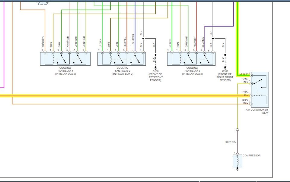

Hey all, so the A/C is just blowing hot air. I was going to recharge it and noticed the clutch not engaging at all. checked all fuses and relay first. all is good could not figure out why but if I take a piece of wire and jump it at the relay it works clutch engages blows cold air. changed out relay but still the same. any ideas?
Sep 4, 2019 at 9:06 AM

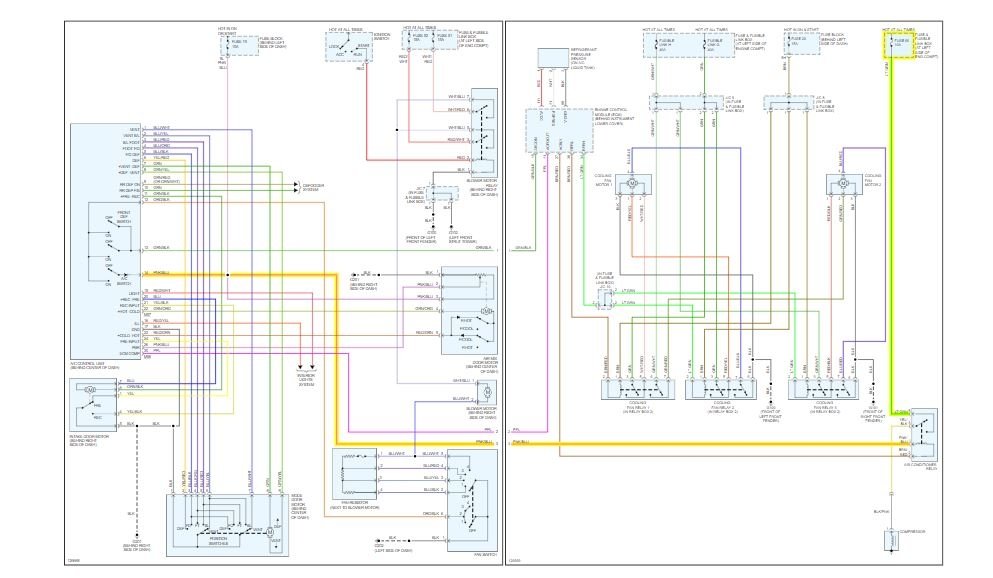

Good evening.
I attached a wiring diagram for you to view. With the key on, verify there are 2 powers to the relay.
Sep 4, 2019 at 9:20 AM
CISCO4512
  • 6 POSTS
I checked power i do have power at relay at 5 and 2 and nothing at 1 and 3.

Okay, the ECM is what grounds the control side of the relay to engage the compressor.

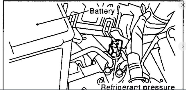

There is a pressure switch on the little line for the Freon. It has 3 wires. Test for 5 volts to the red wire with the sensor disconnected.

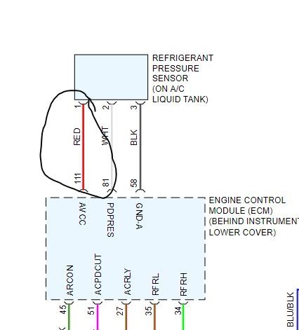

Okay, I just check the pressure switch I do have 5 volts at the red wire.
Sep 4, 2019 at 10:47 AM
Okay, is there another 5-volt wire as well?
Sep 4, 2019 at 10:51 AM
CISCO4512
  • 6 POSTS
I double checked that just now and nothing on the other two.
Sep 4, 2019 at 10:58 AM
The middle wire is the signal wire and should also have 5 volts. You may have a bad ECM.
Sep 4, 2019 at 11:10 AM
CISCO4512
  • 6 POSTS
How do I diagnose the ECM to know for sure? And thanks for all your help, much appreciated.
Sep 4, 2019 at 11:39 AM
The 5 volts comes from the ECM.
In my first response, I attached a wiring diagram. Follow the wire back to the ECM and see if there is power coming out at that pin.
Download the wiring diagram to your laptop and then enlarge it so you can see it better.
